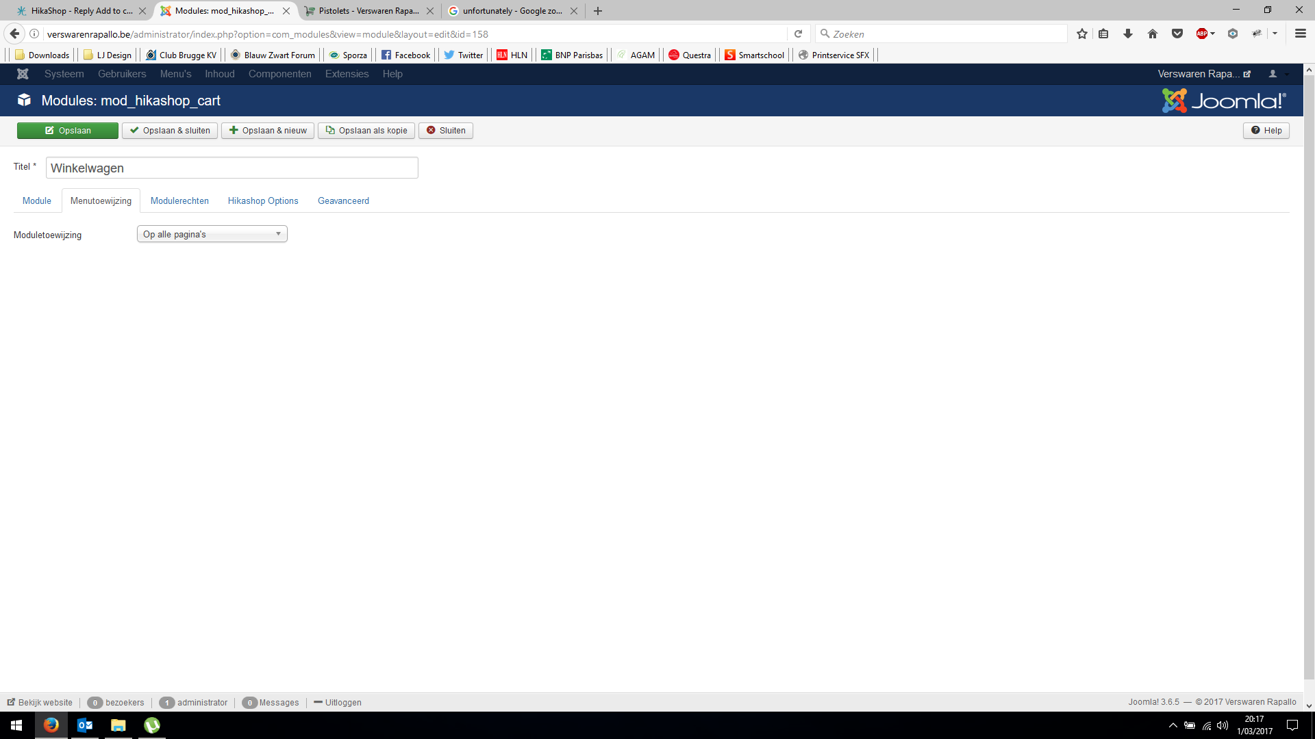

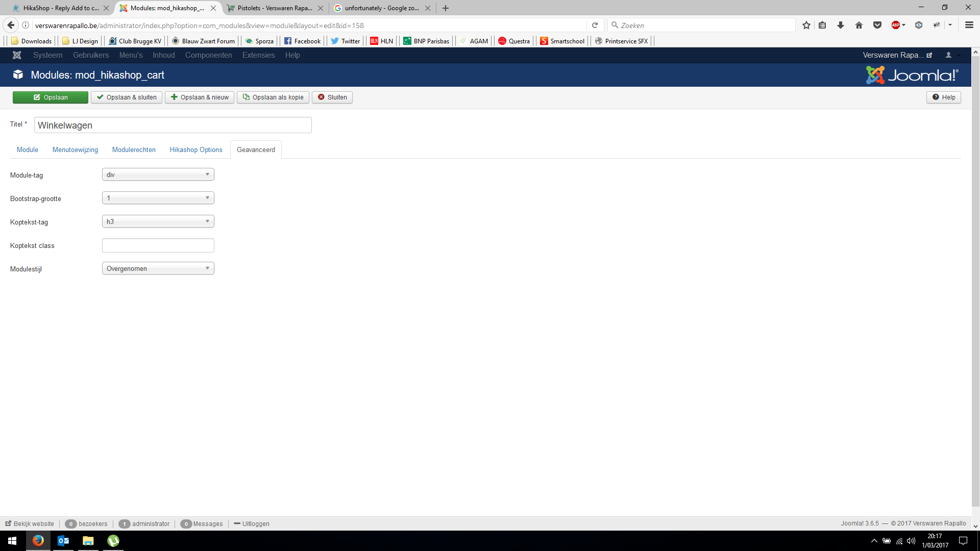

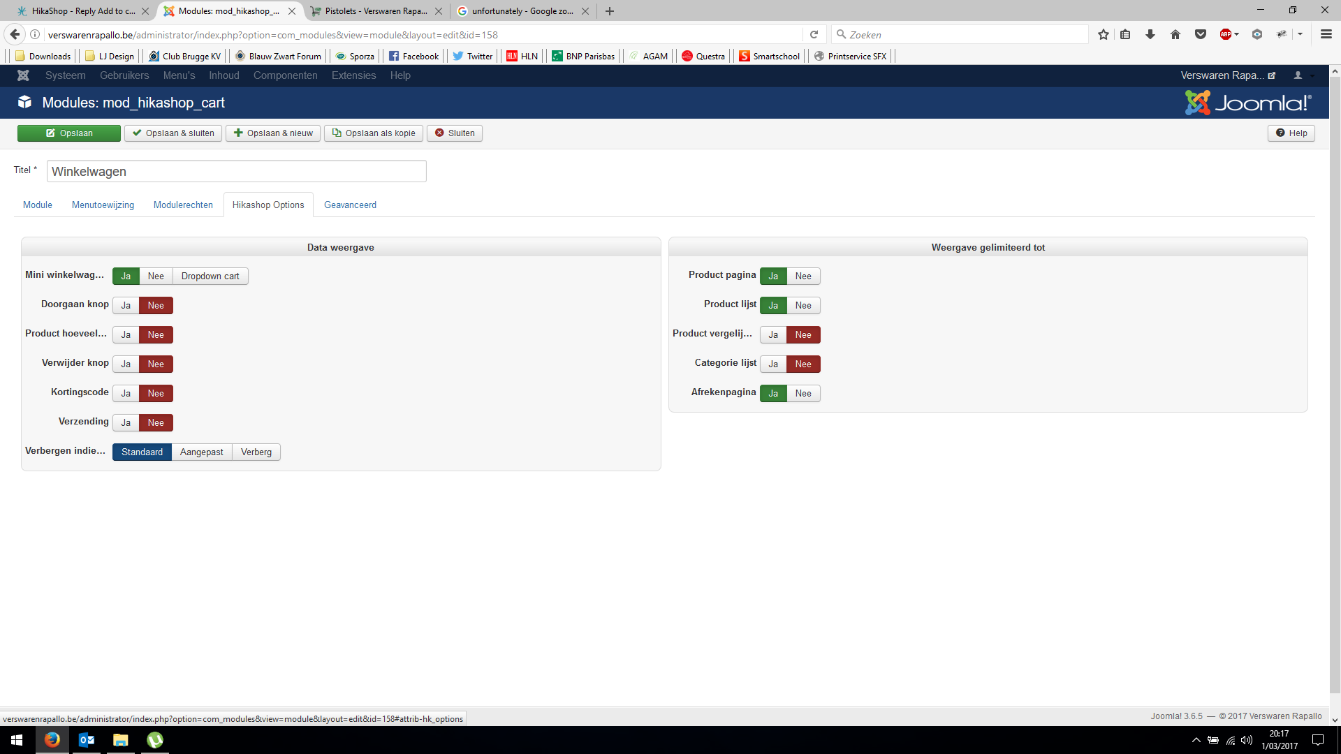

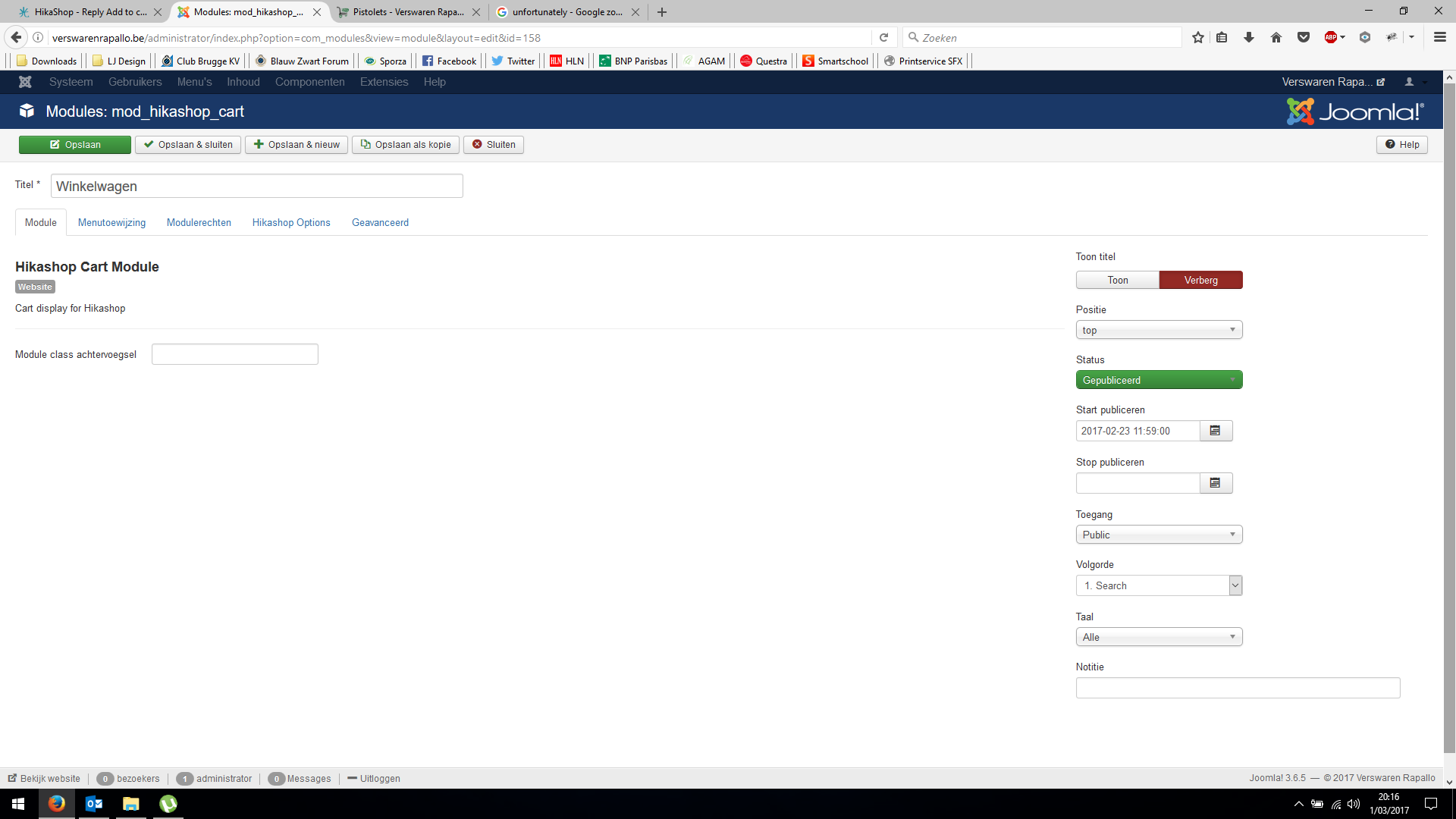

  • Posts: 21
9 years 4 months ago #263842
I deleted all the cache, unfortunately that didn't help :(
I hereby provide you some screenshots of the settings of the module.

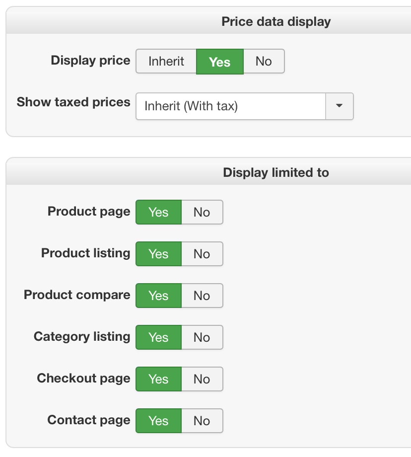

I took a quick look, in your module settings you have set your cart not to appear in category listings (see your third screenshot under "Weergave gelimiteerd tot"). And the link you gave in your first post is a category listing, that's why it doesn't show up.
So set "Categorie Lijst" to Yes and all should probably be well. Hope that helps.

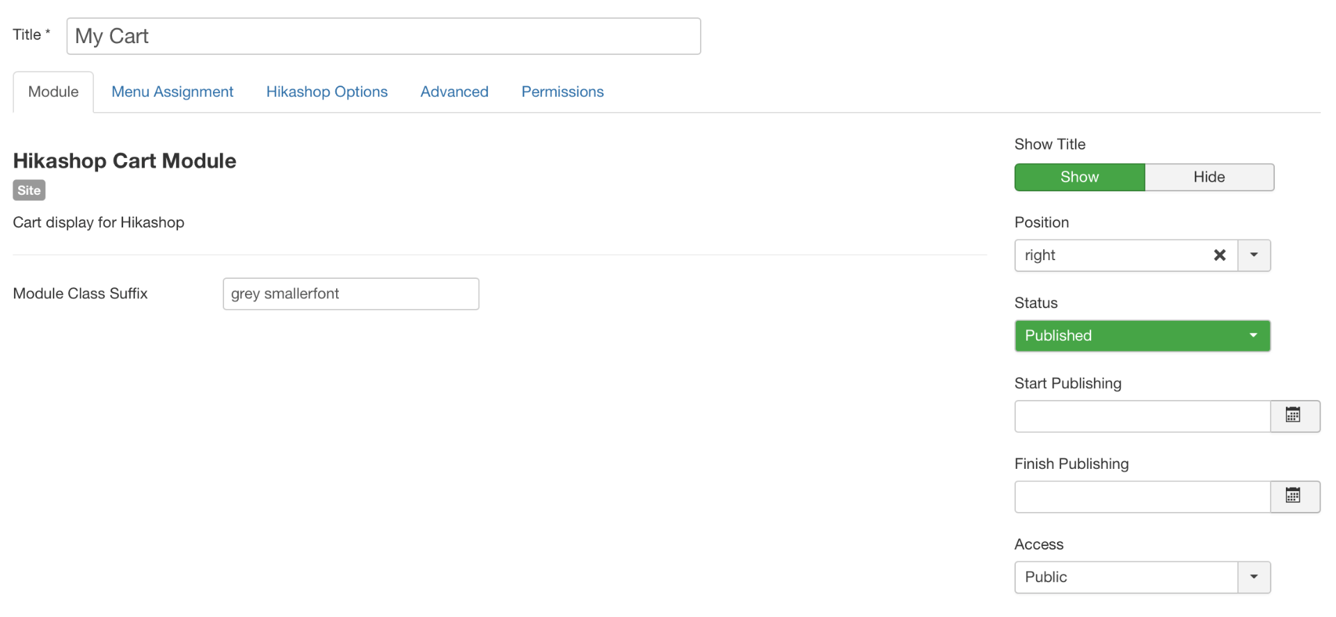

I seem to have a similar problem. The cart does not show on the product page.
I have enabled it in the module settings, see screenshot. Here is the website: ScarvesAustralia.com.au
Thank you
Last edit: 9 years 2 weeks ago by sarawhite. Reason: Forgot to mention website
  • Posts: 85796
  • Thank you received: 14091
9 years 2 weeks ago #272179
These are only some of the settings of the module.
The most important options for the display of the module are in the main tab where you can select the enable/disable setting, the position of the module and the access of the module.
Even if the module is enable and all its display settings are activated, if you configured the module to display in a position which isn't displayable by your Joomla template or if its access is not public, you won't see it.
So please check on that.
  • Posts: 44
9 years 2 weeks ago #272200
Hello Nicolas
The Cart module shows on all other pages just not on the PRODUCT PAGE.
It sits on a position which is visible (the other ones are showing see above)
Access is public
Please find a screenshot of the Main Tab settings: Here is the website to check
