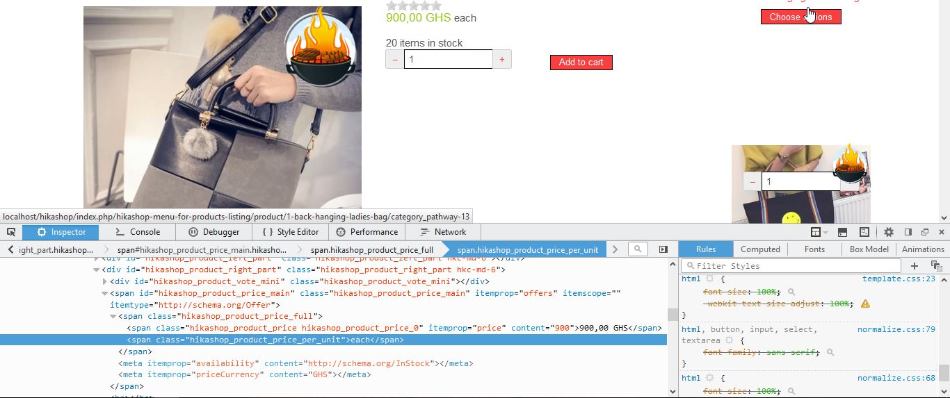

I find it quite difficult referring the various "div", "span" and dot tags when I inspect my page elements to that of the actual modules (Views) in "Display->Views".
Most important I would like to know when (under which circumstances) do I have to add a line of code to the CSS file to change a display property.
For instance (looking at the image attached), I want to remove "each" from the Product Price. My problem is HOW do I locate that module under DISPLAY --> VIEWS looking at the details from the Inspection elements?
I have read your documentation on CSS styling but my challenge is how to identify a particular module from the Inspection Elements.
  • Posts: 86101
  • Thank you received: 14202
9 years 5 months ago #265029
The second part of the documentation about "customizing the display" we have talks about what view is used for what part of the page:
So you should refer to that.
For example, this image www.hikashop.com/images/stories/Product_customization.jpg shows that the price is displayed by the file "listing_price" of the view "product". So that's where you'll find the each text.
However, you actually don't need to edit a view to remove it. You can just use a translation override if you want to change some text of the interface of HikaShop:
