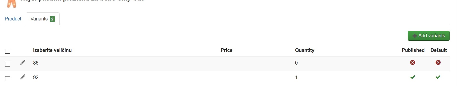

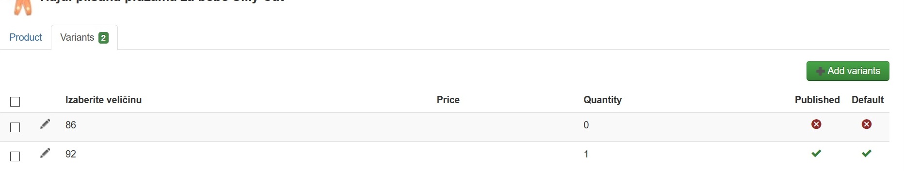

I have issue with unpublished variants. When I unpublish variants in backend it is still published in frontend. I attached screenshot, and u can check link I provided. As u can see, variant is unpublished but yet, it is displayed in frontend.

I have that option enabled cos I want products to be shown even if they are sold out. I just checked - even if variant have quantity higher then zero, and I unpublish it in backend, it is still getting displayed in front end.
In 2.6.4 version (out of stock is enabled too), If I unpublish variant it's now showed in front end. So unpublishing was working back then.
I didnt change product related options since 2.6.4 and I just tested for same product and it's working on that version.
I checked with default template and it's still displayed.
What I generaly need is, if one product have for example two variants and one of them is sold out, I need sold one to not be shown(product should be displayed no metter if both variants r sold out). Till now I did this manually, but I guess there is better solution for this.

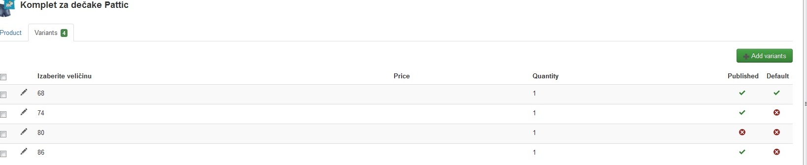

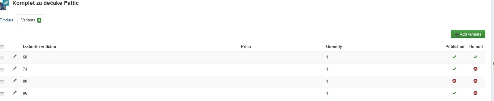

Seems like u read only first sentence.. It's not just about out of stock items, there is problem with items that I have on stock.
- I am manually unpublishing variant with quantity 1(check screenshot), it shouldnt be displayed in frontend, yet it is. You can check it on link:
bebili.rs/odeca-za-bebe-decake/komplet-za-decake-pattic
- Everything is working fine on 2.6.4, but on 3.0.1 it's not
And question: is there any solution for variants to be unpublish when they reach zero BUT with option "show out of stock" ON?
