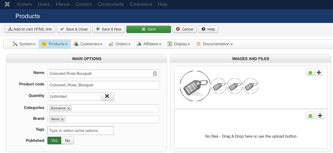

I can drag and drop the product image (or upload it).
It shows that it is uploading.
The image container turns green then...the image disappears.
No images show up in the image area.
BUT, if I save the Product and go into the product again, you can see all the ATTEMPTS I made in uploading the images -- these are represented by the 'default image' icon.
