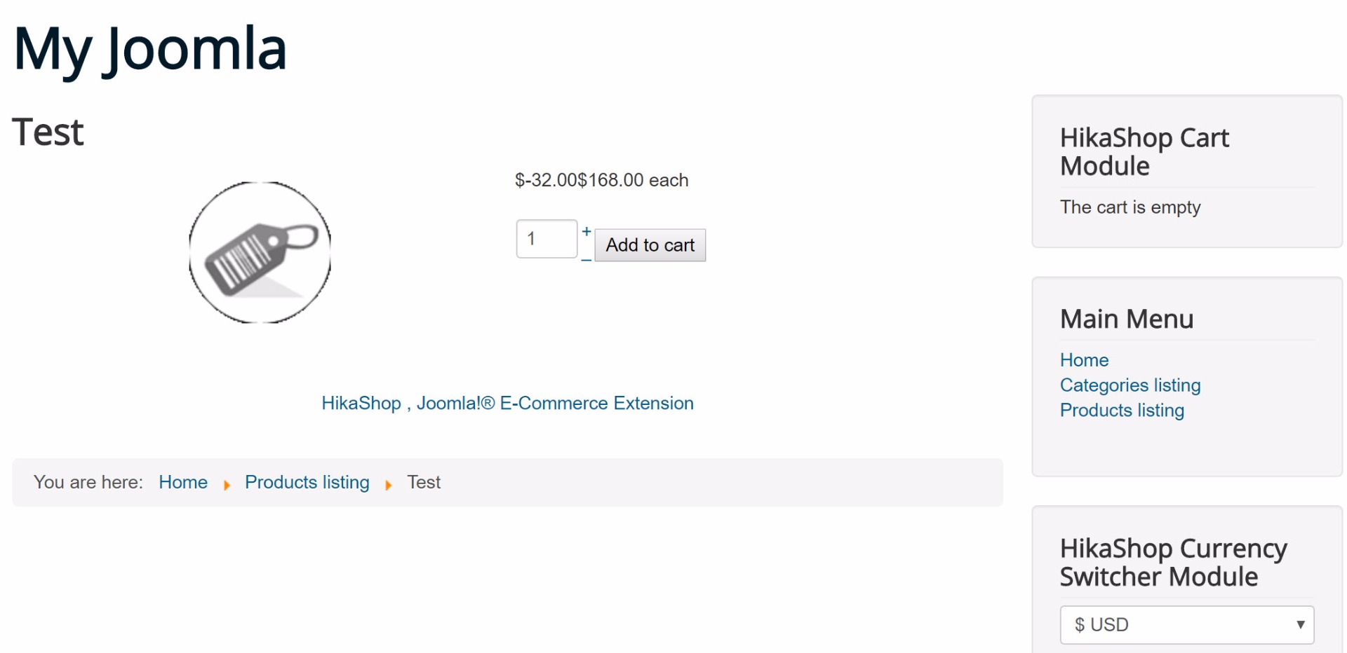

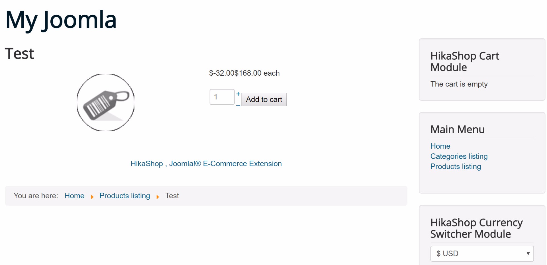

I have a product with the price of 200 $, then created a discount of 20$, why does the product display as $-32.00$168.00 and not $-20.00$180.00
See pics.

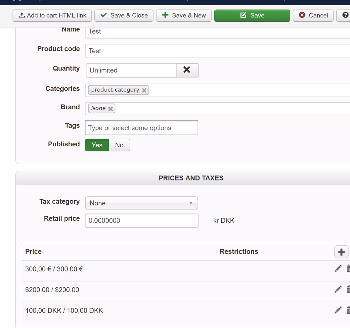

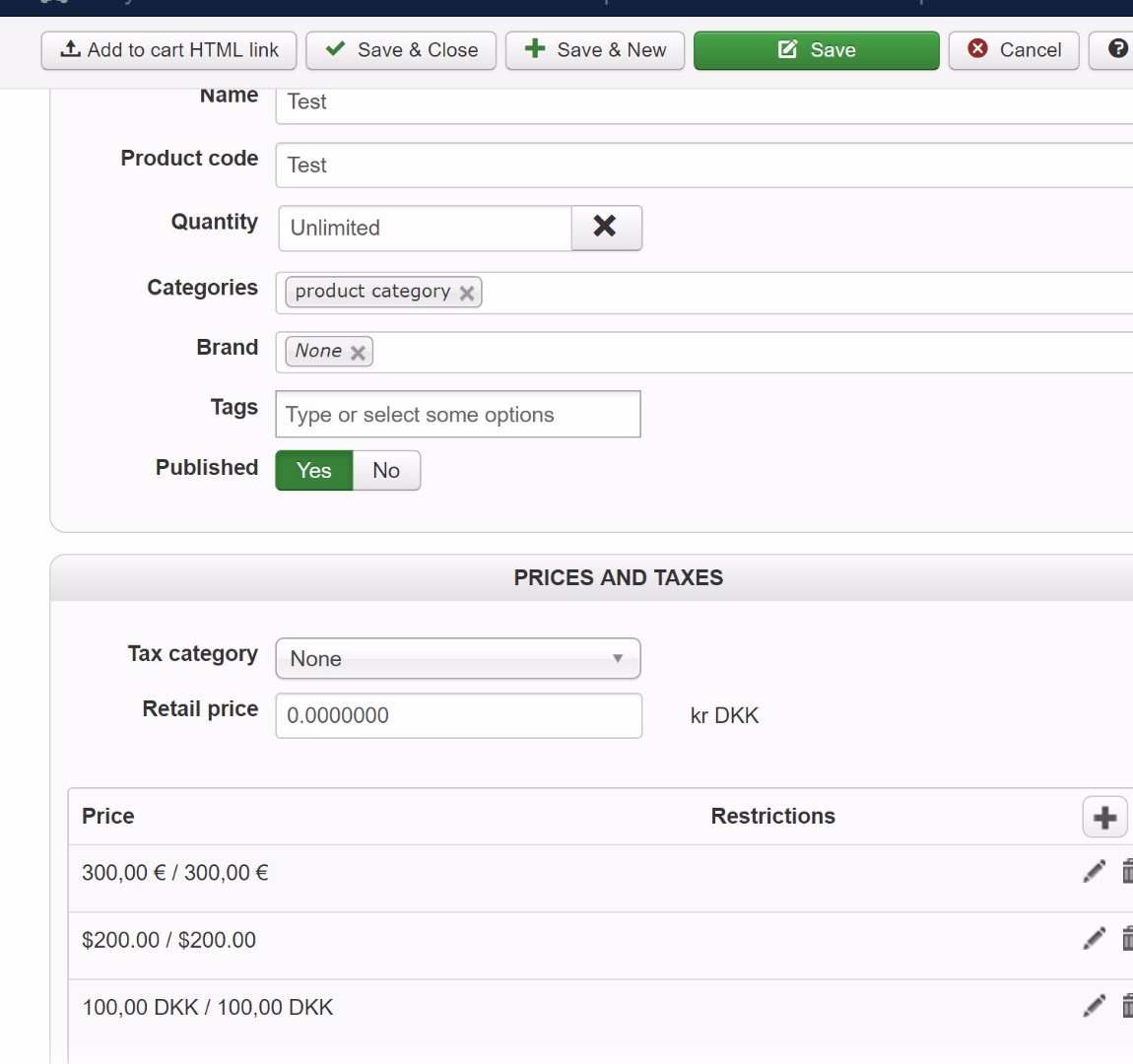

I have this price on my test product
100 dkk
200 usd
300 eur

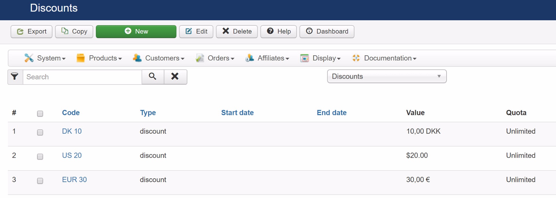

And then this discount
10 DKK
20 usd
30 eur
The product display is discount/price
-10/90 DKK
-32/168 usd
-30/270 eur
I agree on the dkk and Eur but expect to see -20/180 usd.
So please tell me how to display the correct display/price for usd... not where to do it.... but exactly how to do it...

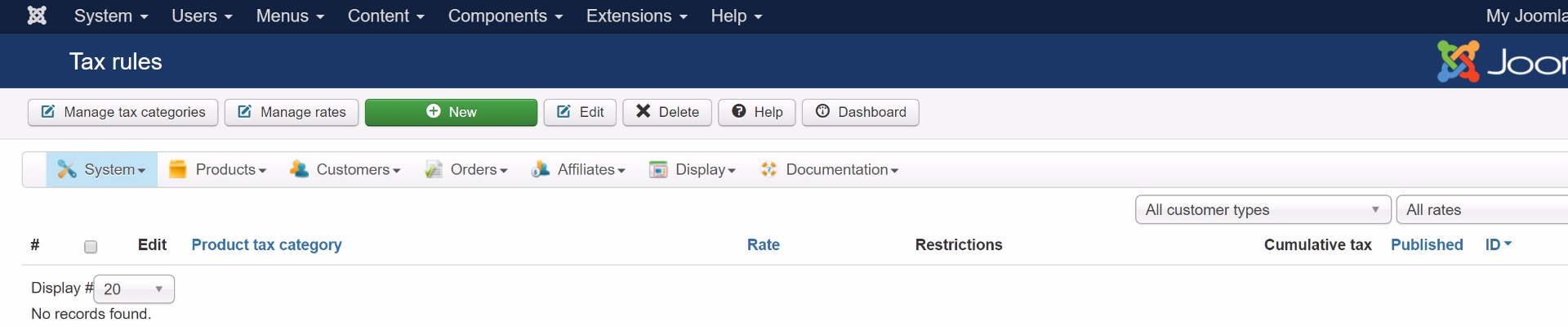

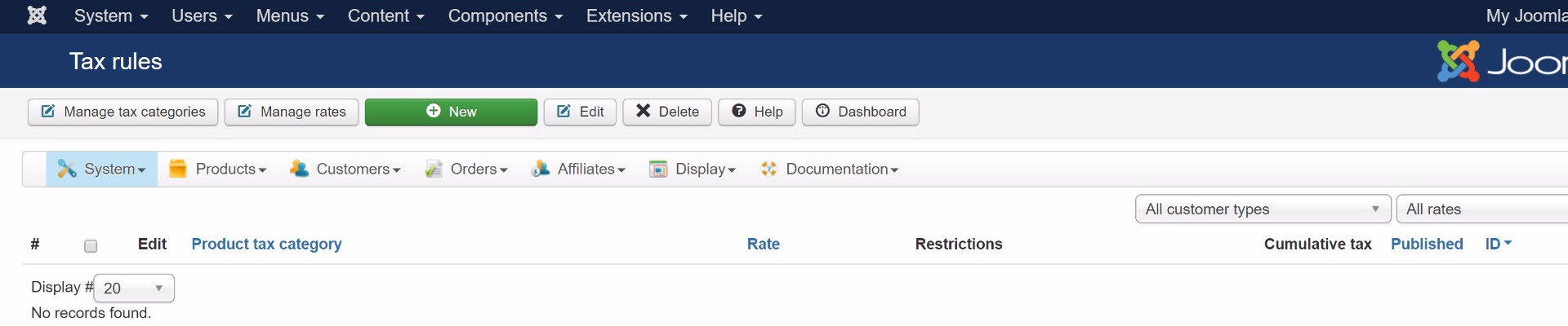

  • Posts: 31
9 years 4 months ago #267080
On the first post you can see that there is a discount on the product, but the wrong discount, so "apply discounts" setting must have been on all of the time right?
There are no tax rules defined, see attachment.

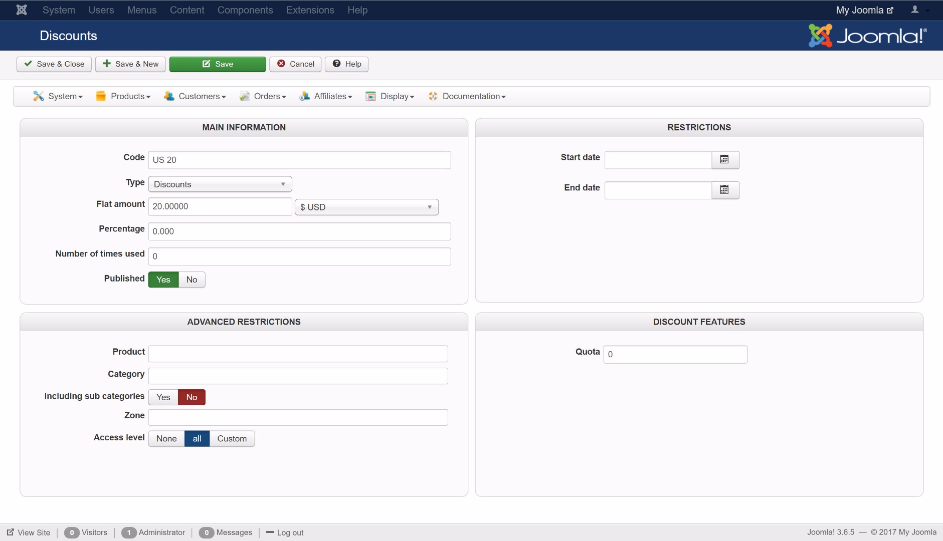

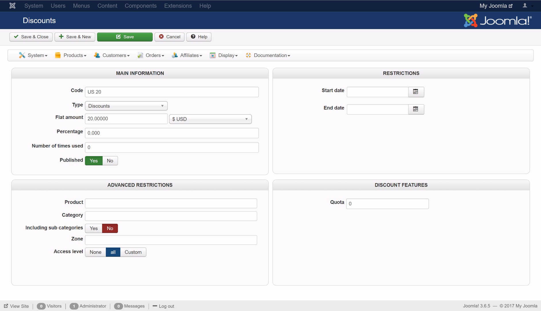

9 years 4 months ago #267159
Your issue is strange, can you provide a screenshot of your discount configuration page, like this :
Awaiting news from you.
Last edit: 9 years 4 months ago by Philip.

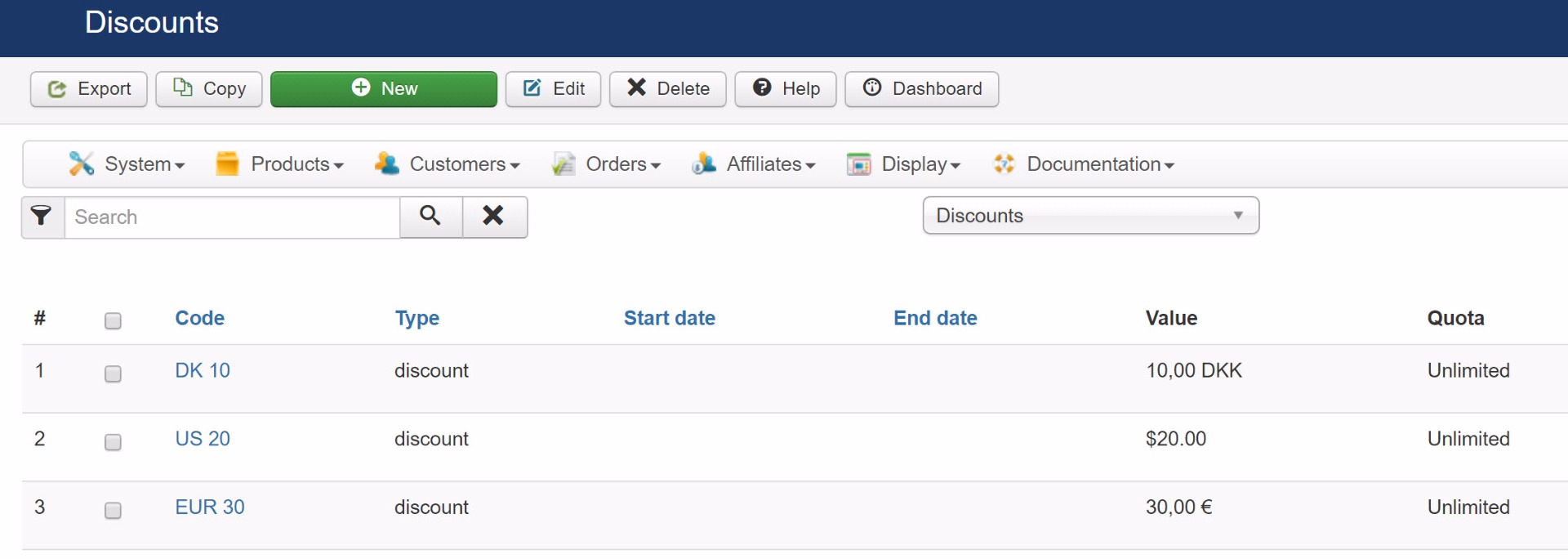

  • Posts: 31
9 years 4 months ago #267186
Here you go.....
  • Posts: 86100
  • Thank you received: 14202
9 years 4 months ago #267242
Ok, now I get it.
The thing is that you have several discounts applying to the prices.
Here is how the system works:
The system load the prices of the product and take the price in the current currency. If none is available, it takes another one and convert it to the current currency.
Then, it loads all the discounts applying to the product. It then converts them all to the current currency and pick the most interesting one and apply it to the price of the product.
So since you have one discount per currency, the system will actually always pick the one which offers the most important discount when you convert them to the current currency.
I suppose that you expected that it would pick the discount of the current currency and discard the others instead which is why you have a result you didn't expect.
If you disable the other disounts and leave only the discount of the current currency, then you should always have the result you expect.
Frankly, we didn't thought of that so far. Most merchants uses percentages, or directly set the prices they want in the products, and when they don't, they usually use only one currency.
I suppose that you think that it would make sense to have the system works for the discounts like it does for the prices and first pick the discounts of the current currency before checking the others.
I kind of agree with you on that.
I've added a patch for that.
Download the install package again on our website and install it on yours and that will add the patch.
