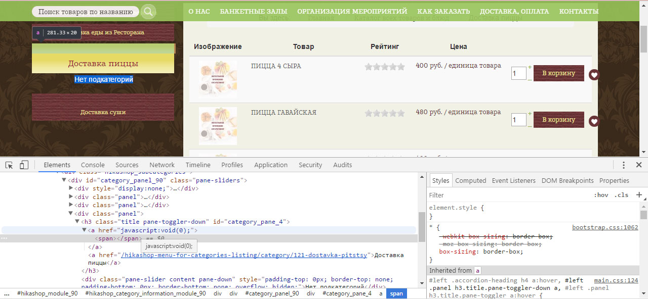

Hello!
When I created a single category of my shop (without subcategories on the second level) I found a strange behavior of accordion. Items without subcategories displayed with an empty tag <a><span></span></a> on the top. And in the bottom part of such items appeares words "No subcategories here". I can't find were I can switch off this feature. Help me please!
Regards!
Olga
9 years 4 months ago #268007
I would recommend you to use the setting " Display in simplelist (ul/li)" if you don't want HikaShop to use the Joomla "jpane" system.
  • Posts: 45
9 years 4 months ago #268047
Hello, Jerome!
I tried to change my settings as You recommended. Accordion doesn't work with this setting( Now I want to try to change some css rules... maybe it will help
Thank You for Your advice
Regards, Olga
  • Posts: 37
8 years 5 months ago #290213
I have the same problem with the use of the accordion category menu. In reality all categories are not so deep (subcategories) ...
I replaced :
HIKA_LISTING_LIST_EMPTY="No subcategories"
by
HIKA_LISTING_LIST_EMPTY=""
… in the language file. This solves the problem.
Jerome, Is this solution risky for the operating of HikaShop?
  • Posts: 86098
  • Thank you received: 14200
8 years 5 months ago #290238
No, there is no problem in doing that.
