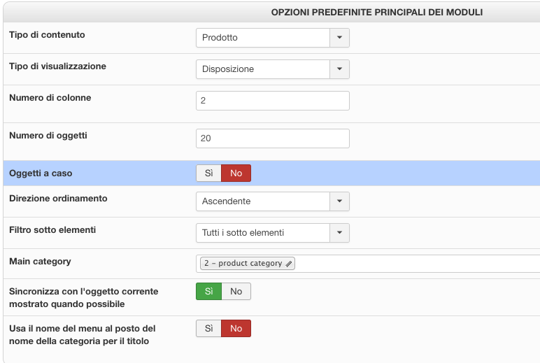

Here is the screenshot of system>display>modules main default options>random items ( "oggetti a caso" into Italian is set to NO)

9 years 3 months ago #270992
Please provide a screenshot of all the settings under the "products options" tab of your menu item.
Also, please do the screenshot while logged in in English as we don't speak Italian.
And make sure that you're prodiving a screenshot of the settings of the correct menu item.
On the page www.puntobenesseresrl.it/elenco-prodotti.html it's the menu item with the id 279 which is used so make sure that you check the settings of that menu item via the Joomla menu manager.

Thank you so much Nicolas, your request to me was enough to let me know where I was wrong and why you are right
Random view was YES into menu item 279 (Elenco Prodotti= Hikashop Product Listing), now everything is fine
I did not think of the menu item but only the system> display> modules main default options> random items
