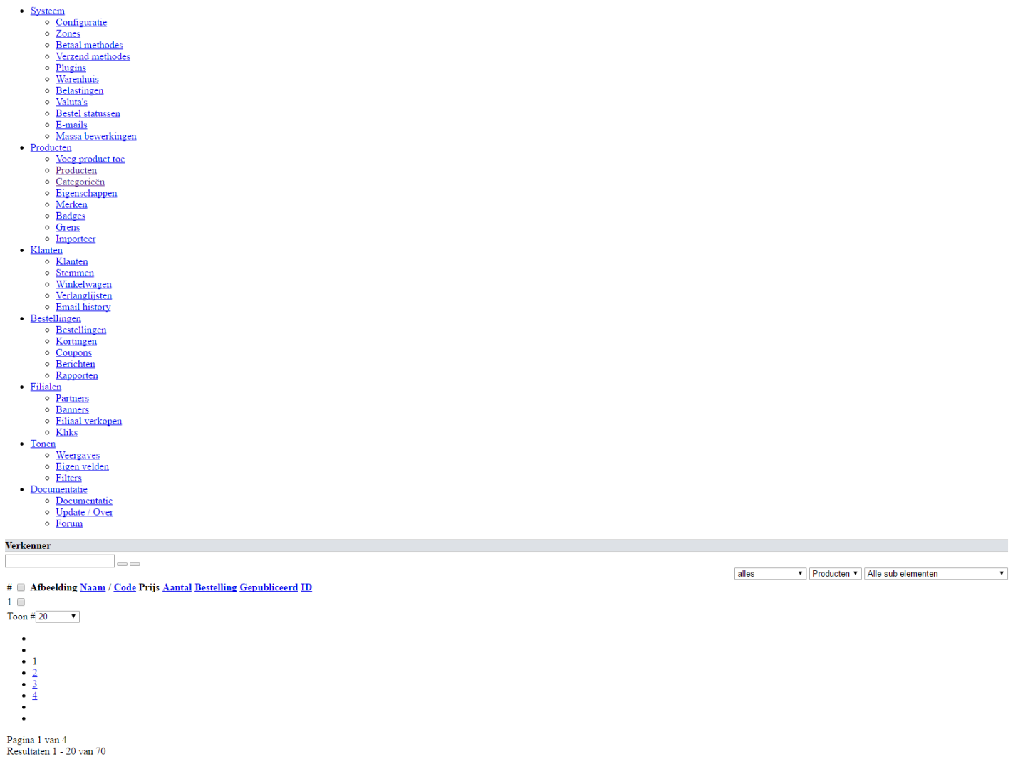

When I try to open the product- or category view I got a layout without any design and I miss the Joomla-template. Do you know what is wrong?
See my screenshot.
Joost
