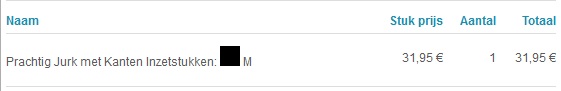

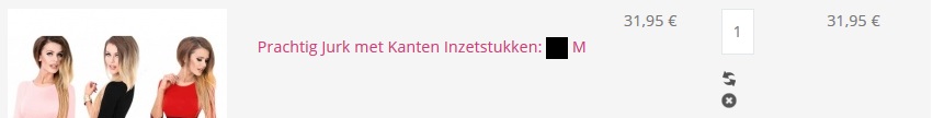

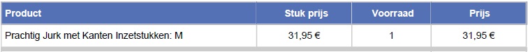

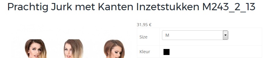

Hi.
I have not noticed before that the code shows up on the product page, but does not appear on the order, in email, or in invoice.
