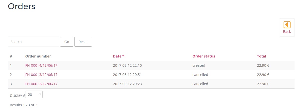

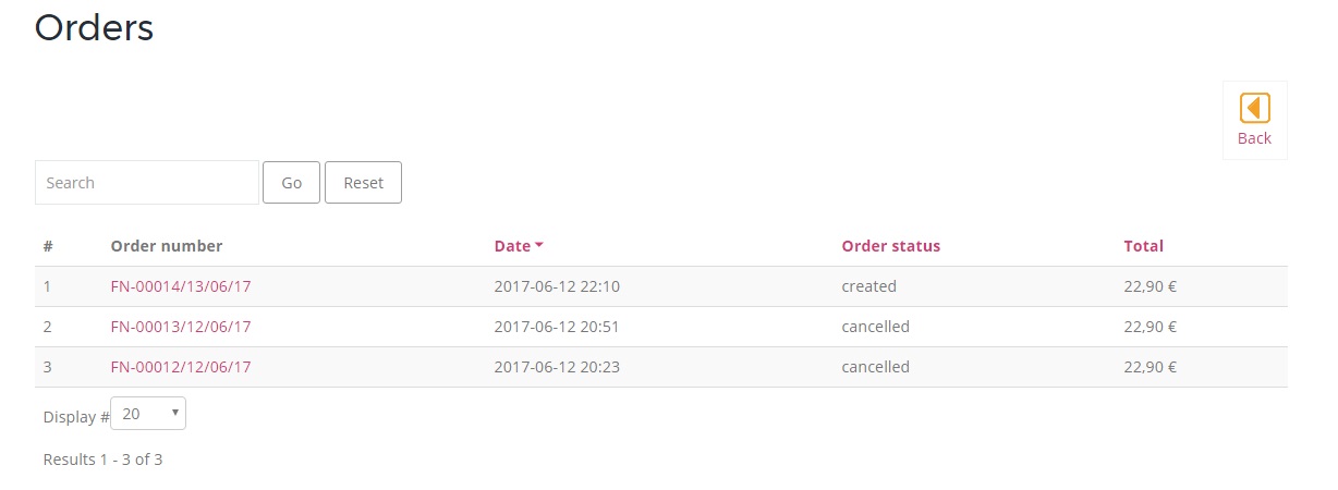

The order status change from "created" to "cancelled" automatically when I cancelled payment.
Order status now has default settings, I have tried different combinations, but I probably do something wrong

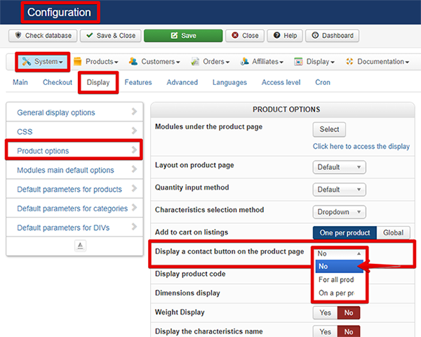

How did you configure the "Update the product stock on confirmed status" setting in the HikaShop configuration ?
And which payment methods are you using ?
  • Posts: 54
9 years 2 months ago #271702
Hi.
"Update the product stock on confirmed status" - is set to "no". Of course, I also checked how it works with the "yes" option and if the payment is confirmed, update the item in stock and update order status is correct.

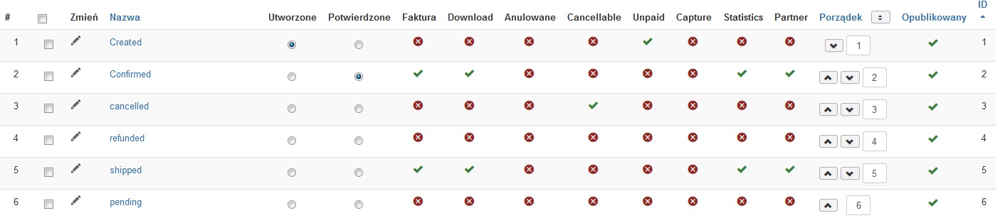

9 years 2 months ago #271992

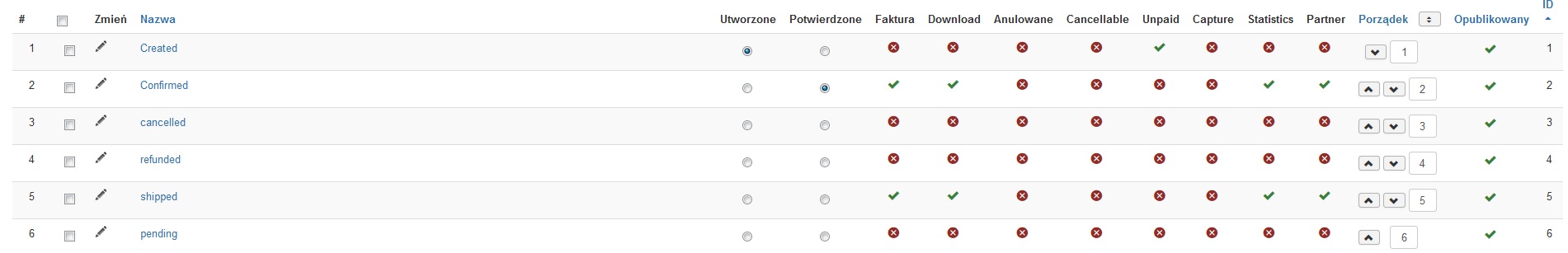

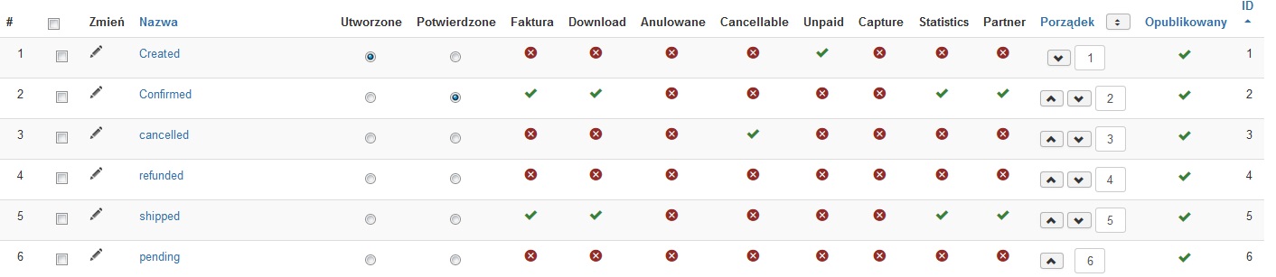

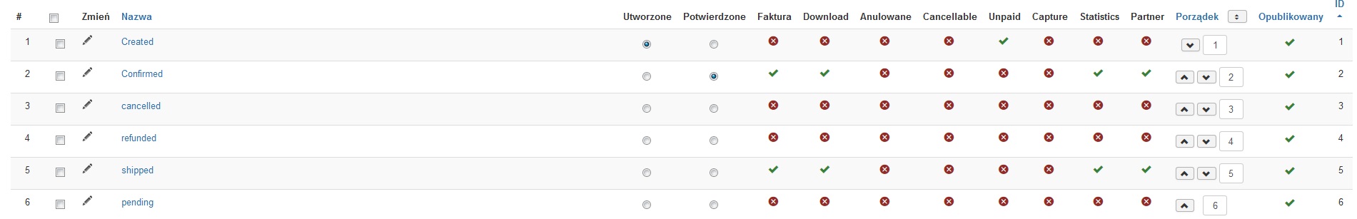

1 - You should configured your "cancelled" orders statuses (it's "Anulowane" for your language).
Best is to set "cancelled" and "refunded" in that list.
2 - How are you cancelling the orders exactly ?
3 - The "pay later" include some checks ; but we generally recommend to "destock" the product at the order creation and afterwards use the cron plugin to cancel orders after a period of time.
4 - When you finish the checkout the payment method "end" page is displayed and it's the plugin which handle the redirection.
You should see with the iDeal support for more details. Afterwards if you're using the HikaShop Paypal plugin, it should work fine.
  • Posts: 54
9 years 2 months ago #272003

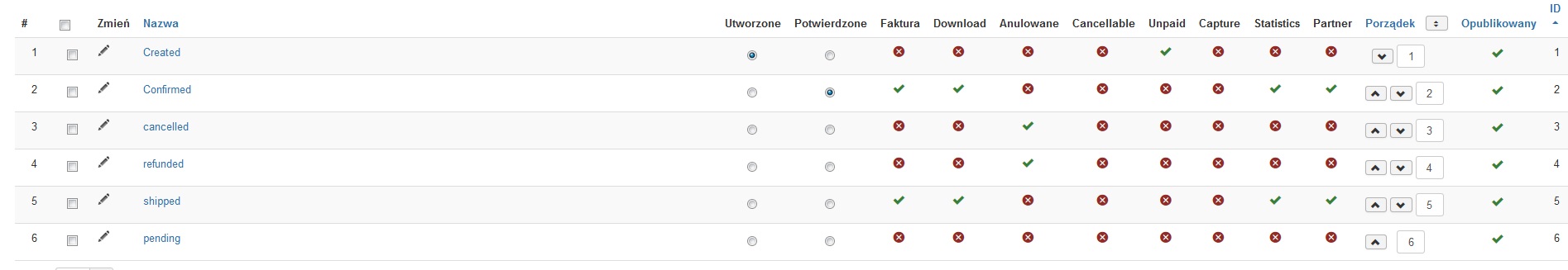

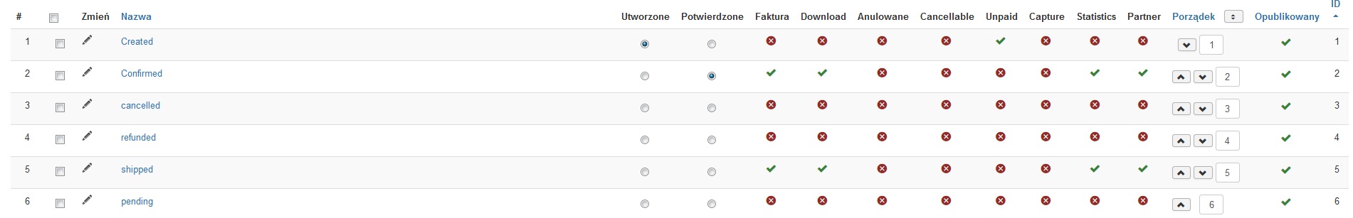

1. Ok. But after 15 minutes the statuses returns to its original settings (they become disabled).

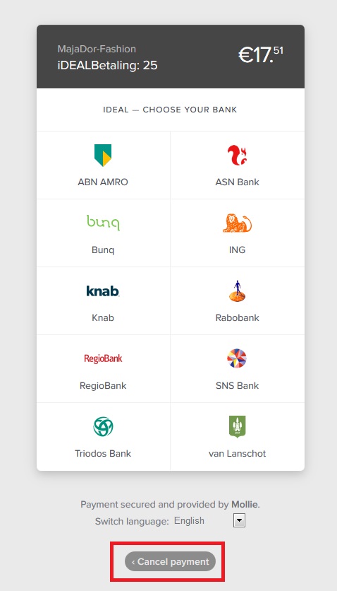

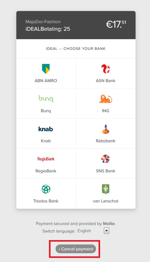

2. I Use the button "cancel payment" at the bottom of the page for IDEAL. The order status change from created to cancelled on backend hikashop propertly, but product does not come back to stock.
3. When I don’t use the button "cancel payment" and don’t pay also, the cron plugin change the status from created to cancelled after 15 minutes properly, but the product does not come back to stock. When I change the status manually from created to cancelled on backend hikashop product returns correctly to the stock.

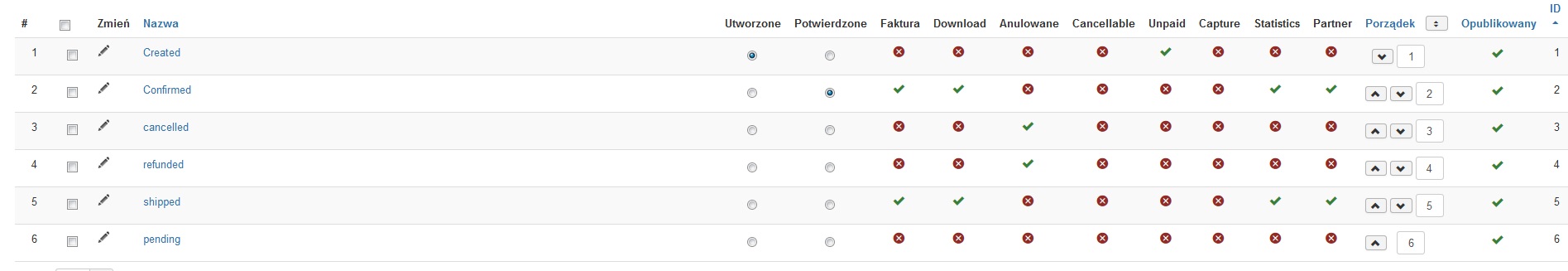

  • Posts: 54
9 years 2 months ago #273259
Hi.
Two days ago I sent you a mail with data to my site, where I asked you to check why the order statuses deactivated themselves?
but I can't. When customer cancelled order, order statuses return to the initial settings (att) and product does not return to stock. Can you help me with that?

9 years 2 months ago #273312
For the "automatic" cancelling, I guess that maybe it's a feature of IDeal plugin, but can't be sure of it because this plugin wasn't develop by ourself, maybe you have to ask to this plugin creator ?
For the second point, the product will be return in stock only if as said previous you configure your order statuses (Refunded or Cancelled).
