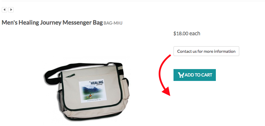

How can I move the "contact us for more information" button on a product page down below the "add to cart" button? I tried adjusting the product > show_defaut, but it didn't work. Am I looking in the right place?

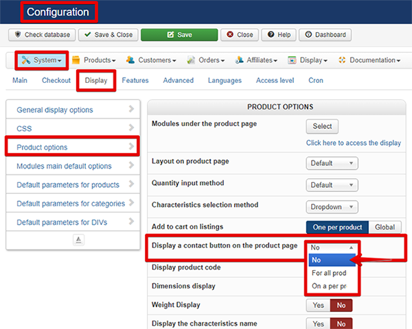

You have an option in your HikaShop Main Configuration, in Components => HikaShop => Configuration, then in Display tab go in Products options part, you have this :
Switch the Display a contact button on the product page option to No.

I don't want to remove the contact button, just move it down below the add to cart button. See attached screen shot.

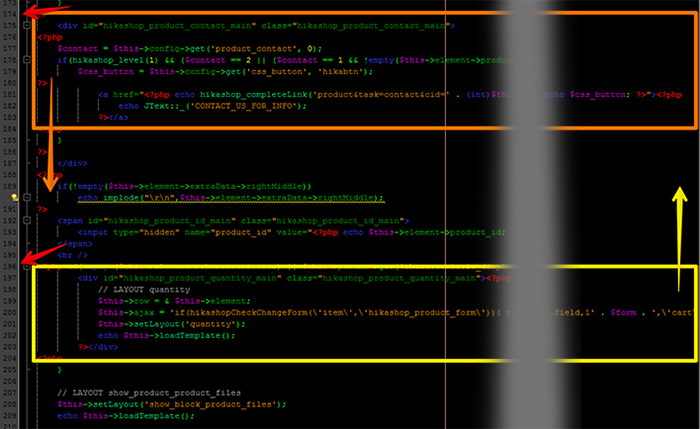

You are in the good view if you use the default view, and so you have to invert the "block"
<div id="hikashop_product_quantity_main" class="hikashop_product_quantity_main"><?php
			// LAYOUT quantity
			$this->row =& $this->element;
			$this->ajax = 'if(hikashopCheckChangeForm(\'item\',\'hikashop_product_form\')){ return hikashopModifyQuantity(\'' . (int)$this->element->product_id . '\',field,1' . $form . ',\'cart\'); } else { return false; }';
			$this->setLayout('quantity');
			echo $this->loadTemplate();
		?></div>
With this one :
<div id="hikashop_product_contact_main" class="hikashop_product_contact_main"><?php
	$contact = (int)$this->config->get('product_contact', 0);
	if(hikashop_level(1) && ($contact == 2 || ($contact == 1 && !empty($this->element->product_contact)))) {
		$css_button = $this->config->get('css_button', 'hikabtn');
			<a href="<?php echo hikashop_completeLink('product&task=contact&cid=' . (int)$this->element->product_id . $this->url_itemid); ?>" class="<?php echo $css_button; ?>"><?php
				echo JText::_('CONTACT_US_FOR_INFO');
			?></a>
<?php
		</div>
Hope this will fit your needs.

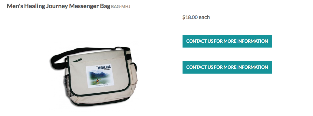

Thank you for the help, Philip. I found that I am not using the default view. I'm using the tabular view for products. So I found that same location in the show_tabular view and replaced it with your code. I'm not sure if it needs to be adjusted for that view, but now my add to cart button has been replaced with another contact button. See screen shot.
9 years 2 months ago #273507
Here you have replace one block the add to cart block :
			// LAYOUT quantity
		?></div>
By this one, the contact form button, and of course you have 2 times the same block :
			?></a>
<?php
		</div>
I said you have to invert or swap or switch up, have a look on this screenshot :
Hope this will be more clear.
Last edit: 9 years 2 months ago by Philip.
  • Posts: 109
9 years 2 months ago #273541
