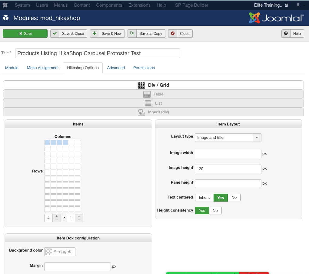

  • Posts: 6
4 years 10 months ago #335016
Hi, I'd be grateful if you could help with the same issue:
I'm trying to recreate the second Hikashop carousel option as shown on demo.hikashop.com/index.php/en/hikashop/...display-with-effects , although with just one row.
I can get it to autoslide (like the first option), but I don't want this, and either way, the left/right arrows don't appear, hence the user can't flick through the products themselves, which suggests it's not responsive?
Under > HikaShop > Configuration > Advanced, I changed “Legacy Settings” of “Carousel Legacy” to No.
I'm testing this in Joomla's default Template "protostar" - see dev.elitetraining.co.uk/product-listing
In our preferred "Helix Ultimate" template, it's even worse - see dev.elitetraining.co.uk/crime-squad-business-game where the title can't be seen under the image and they link through to Components rather than Product Listings?

  • Posts: 6
4 years 10 months ago #335047

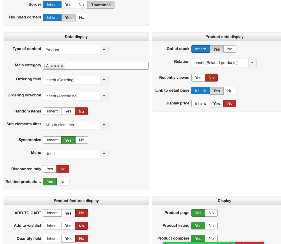

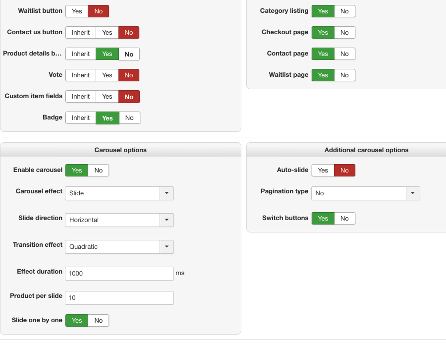

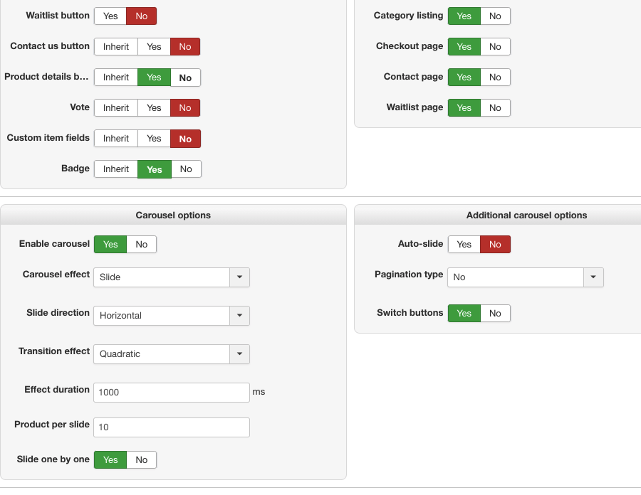

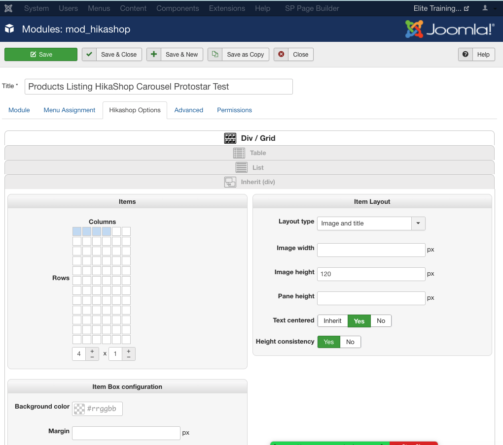

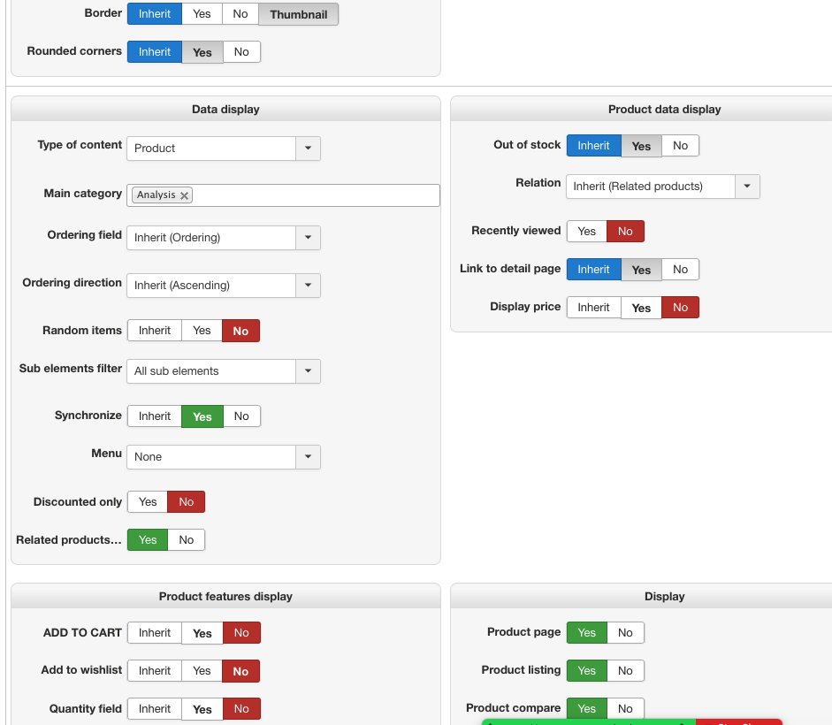

On the product-listing webpage, the carousel are the four images - they're just not scrolling to look like a carousel, which is the issue we'd like help with. For this module, I attach screenprints. This webpage is using the standard Joomla template and is displaying/linking better, just not working! Let me know if it would be helpful to have screenprints for the other webpage module too (which is using our preferred template and currently displaying worse).

  • Posts: 85796
  • Thank you received: 14091
4 years 10 months ago #335053
Here is what I can see on the "product-listing" page:
i.imgur.com/LrK1EgI.png
However, looking at your screenshots I see why.
You need to turn off the "synchronize" and the "related products..." settings in the module. Otherwise, you're only showing the products related to products in your cart.
Regarding the carousel settings, you configured the module to load 4 products in the module, and to have 10 products per slide.
So that's why there is no carousel effect since there are less products than visible products, there is nothing to move.
I would recommend to set 4 in the "products per slide" setting. And then increase the number of rows to have something like 3 rows * 4 columns.

  • Posts: 6
4 years 10 months ago #335056
Thanks Nicolas.
What settings do I use to:
* display left/right arrows either side, instead of dots or Previous/Next Buttons underneath (I couldn't find options under/near Pagination)?

  • Posts: 85796
4 years 10 months ago #335061
1. There is no option to display left/right arrows instead of the previous / next buttons. However, it's possible with a bit of CSS and translation overrides to convert these previous/next buttons into left / right arrows : www.hikashop.com/forum/product-category-...module-carousel.html
