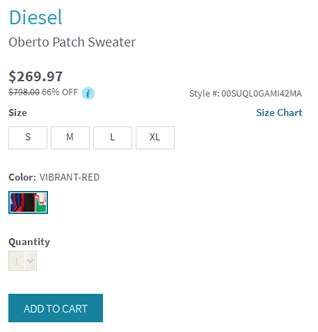

  • Posts: 966
  • Thank you received: 11
8 years 9 months ago #278971
I'm having the same issue too and I agree that the solution is too cumbersome - there must be an easier way to accomplish this. When adding items to the site it takes a lot of time so it would be great to make this easier.
I don't want to have to worry each time an order comes if the customer choose the correct item or not :(
There is a site that I visited where the quantity box is greyed out until you select a size then the quantity becomes available and you can add to cart. If you click on "Add to Cart" before clicking on a size it prompts you to choose a size. This would be very helpful because it forces the customer to click on a size before proceeding.
See screenshot.

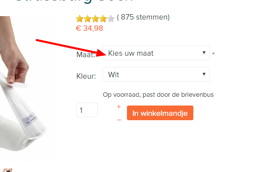

  • Posts: 135
8 years 9 months ago #279003
I just had a quick look at the Hikashop showcase at www.hikashop.com/showcase.html . I see a number of shops that seem to have accomplished what I wish:
workscene.com.au/fxd-wp-4-cuffed-stretch-pant.html
www.lacestamagica.com/boutique-del-bebe/...a-bebe/dou-dou-osito
Apparently they seem to be able to accomplish it. Can you guide me in a direction so that I can achieve this too?

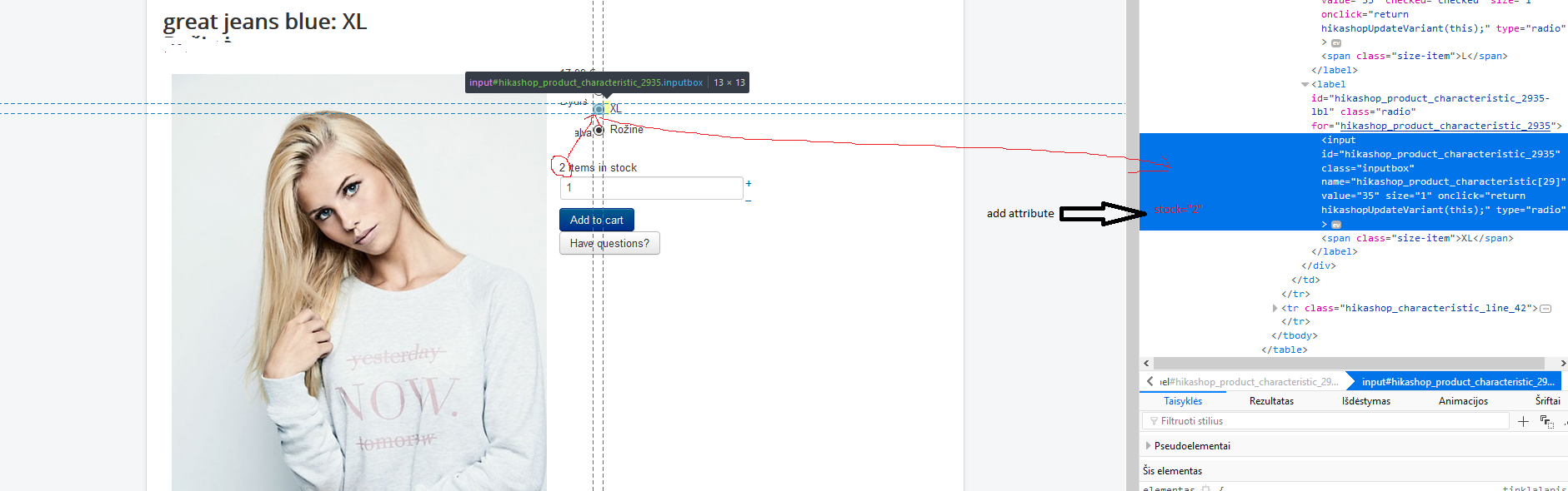

8 years 8 months ago #280033
Would it be possible to add stock count attribute to variant input method? So it would like this:
<input name="hikashop_product_characteristic[29]" id="hikashop_product_characteristic_2933" value="33" [b]stock="0"[/b] class="inputbox" size="1" onclick="return hikashopUpdateVariant(this);" type="radio">
Stock attribute should show selected variant stock amount. This would allow to add simple js on load to select next variant which has stock.
Kind Regards
  • Posts: 26365
  • Thank you received: 4069
8 years 8 months ago #280034
I'm sorry but I don't understand what you want to do.
You can't add parameters like that in HTML content. There are rules and specifications (RFC) for HTML.
  • Posts: 1119
  • Thank you received: 114
8 years 8 months ago #280082
Sorry, maybe i wasn't clear enough. I also tried to highlight attribute in code tag those it added this "b" tags....
I suggest to add stock attribute by default to hikashop for variant inputs. This would allow to add js if condition based on stock.
I think this little improvement for variant selection would allow some more modifications....
I have attached screenshot. I hope you see my point.
Kind Regards
Last edit: 8 years 8 months ago by kyratn.
  • Posts: 26365
8 years 8 months ago #280084
Yes ; it does not change what I was telling you in my message.
You can't add a "stock" attribute ; it's not compatible with the RFC !
At least, you can see to have a "data" attribute like we're doing for the add to cart buttons ; so something like " data-stock ".
