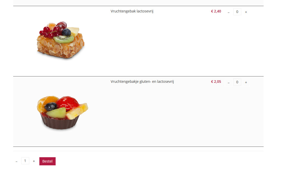

In Hikashop 2.6 i've had this page: www.banketbakkerijdevlaam.nl/bestelgebak
I added to this page:
if(in_array($this->element->category_id,array('197'))) {
    $this->config->set('show_quantity_field',2);
And it worked fine.
Now i have updated to Hikashop 3.2.0, removed the old overrides and created new ones.
Next to the add to cart button is also a quantity i don't want (see attachment) and the button doesn't seem to work.
Can you tell me how to fix this?
Thanks in advance
Jeroen

Did you try changing the "add to cart legacy" setting of the HikaShop configuration ?
That might help.
Also, for the display of the quantity, you now have a "quantity input method" to configure how the quantity field displays.
