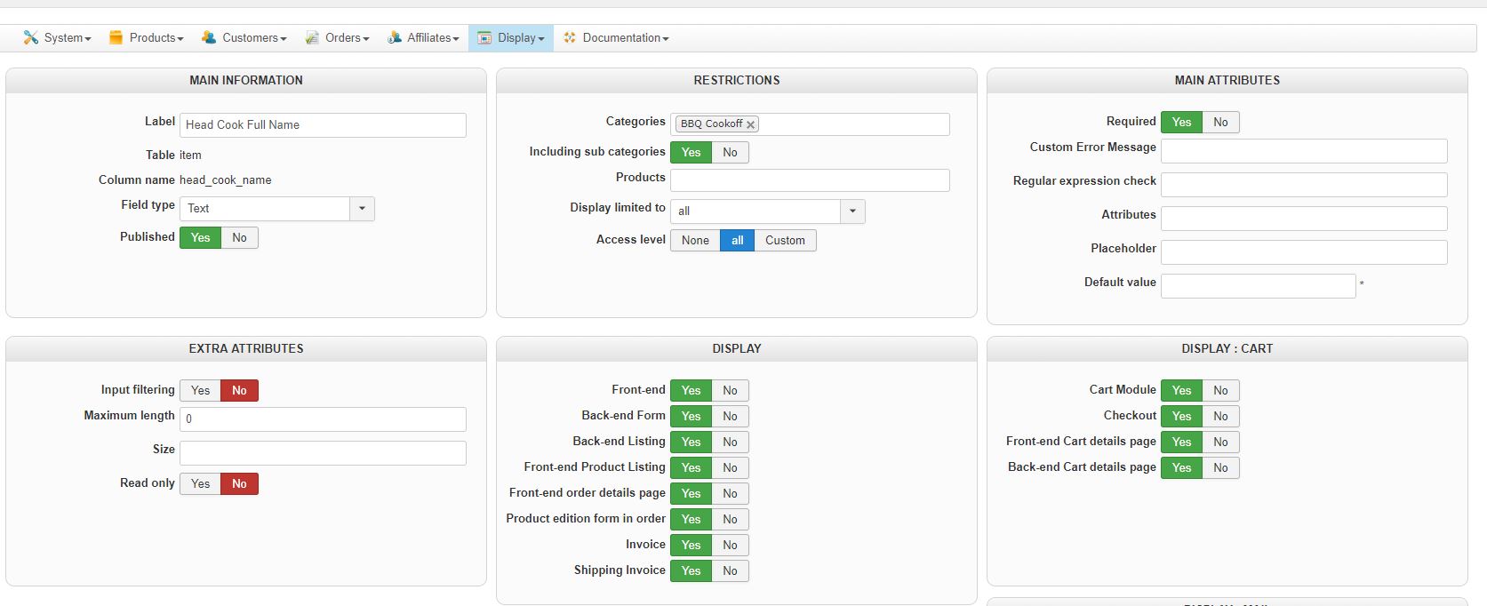

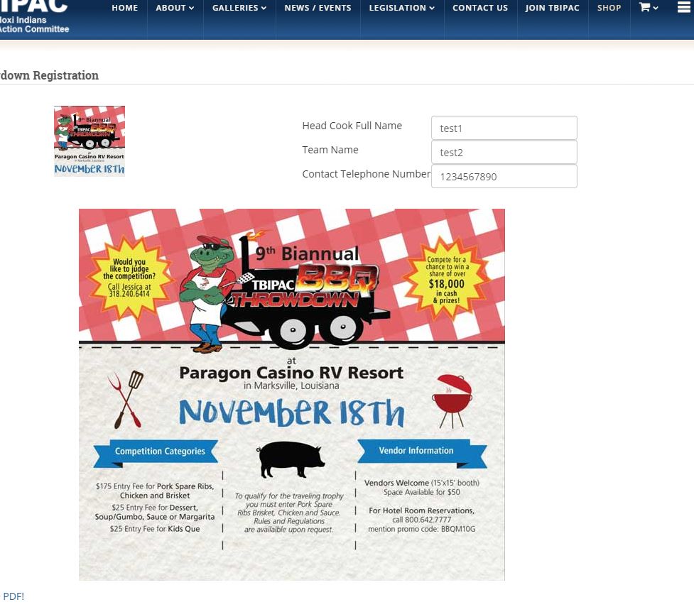

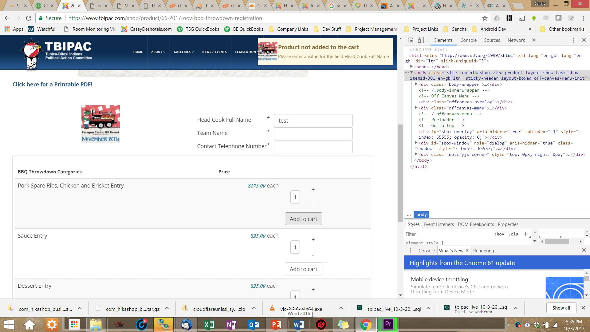

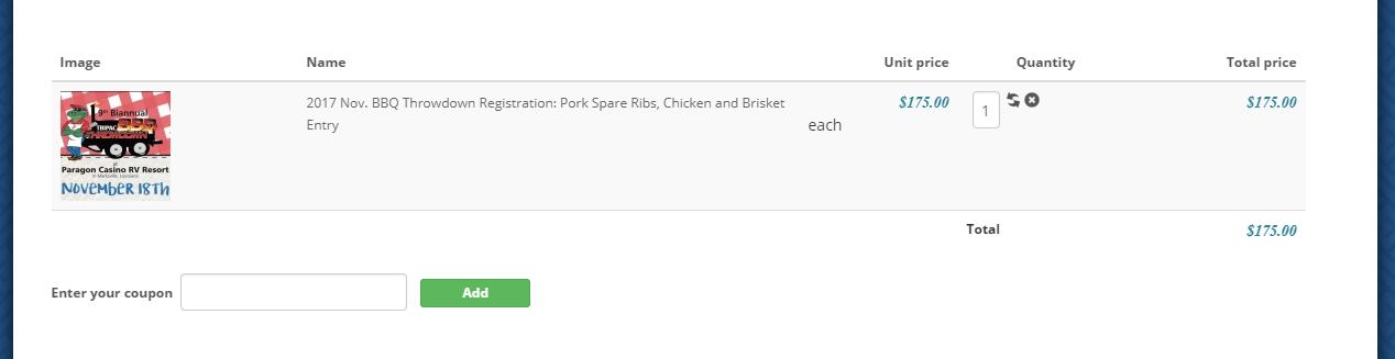

I've tested it without required custom fields. Although the item is added to the cart when the fields are not required, the custom field data doesn't seem to save. Screenshots 1 and 2 illustrate this.

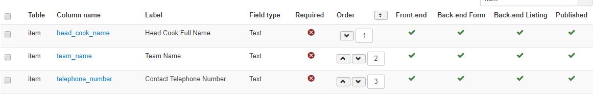

Screenshot 3 is the custom fields in list view after being made not required.
Screenshot 4 is the settings for one of the required custom fields after re-enabling them.

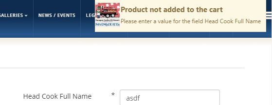

From the message the cart is giving when trying to add an item with a required field, it seems like it thinks the field is blank even when it is filled out.

The issu is that you're using the "characteristic selection method" in "list" mode and that mode is not yet compatible with custom item fields.
I've added a task for us to add that to the next version of HikaShop as top priority.
In the mean time, I would recommend to use another selection method like "dropdown" or "radio" so that it would take into account the custom item fields.
