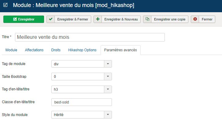

8 years 11 months ago #279877
Can you provide a screenshot of your module configuration ?
Especially HikaShop Options tab and Advanced tab can able us to understand what's going on.
Can you precise the context where you want to display the module.
Awaiting news from you.

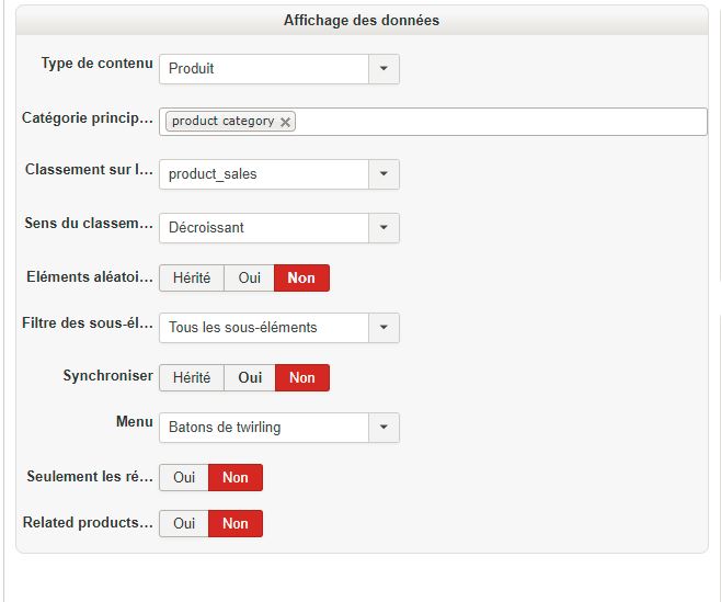

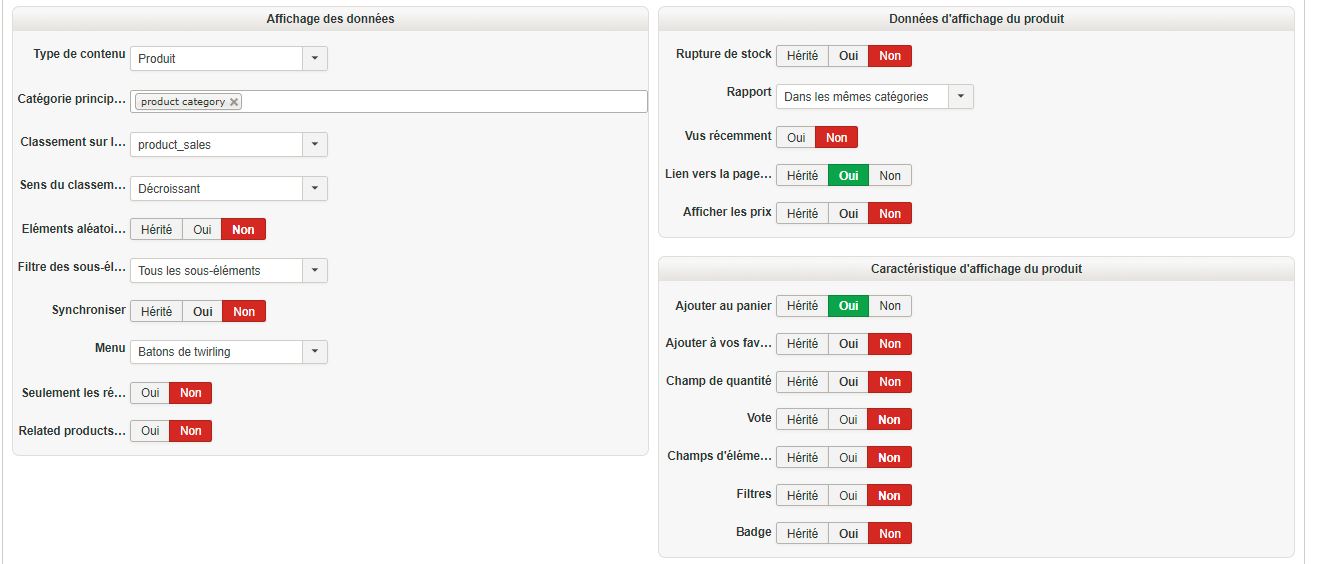

  • Posts: 202
8 years 11 months ago #279936
in the front end I need to display a module that shows the best seller product.
here are the settings I use in the HikaShop Content Module
thanks
cyril

  • Posts: 202
8 years 10 months ago #280119
Here are the screeshots you requested (at least this is what I understood)
Cyril
8 years 10 months ago #280144
From all I can see, everything seems right, unless maybe your "Ordering direction Ascending" option that must be "Ascending" ?
I get what you need by doing same setting but with Ascending value.
If that don't solve your issue, can I have backend acces and process some tests ?
Note : You can use our Contact us form to provide important references, just add to your message an Url link to this topic.
