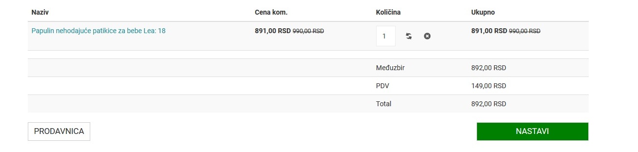

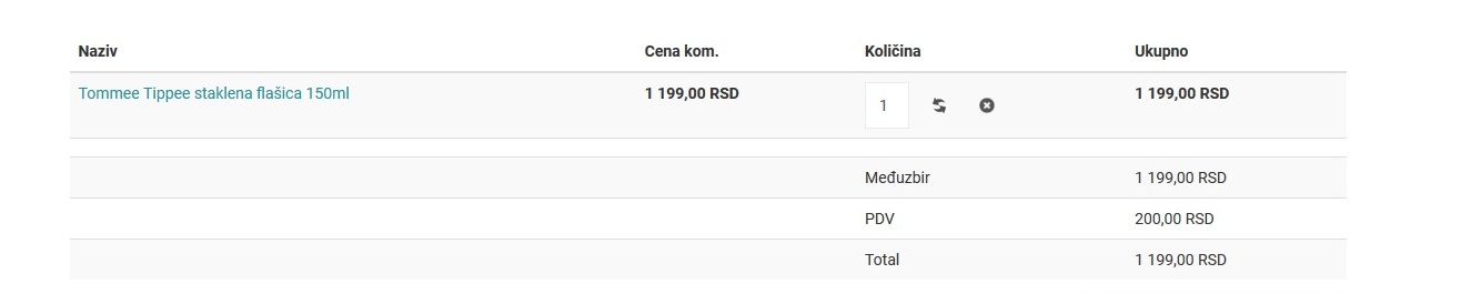

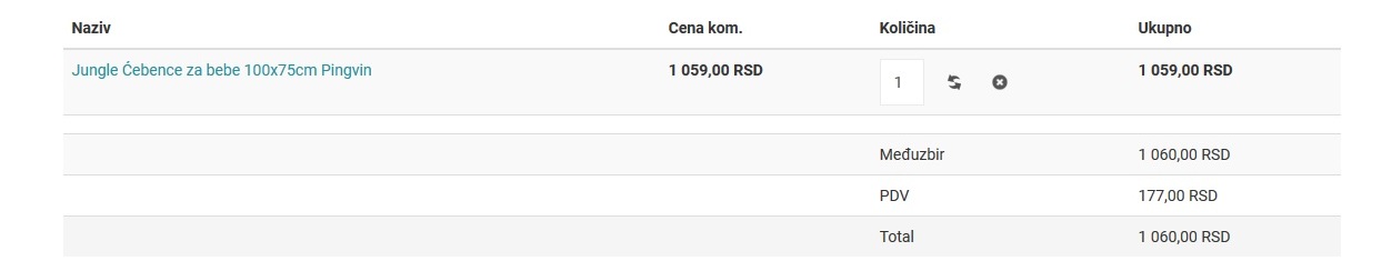

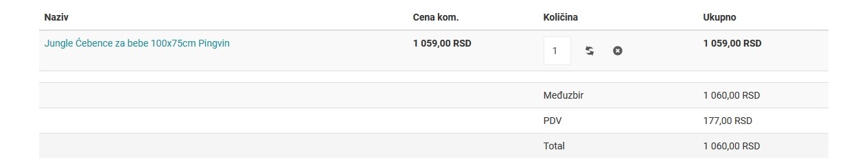

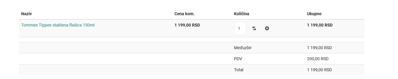

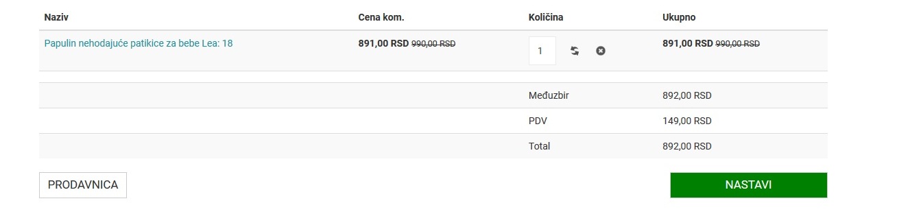

We noticed problem with some prices and cart total. It's not for every product, it's for some products(not discounted) with 9 as last number, and for some discounted products (we using rounding option).
Picture CART is product with 9 as last number and it's working normal
Picture CART2 is product with 9 at the end. Total is for 1 rsd higher in total. Link for product: bebili.rs/prekrivaci-za-bebe/jungle-cebe...ebe-100x75cm-pingvin
Picture CART3 is product with discount. Price of product is different for 1 rsd in total. Example: bebili.rs/nehodajuce-patike/papulin-neho...patikice-za-bebe-lea

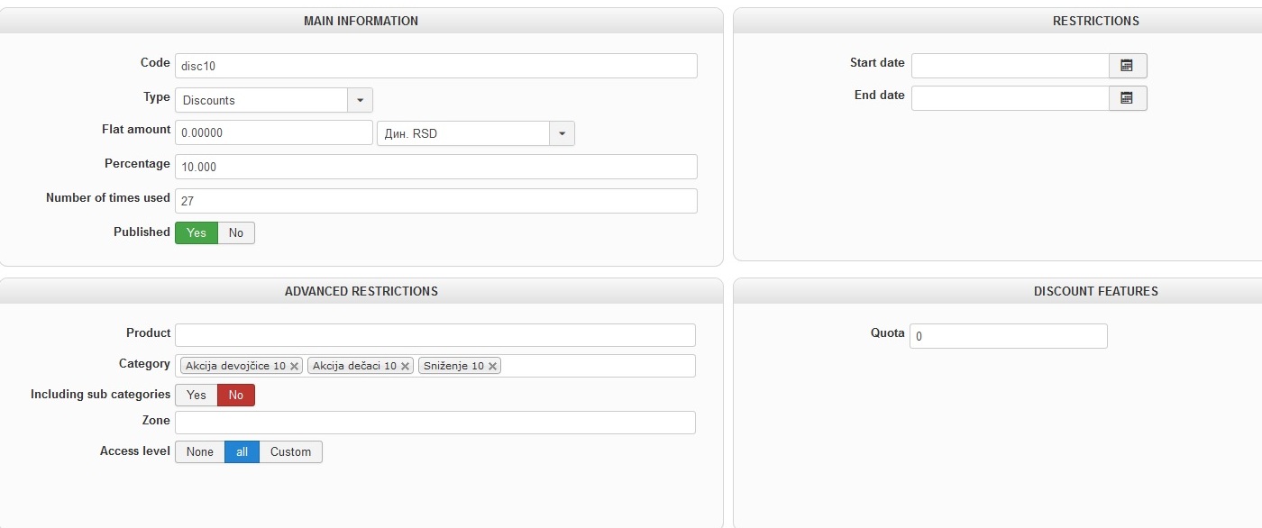

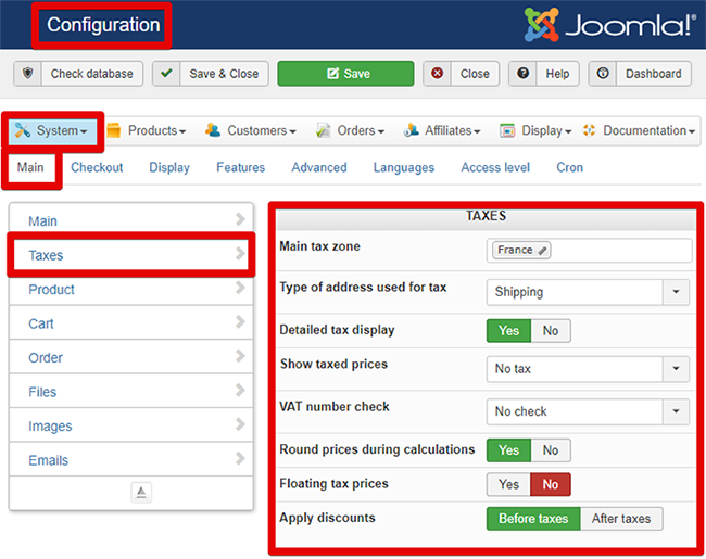

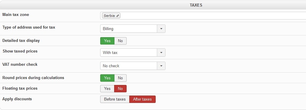

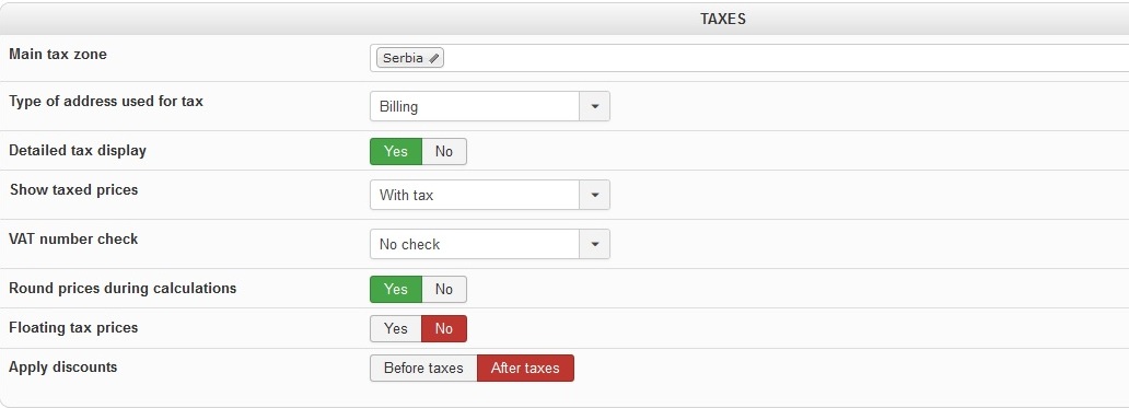

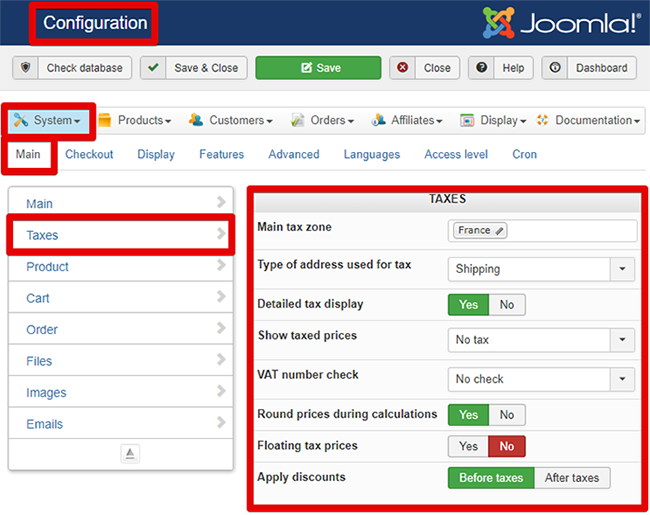

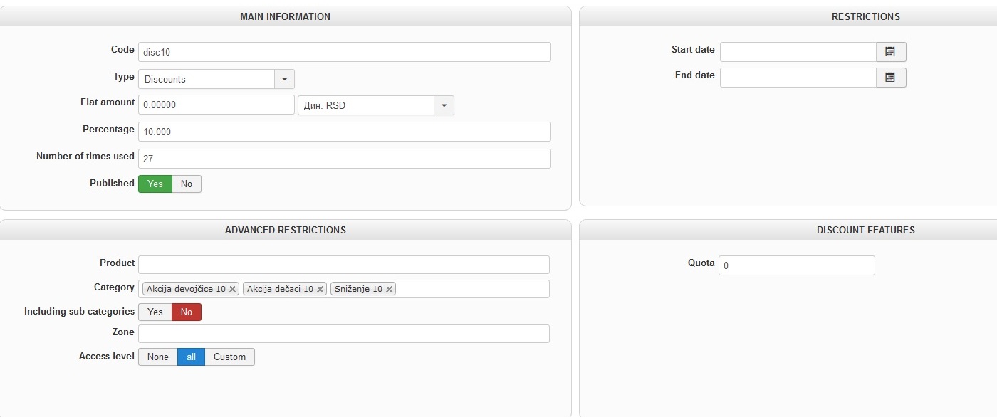

Can you provide Taxes settings, in HikaShop Main Configuration in Main tab, and in Taxes part like on this screenshot :
And your Discount configuration as well.
Awaiting returns from you.
Last edit: 8 years 10 months ago by Philip.

8 years 10 months ago #280549
Pictures are in attachment. Discounted setup is what I have used for product: bebili.rs/nehodajuce-patike/papulin-neho...patikice-za-bebe-lea

Thank you for the access. We were able to investigate and found that it was a bug which would appear only in some rare case with products with discounts.
We've added the patch for that on your website and we'll also add it to the next release of HikaShop which is to be released soon.

Thanks for fast intervention :) We still have problem with no discounted products. Example:
bebili.rs/prekrivaci-za-bebe/jungle-cebe...ebe-100x75cm-unicorn
Original price 1059.00. When we add in cart it's 1060.00.

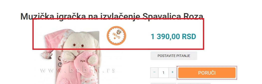

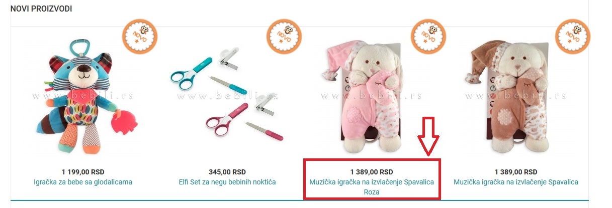

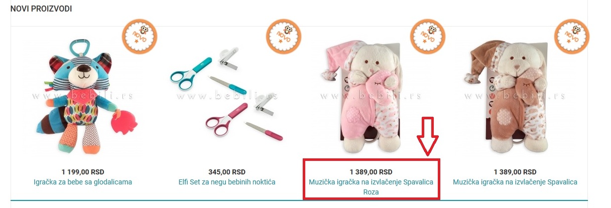

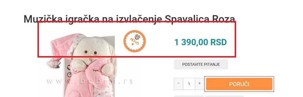

8 years 10 months ago #281115
Well, something went wrong :) Correct price should be 1059,00, but now on product page(and in cart) it's showing 1060.00.
Modules on front page showing correct price, but when u enter price is changed for +1.
Pictures in attachment.

8 years 10 months ago #281221
No the correct price IS 1060.
You've configured HikaShop to round prices and with a round increment of 1.
So the taxes calculate to 176.5 which is then rounded to 177 and then added to the untaxed price 882.50 which is also rounded to 883 which gives 1060.
Now there is a problem on the listing which doesn't take into account properly the round increment. I've made a patch so that it works properly for that too.
Now you get the amount 1060 everywhere as it is supposed to be. If however you want to see 1059, then you have to change the untaxed amounts that you entered in your products and/or change the round increment.
.Then, you'll get 1059 everywhere and the calculations will be correct.
