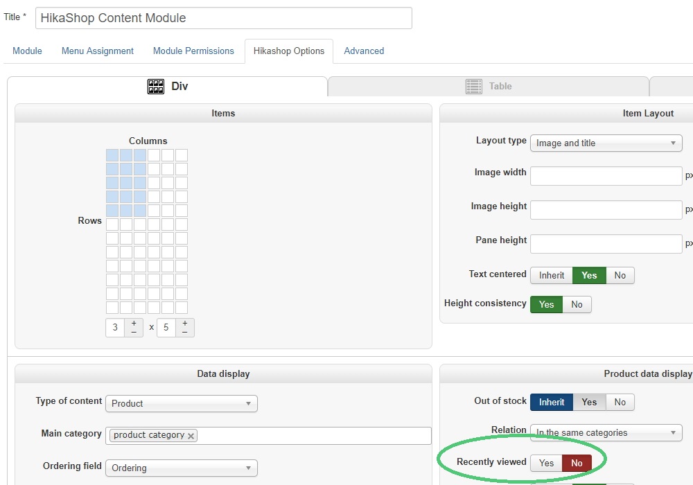

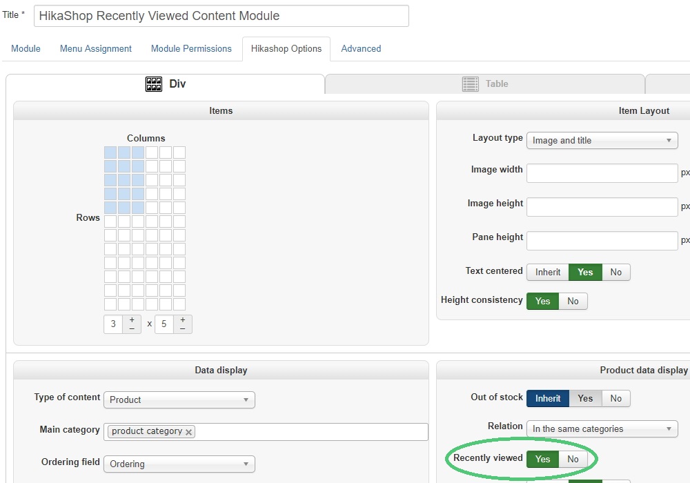

Hello! I attempted to add a content module (upper) and a recently viewed one (lower) and I set shown on the recently viewed module that I wished to put (lower). I however saw that it displayed that these two were the same. Does it bother to tell us what's up with that? Your solution to that is appreciative!

Regarding your screenshot, it's unfortunately a partial screenshot and we would need a complete one to be sure that your settings are correct.
More than that, some explanations about "where the module" is placed would be useful.

Thank you. We have solved the problem inside the settings of data display in the tab of HikaShop Options.
