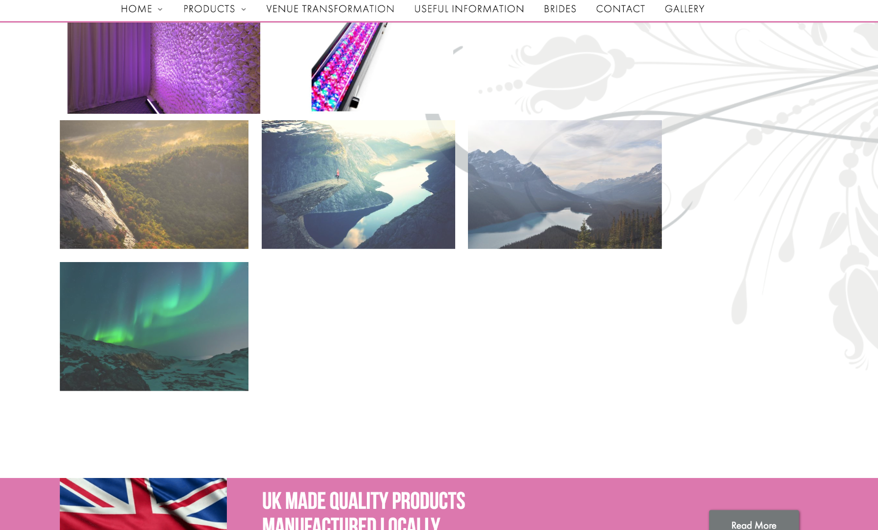

I am using a tab gallery selector in one of my product tabs, However it doesn't seem to want to read the script.
I have placed the script at the bottom of the index.php file and all the HTML within in the custom field tab.
I have tested in a regular Joomla article and it all works fine.
What would be preventing it to read the script in the custom field tab.
I have provided the exact page above and the issue is under tab 'style & colour'
It currently displays 4 images and when clicked on it should display a large image below them

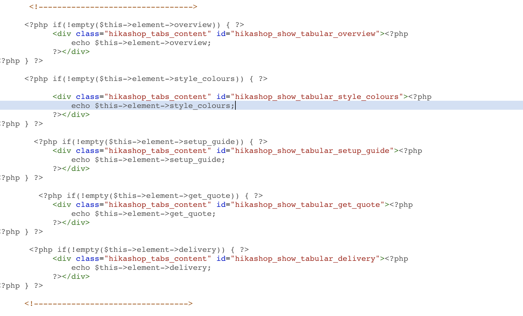

No its not a plugin. I have added the script into the index.php file to function and everything else is HTML and CSS.
Do I just add that PHP into the show_tabular.
I have attached what the tab section looks like under show_tabular
Here is the link to the Tab Gallery Selector I am trying to reproduce as an example of its function.
www.w3schools.com/howto/howto_js_tab_img_gallery.asp

I originally copied that php code to add the custom fields as tabs. Removing the onclick displayTab from the php removes the js error and the tabs still function as should. However it has still not resolved the issue I began with.
Why the tab gallery I have added is not working within Hikashop?
Thanks for your help so far.

Thankyou for helping me out. The reason it was repeating was because the specification tab was also calling in all of the custom fields as well as my own custom tab fields. Commenting out the specification in the view file as resolved this issue.
Thanks again really appreciate it.
