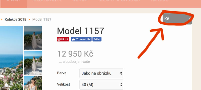

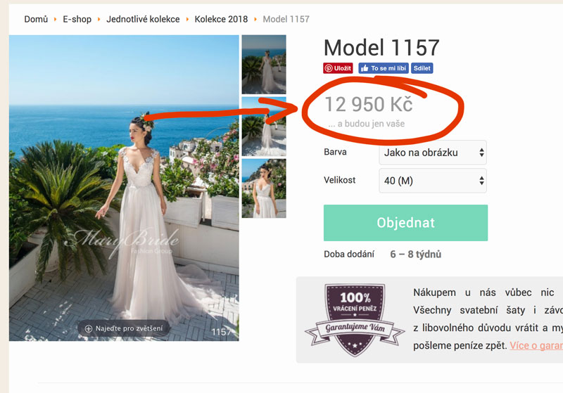

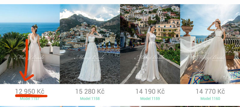

Without caching, it takes 3 seconds to generate content of my website, so loading time is absolutely slow (6s+).
Caching is the only option for me.
But I would need to exclude cart, currency switcher module and views that generates prices in listing and in product view.
Check pictures attachments please.

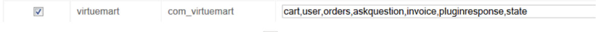

I tried to install JOTcache but I do not understand in what format I should type path to this views.
There is such an example, but I need to exclude only part of view that generates prices.
Please, could you help me what I have to type in this exclusion box to make it work properly?

I am not sure where to find Joomla module exclusion from the cache. But even if I do, it will probably not help me to not cache price as I showed in pictures, right?
Could you tell me what exact view files or controllers must be excluded to avoid caching prices in the product listing, product view and checkout – cart?

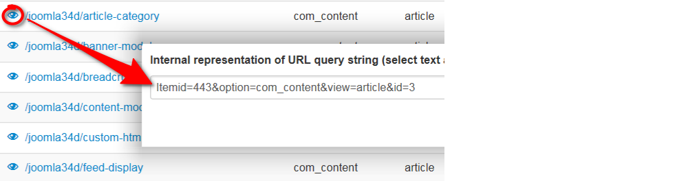

Nicolas, please, is there any internal URL for this parts of page?
Like this one
This will help me to solve this.
F.
