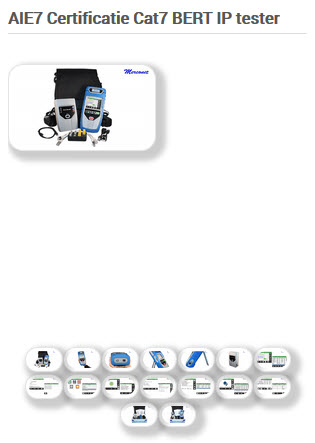

I have updated Hikashop to 3.2.2. I have noticed that the image at the product page on mobile layout has gap/space in between the image and thumbnails.

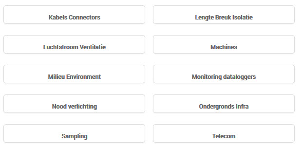

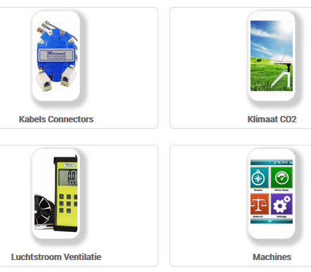

I have tried switching the thumbnail off by the Configuration, it did work for the mobile but the problem is my product listing is at the desktop is looking like this:
Instead of this:

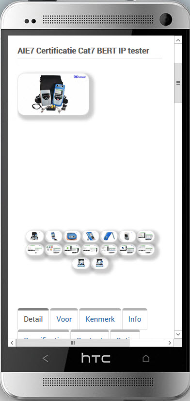

I have switched the thumbnails ON again. This is the latest info:
Please help me solve this problem.

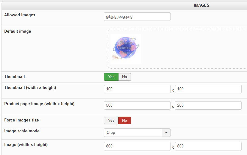

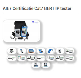

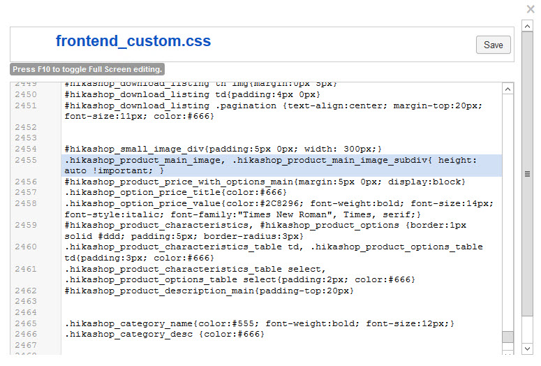

I don’t know if I was adding the code at the right place but cannot see changes on mobile layout. This is how it looks like after adding the code:
I was adding the code at Configuration – CSS at this location:

8 years 7 months ago #286857
I made a mistake on the class names, it should be:
.hikashop_product_main_image, .hikashop_product_main_image_thumb{ height: auto !important; }

  • Posts: 73
  • Thank you received: 9
8 years 7 months ago #286900
It is working good now.
Thank you so much for your help.
