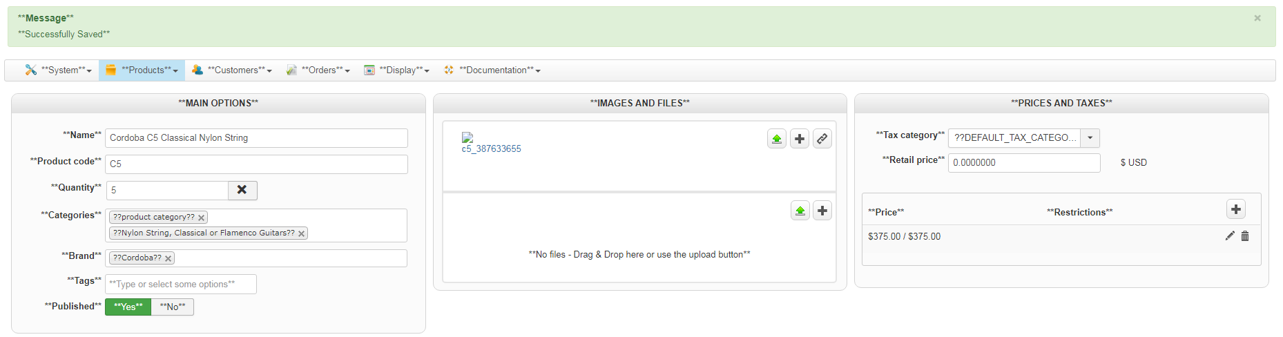

Hello!
Unable to load images for product.
Image loads. Shows hallow box/icon. Upon saving, the box/icon shows broken. No errors,
If I check the /media/com_hikashop/upload, there's no image.
I can upload the image to /joomla/media/com_hikashop/upload and try to link to it, but same problem.
directory permissions is set to:775.
Image name: c5.png
Image size : 35k
I've tried with different file types, same problem.
Thanks!
Last edit: 8 years 6 months ago by parker.

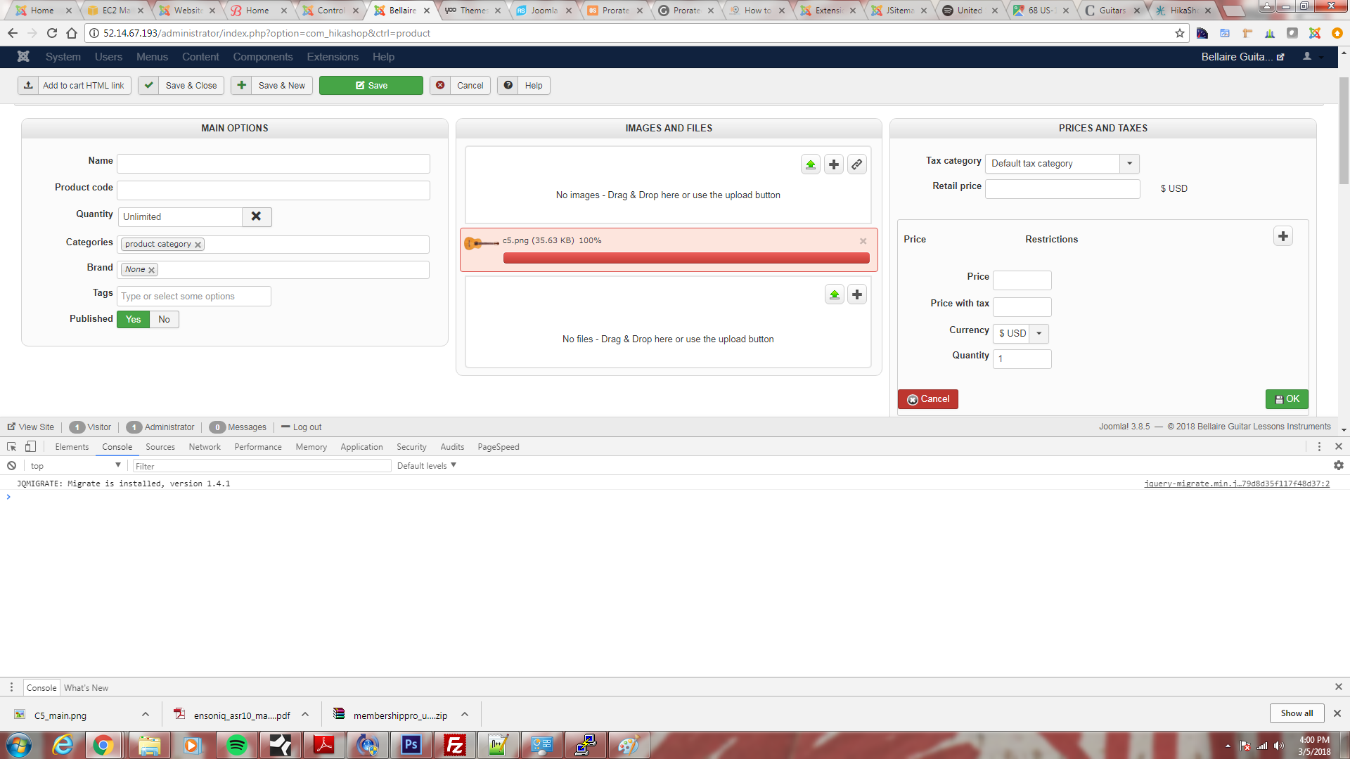

  • Posts: 48
8 years 6 months ago #288967

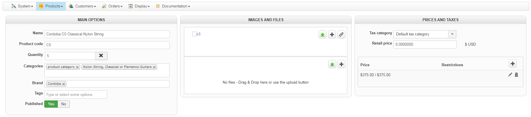

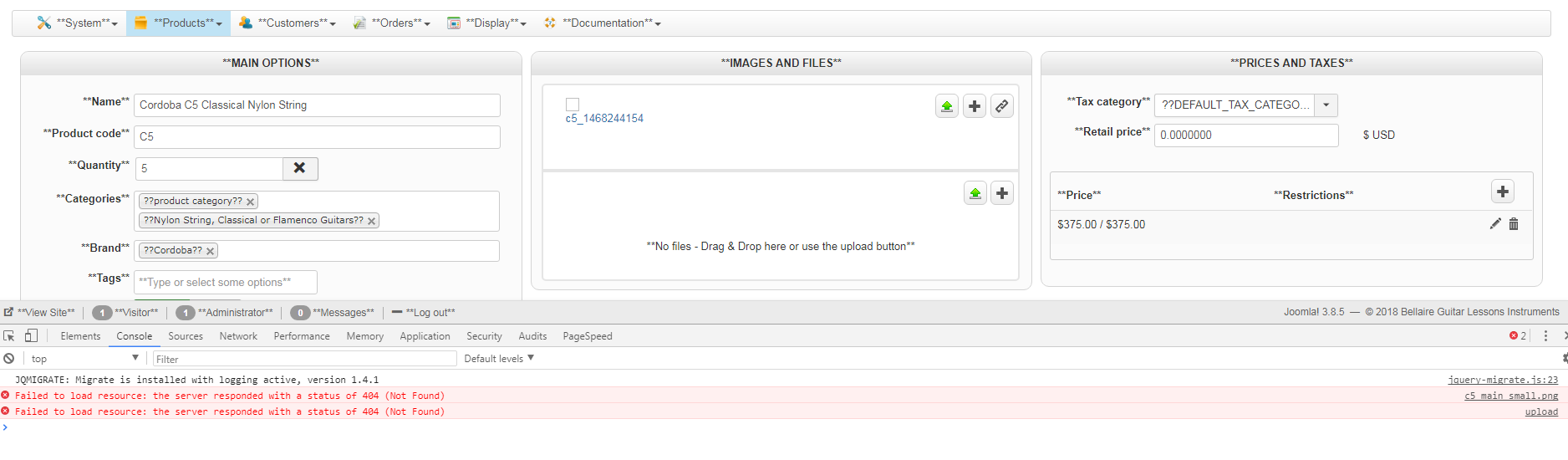

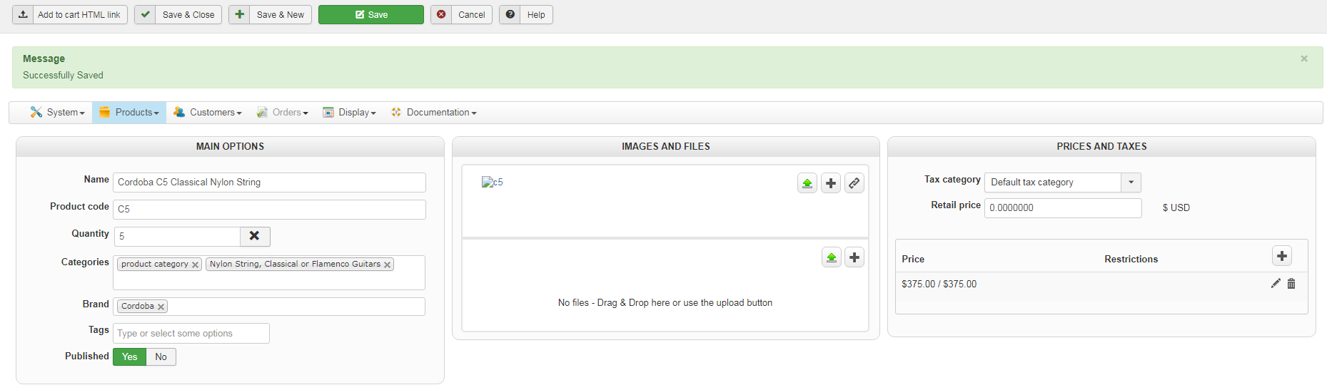

Here are 4 screen shots.
The first is after upload,
the second is after save,
and the third is joomla debug mode:
the fourth is consul debug

So on that same page, try again to upload an image but this time with the "Network" tab of the developer tools open.
You'll see a POST done to your web server.
If you click on it, you'll be able to look at what the server is returning to the javascript uploader and it will hopefully provide more information on the issue.
egghead.io/lessons/tools-analyze-http-re...with-chrome-devtools
If you could do that and provide screenshots of the data returned by the upload request it would be great.

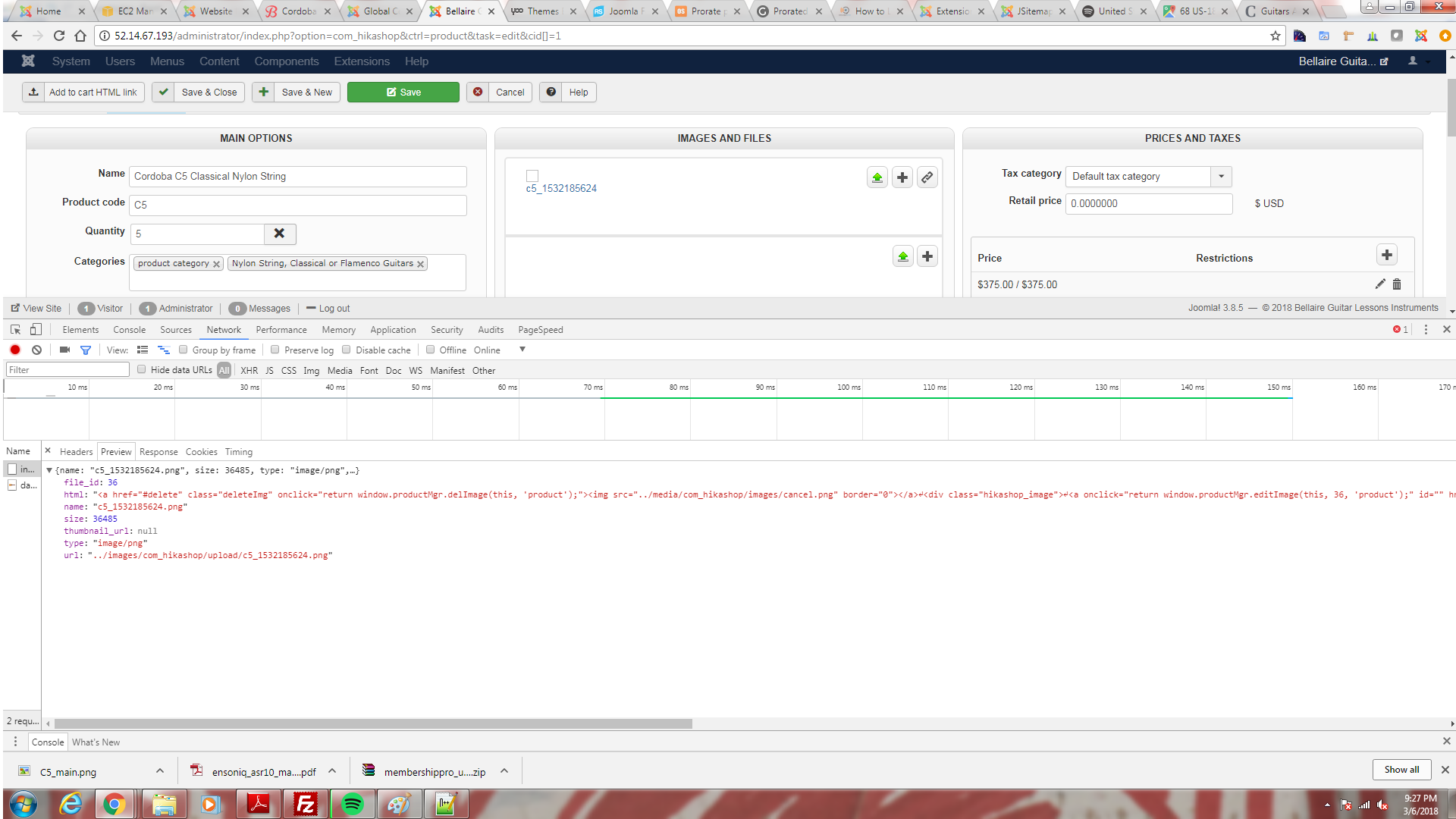

  • Posts: 48

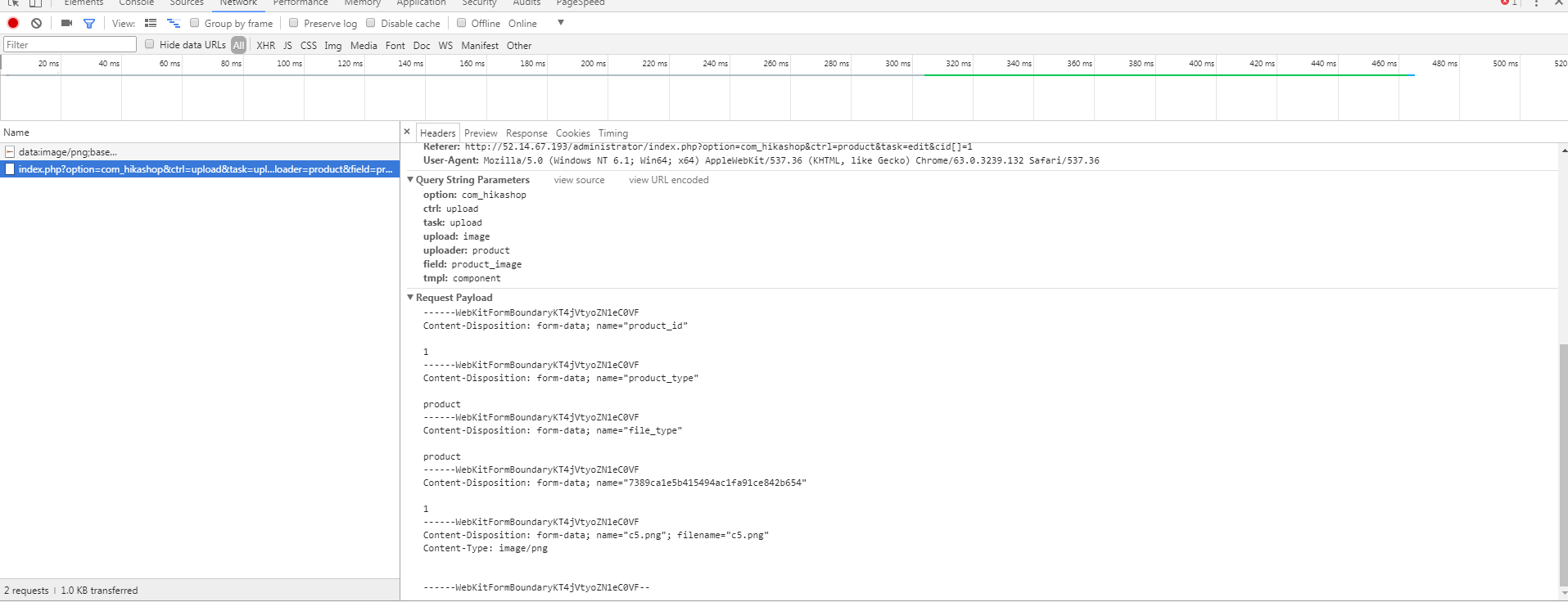

8 years 6 months ago #289126
Okay, I tried to load an image with the "Network" tab of the developer tools open. Here's the screen:
This is what I get when I click on the post:
Thanks.

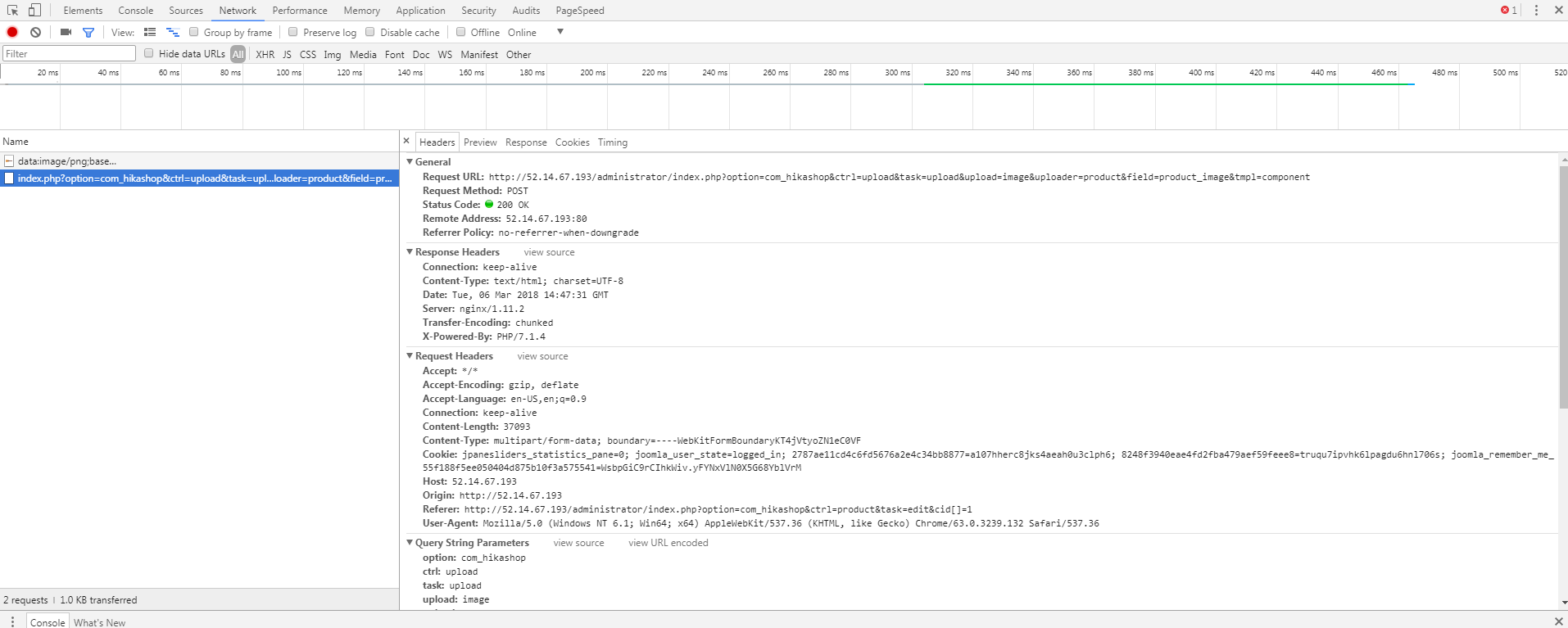

  • Posts: 86099
  • Thank you received: 14200
8 years 6 months ago #289129
That's great but we need screenshots of what you have in the "preview" and "response" tabs, not really the "headers" tab.
Could you do that please ?
Also, try with the "error reporting" and "debug mode" settings of the Joomla configuration activated. That might give more information in these tabs.
Last edit: 8 years 6 months ago by nicolas.

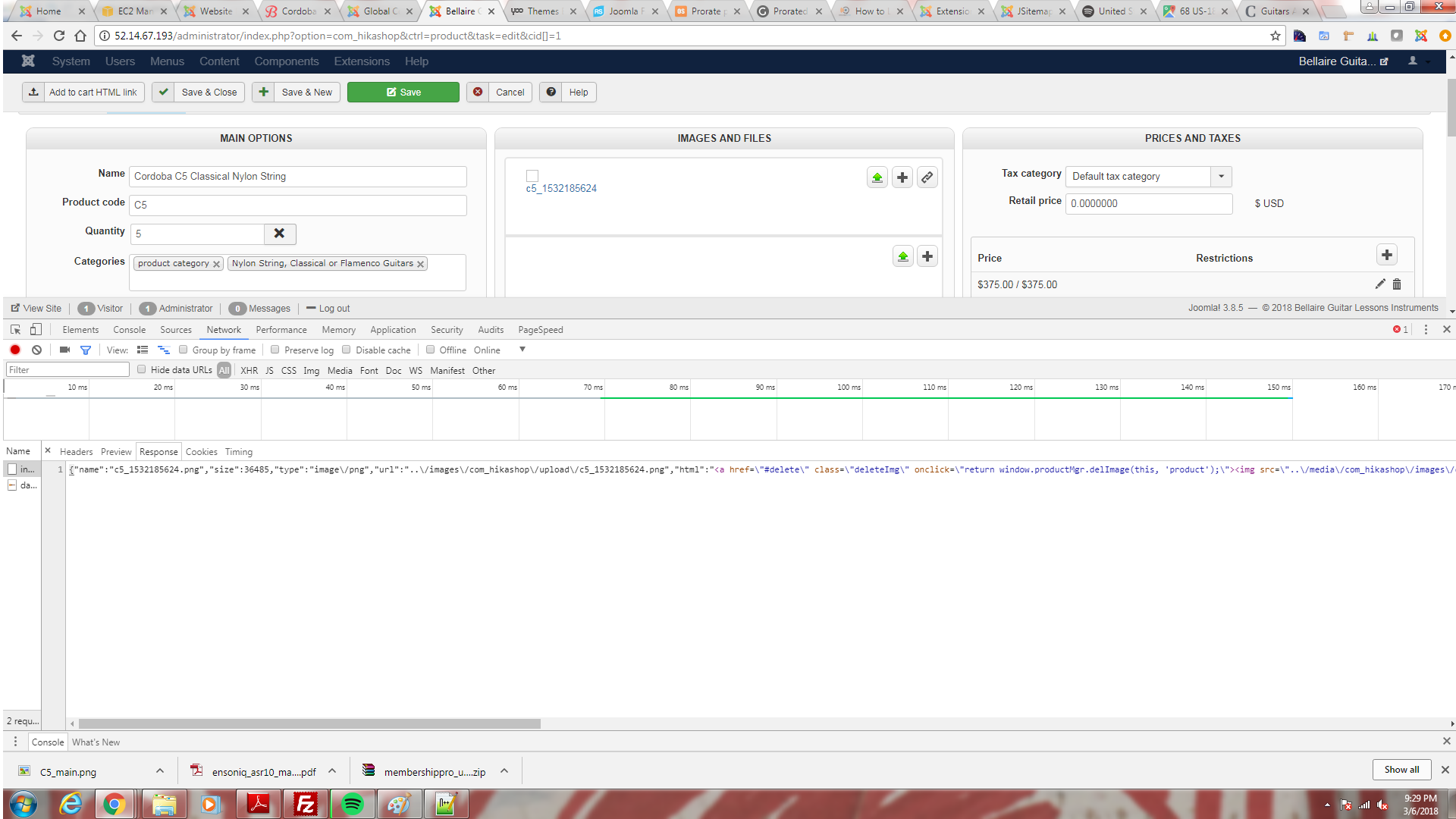

  • Posts: 48
8 years 6 months ago #289158
Thanks. You really can't see everything in the preview, so I gave you a cut and past too:
{name: "c5_1532185624.png", size: 36485, type: "image/png",…}
file_id: 36
html: "<a href="#delete" class="deleteImg" onclick="return window.productMgr.delImage(this, 'product');"><img src="../media/com_hikashop/images/cancel.png" border="0"></a><div class="hikashop_image"><a onclick="return window.productMgr.editImage(this, 36, 'product');" id="" href="/administrator/index.php option=com_hikashop&ctrl=product&task=selectimage& cid=36&pid=1&tmpl=component" data-hk-popup="squeezebox" data-squeezebox="{handler: 'iframe', size: {x: 750, y: 460}}"><img src="" alt="c5_1532185624" /></a></div><input type="hidden" name="data[product][product_images][]" value="36"/>"
thumbnail_url: null
type: "image/png"
url: "../images/com_hikashop/upload/c5_1532185624.png"
Here the Response:
{"name":"c5_1532185624.png","size":36485,"type":"image\/png","url":"..\/images\/com_hikashop\/upload\/c5_1532185624.png","html":"<a href=\"#delete\" class=\"deleteImg\" onclick=\"return window.productMgr.delImage(this, 'product');\"><img src=\"..\/media\/com_hikashop\/images\/cancel.png\" border=\"0\"><\/a>\r\n<div class=\"hikashop_image\">\r\n<a onclick=\"return window.productMgr.editImage(this, 36, 'product');\" id=\"\" href=\"\/administrator\/index.php?option=com_hikashop&ctrl=product&task=selectimage&cid=36&pid=1&tmpl=component\" data-hk-popup=\"squeezebox\" data-squeezebox=\"{handler: 'iframe', size: {x: 750, y: 460}}\"><img src=\"\" alt=\"c5_1532185624\" \/><\/a><\/div><input type=\"hidden\" name=\"data[product][product_images][]\" value=\"36\"\/>\r\n","thumbnail_url":null,"file_id":36}

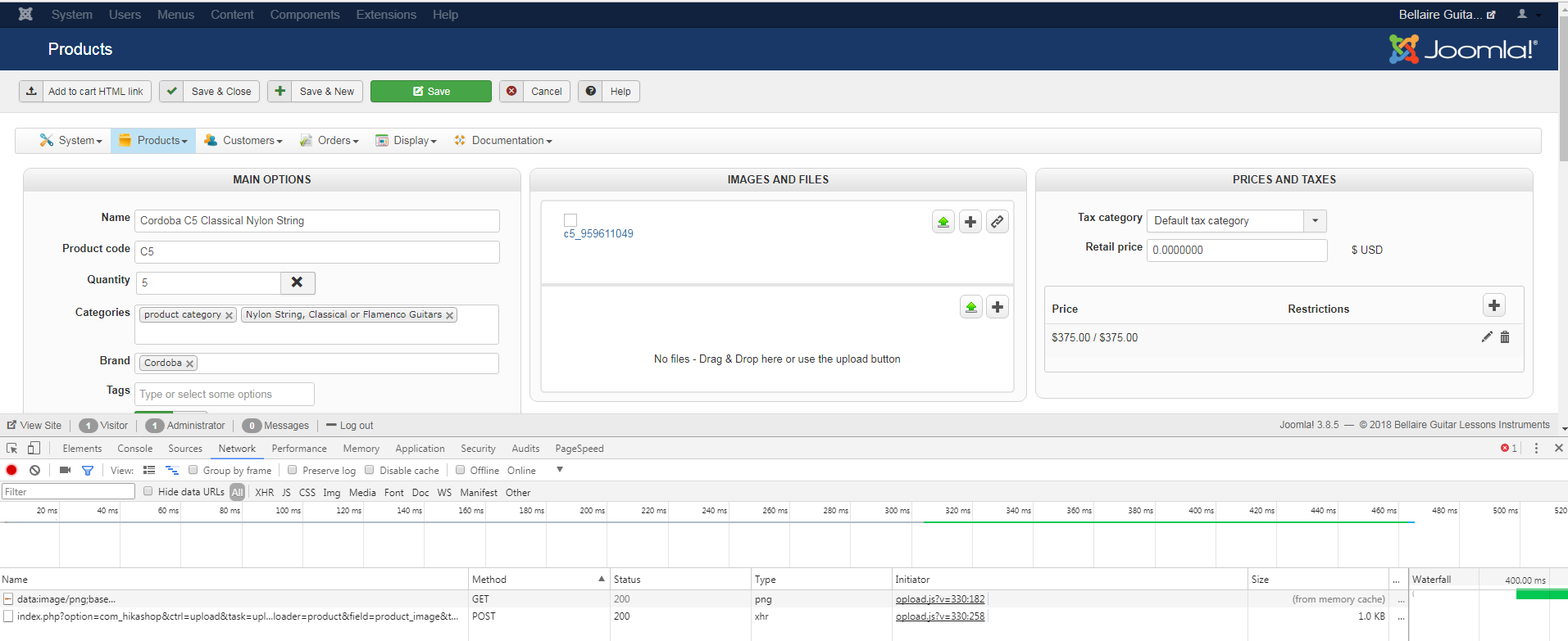

Here's preview with debug on:
{name: "c5_1956578068.png", size: 36485, type: "image/png",…}
file_id:38
html:"<a href="#delete" class="deleteImg" onclick="return window.productMgr.delImage(this, 'product');"><img src="../media/com_hikashop/images/cancel.png" border="0"></a><div class="hikashop_image">
<a onclick="return window.productMgr.editImage(this, 38, 'product');" id="" href="/administrator/index.php?option=com_hikashop&ctrl=product&task=selectimage&cid=38&pid=1&tmpl=component" data-hk-popup="squeezebox" data-squeezebox="{handler: 'iframe', size: {x: 750, y: 460}}"><img src="" alt="c5_1956578068" /></a></div><input type="hidden" name="data[product][product_images][]" value="38"/>
thumbnail_url:null
type:"image/png"
url:"../images/com_hikashop/upload/c5_1956578068.png"
Here's reponse with debug on:
{"name":"c5_1956578068.png","size":36485,"type":"image\/png","url":"..\/images\/com_hikashop\/upload\/c5_1956578068.png","html":"<a href=\"#delete\" class=\"deleteImg\" onclick=\"return window.productMgr.delImage(this, 'product');\"><img src=\"..\/media\/com_hikashop\/images\/cancel.png\" border=\"0\"><\/a>\r\n<div class=\"hikashop_image\">\r\n<a onclick=\"return window.productMgr.editImage(this, 38, 'product');\" id=\"\" href=\"\/administrator\/index.php?option=com_hikashop&ctrl=product&task=selectimage&cid=38&pid=1&tmpl=component\" data-hk-popup=\"squeezebox\" data-squeezebox=\"{handler: 'iframe', size: {x: 750, y: 460}}\"><img src=\"\" alt=\"c5_1956578068\" \/><\/a><\/div><input type=\"hidden\" name=\"data[product][product_images][]\" value=\"38\"\/>\r\n","thumbnail_url":null,"file_id":38}
  • Posts: 86099
8 years 5 months ago #289175
From what I can see the image is uploaded successfully, but HikaShop is not able to generate the thumbnail for the image.
Checnk that the thumbnail folders in images/com_hikashop/upload are writable.
Also, I don't know which exact build of HikaShop 3.3.0 you have (in the "version" setting of the HikaShop configuration). You could try download the install package on our website and install it on yours again to get all the latest patchs. That might help.

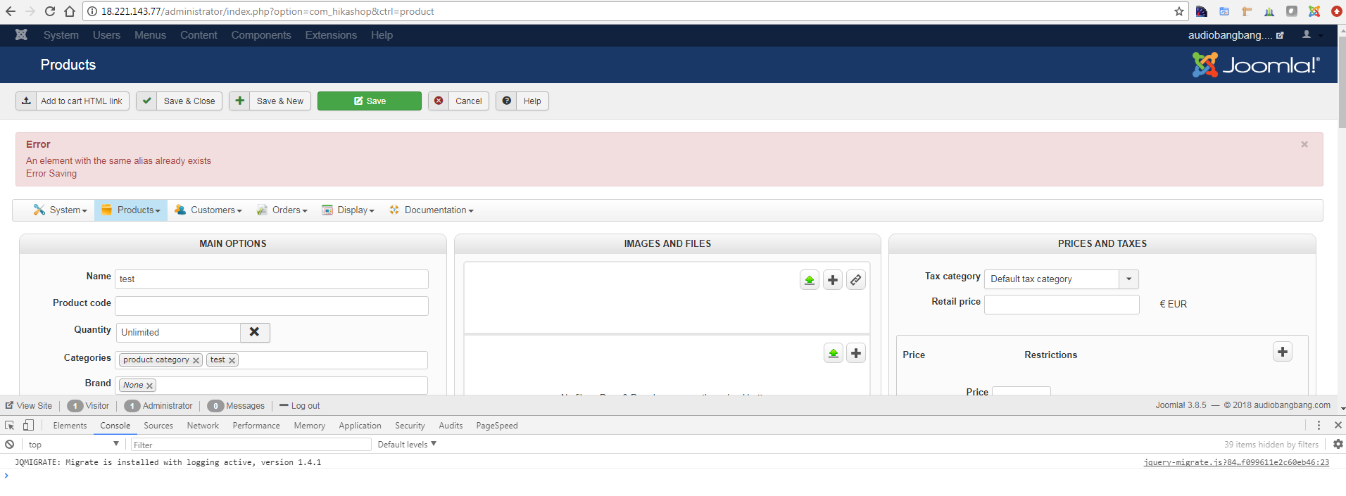

I have setup an identical server to test if it behaves the same. It does but the error reporting is better.
Here is a snapshot of what I get after I try to save an image that's never been uploaded. How could there be an alias if It's never been uploaded. I get the same error for any image I upload and try to save.
Last edit: 8 years 5 months ago by parker.
  • Posts: 86099
8 years 5 months ago #289220
No that error is not linked to your problem.
This only means that you didn't enter an alias in your product and you have the "Alias automatic filling" setting activated and you already have a product with the alias "test", or that the alias you entered is the same as another problem.

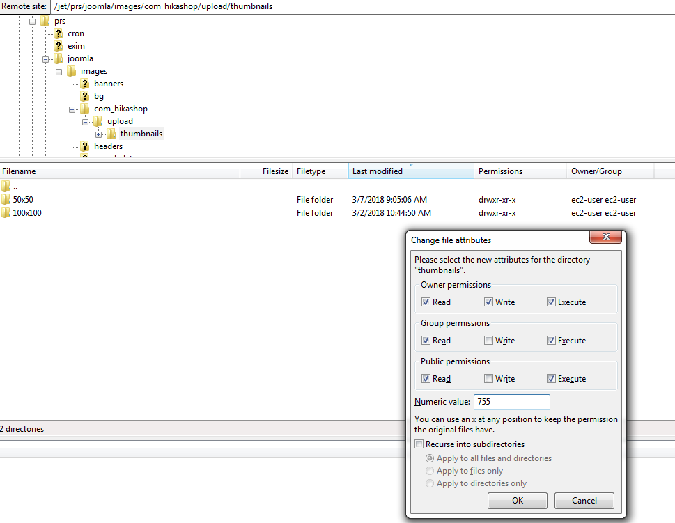

Check that the thumbnail folders in images/com_hikashop/upload are writable.
Please provide that information.

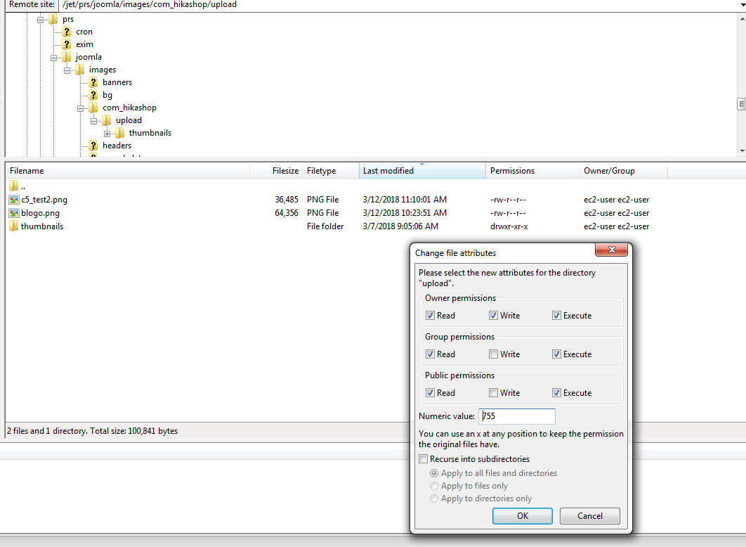

  • Posts: 48
8 years 5 months ago #289483
Thank you Jerome,
Here is my Hikashop version:
Here are my permissions for the upload directories, these show 755, I have gone as far as to set them to 777, same problem:

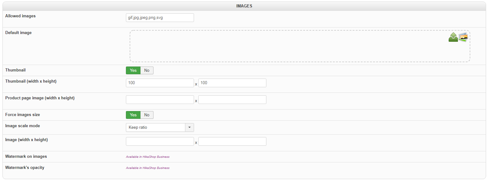

Here are my thumbnail settings:
Here are my Image settings:
The last trick "Do not save BUT click on the title "Products", didn't work.
Thanks for helping
