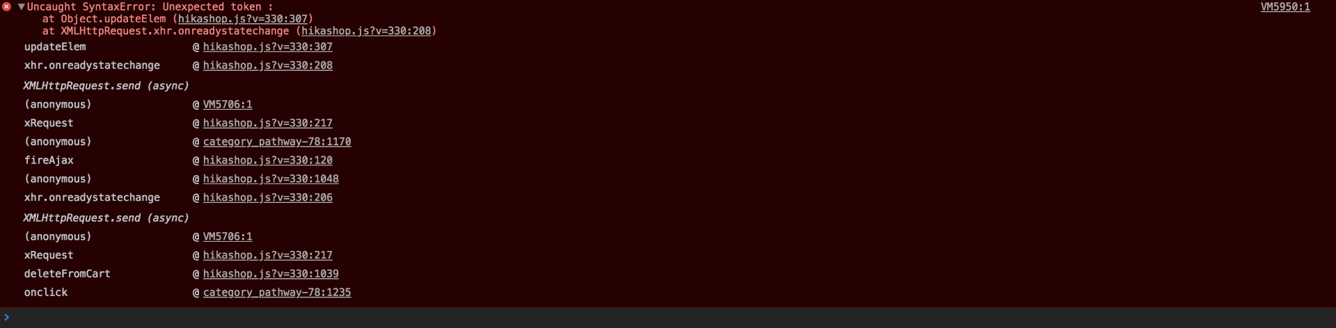

  • Posts: 162
8 years 5 months ago #289920
When I add a product to cart, I get this js error in the console, which is comming from hikashop.js .
Please see screenshot:
thanks!
  • Posts: 86099
  • Thank you received: 14200
8 years 5 months ago #289930
That javascript error is not the cause of the problem.
It is the result of your problem.
Because the AJAX request to refresh the cart module HTML returns the whole page instead of only the module HTML, the code which is supposed to add it to the page fails because it finds characters which shouldn't be there, similar to this:
stackoverflow.com/questions/32134259/jav...ror-unexpected-token
So unfortunately, it doesn't help.
As Jerome have been saying, there is an extension on your website which creates that problem. It can be the template, or a system plugin or a SEF extension. There must be something.
If you have the same issue with the protostar template, then it's probably not your template itself. It could be one of its system plugins or another system plugin, like Jerome pointed out.
Try disabling them one by one and test each time if it helps.
