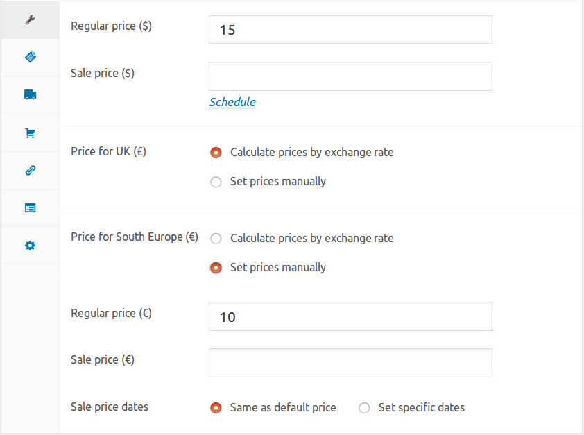

I know there is a plugin for Woocommerce, Woocommerce Price Based on Country.
But I love Joomla & Hikashop and want to know if I can achieve this with them. I searched a lot but can't find the answer. Would hate to go to WP for this project, as you all can understand why ;)

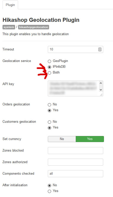

I'm almost finished with the site but when I visite the site via a VPN with USA IP I don't get the Dollars but still the Euros prices.
Do I overlook something? It shows the prices EXcluding vat in Euro's for US and INcluding vat in Euro's when I visite from Netherlands
Doesn't mather if I click both or only one option with IP check. Or click yes or no at the bottom[/strike]
EDIT
I got it working. I had to restart browser. Sorry.
