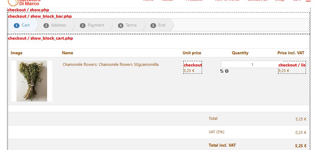

-- Joomla version -- : 3.8.7 Stable
-- PHP version -- : 7.0.30
During the check-out process, in the cart step (see printscreen), the variant code is displayed after the product name. How to avoid that? I would like to have just variant name displayed during the checkout process.
One additional question: the width of the quantity field is too long. How to reduce it?
www.mangialarossa.com/index.php/cart
Thanks in advance
Imma
8 years 3 weeks ago #293885
The solution will be to directly set the "Display product code" option to NO through your checkout workflow via "Hikashop->System->Configuration->Checkout".
Best regards,
Mohamed Thelji.
  • Posts: 80
8 years 3 weeks ago #293920
Hi Mohamed. It works.
What about my second question about the quantity field width? In the cart, this field is too long and it overlap the total price.
I tried to change from 100% to 50% in my css template but it does not work. Maybe I use the wrong css string.. can you please advise?

  • Posts: 85834
  • Thank you received: 14094
8 years 3 weeks ago #293942
The issue with the width of that field comes from the CSS of your template.
You can add such CSS to circumvent the CSS of your template:
.hikashop_product_quantity_field{ width 30px !important; }
  • Posts: 80
7 years 11 months ago #295511
Although I added the following string, the width of the quantity field is still long.
.hikashop_product_quantity_field input[type="number"]:not(.form-control), select:not(.form-control) {
What is it wrong?
Imma
7 years 11 months ago #295518
For start we will advice to use a more simple selector, something as :
#page_id .html_element_class {
width: your value;
Sometime some specific selector is of course needed but yours seems to be a little too complicated.
Last edit: 7 years 11 months ago by Philip.
