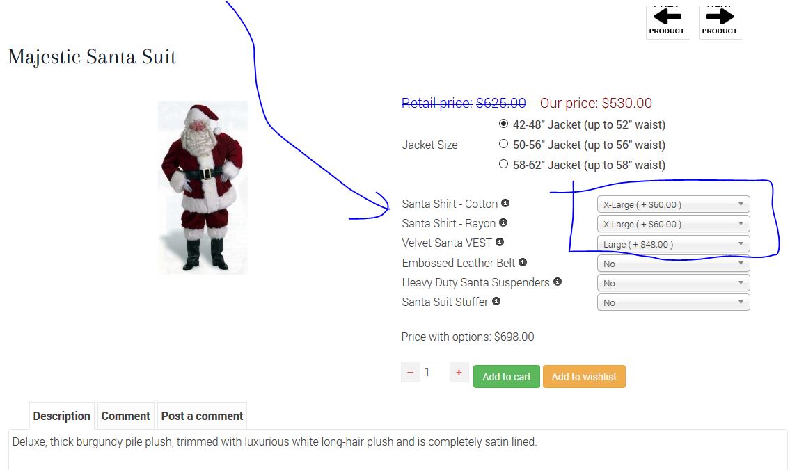

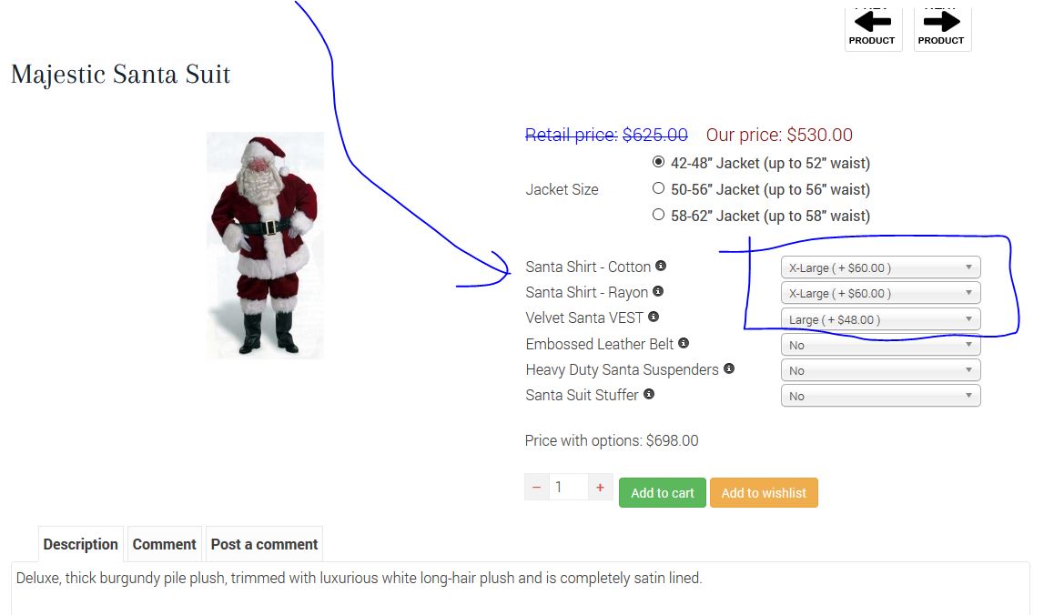

Is there a way to have the software allow options (with characteristics) have an option and default to 'No' before adding?
Explanation:
1) Adding "Embossed Leather Belt" works great. It's an item with no characteristics. So the user is NOT forced to add it. It defaults "No".
2) Adding a "Santa Shirt Cotton" has characteristics. The user may NOT want to add this, but doesn't have a chance to select "No". It only shows available sizes.
Furthermore, I can't 'add' a characteristic called "No" for the item, because that would (a) not allow a $0 price, and (b) look funny when the user is buying that item independently.
Please help. Thanks in advance.

  • Posts: 24
7 years 11 months ago #296048
Thanks Nicolas! I changed the Display/Views/Option for my template, and I now have the 'No' option showing up!
However, "No" is not the 'default' selection. Can you please tell me how to do that? I don't know what to add to the code (I'm not a programmer).
Here is the item link i'm working with:
costumesforsanta.rwmbeta.com/shop/produc...-majestic-santa-suit
I'd like to have a way for the first 3 options all default "No", just like the last 3.
Thanks again, in advance.
