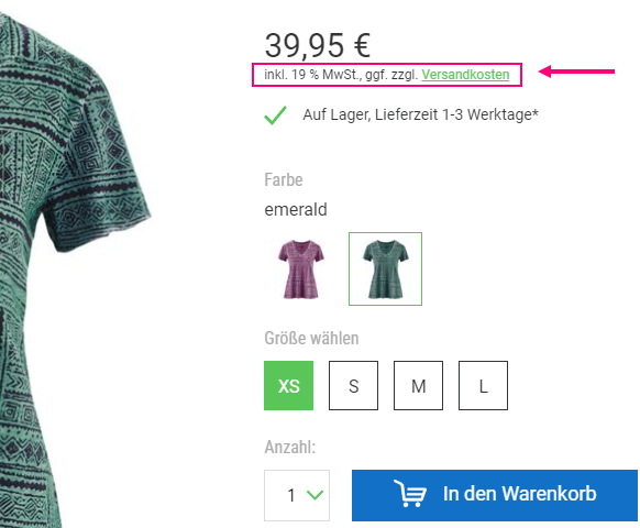

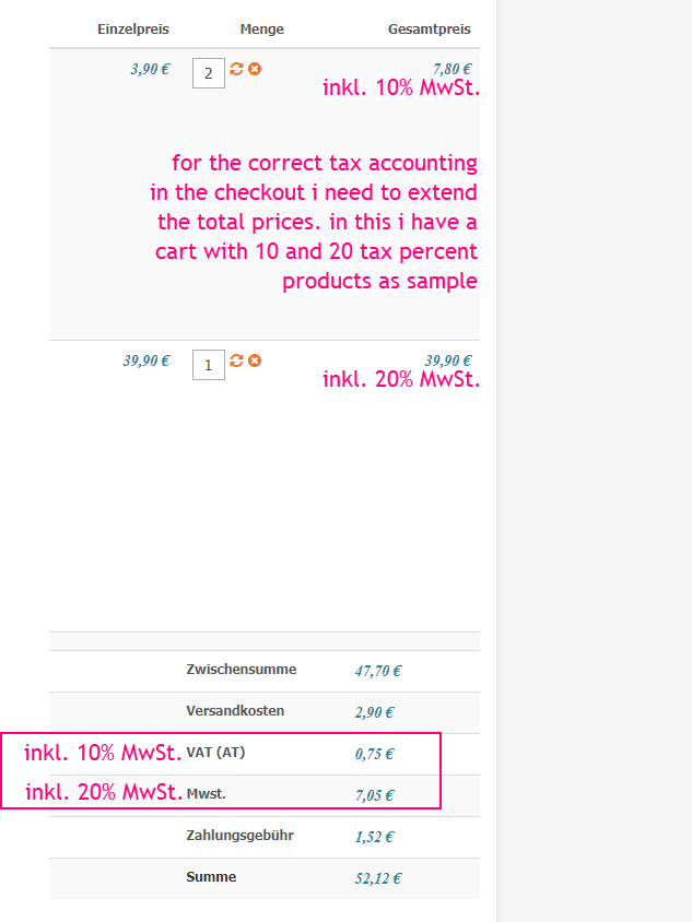

hi.
have searched this forum but is looks like there is no answer right now for this:
in germany or austria you have to display the VAT on the product.
how can i display the percentages on the product listings, detail and of course the checkout?

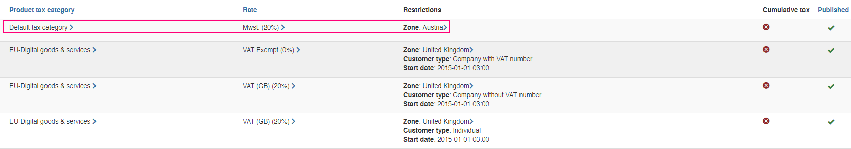

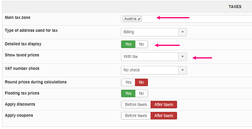

no, i have set a store default tax rate for my base country. also i use different tax for normal products and reduced tax products. also the products are sold throughout the EU.
i need the store base tax (default tax or reduced) listed on the products (listings and detail views, also modules (checkout). so i think it is not possible to change the tax to a singe tax value.
the tax must checked from the defined tax rule of the main tax zone of the store, how is that possible. i assume it could be done with few clicks but i did not find it.
nicolas wrote: On the checkout, you should already have the tax rate namekey next to the tax amount just before the total of the cart. So you can incldue the percentage in that namekey. If you already have a tax rate, you'll want to create another one with the name you want and then switch the tax rate to the new one in your tax rules via the menu System>Taxes.
on this i need to display the "percentage" of the tax too. i looked at the namekey's, as you sad there are all the percentage values. now the question is how do i get the values displayed too and not only the namekey?

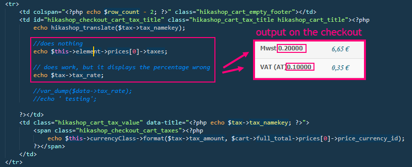

Hi Jerome.
Thank you for your answer.
i tested some code variants based on your snippet, but could not get it to run for me.
i could manage the half way with this code snippet:
echo $tax->tax_rate;
but here I have a decimal problem on the percentage with that.
maybe you could guide me in the right direction where i have adjust the code on your sample to get the right percentage out?

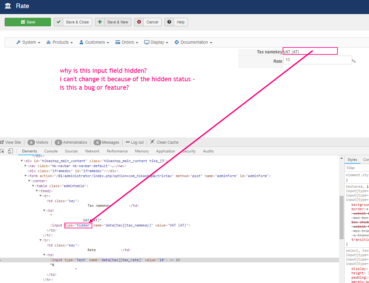

i also noticed maybe some bug about the input form for the namekey on the taxes:
right now i can't change the namekeys for the taxes - is this intentional or a mistake on my website?
7 years 9 months ago #300654
The tip I gave you for the product page ; not the cart.
The cart already have code to display the taxes ; as Nicolas already wrote.
Please understand that it would require some PHP/Development skills ; if you cannot do it yourself, do not hesitate to contact someone.
  • Posts: 103
  • Thank you received: 5
7 years 9 months ago #300697
Jerome wrote: The cart already have code to display the taxes ; as Nicolas already wrote.
yes i did understand that, and i wanted to do this. as you see in my post before, the INPUT field is set to hidden. How should i change this when i cannot see the input field!?
7 years 9 months ago #300698
Once you created a tax, you cannot change its namekey.
The namekey is used in the cart/order tax details.
But you can use the translation system to change how that tax name will be display in the front-end (and backend).
