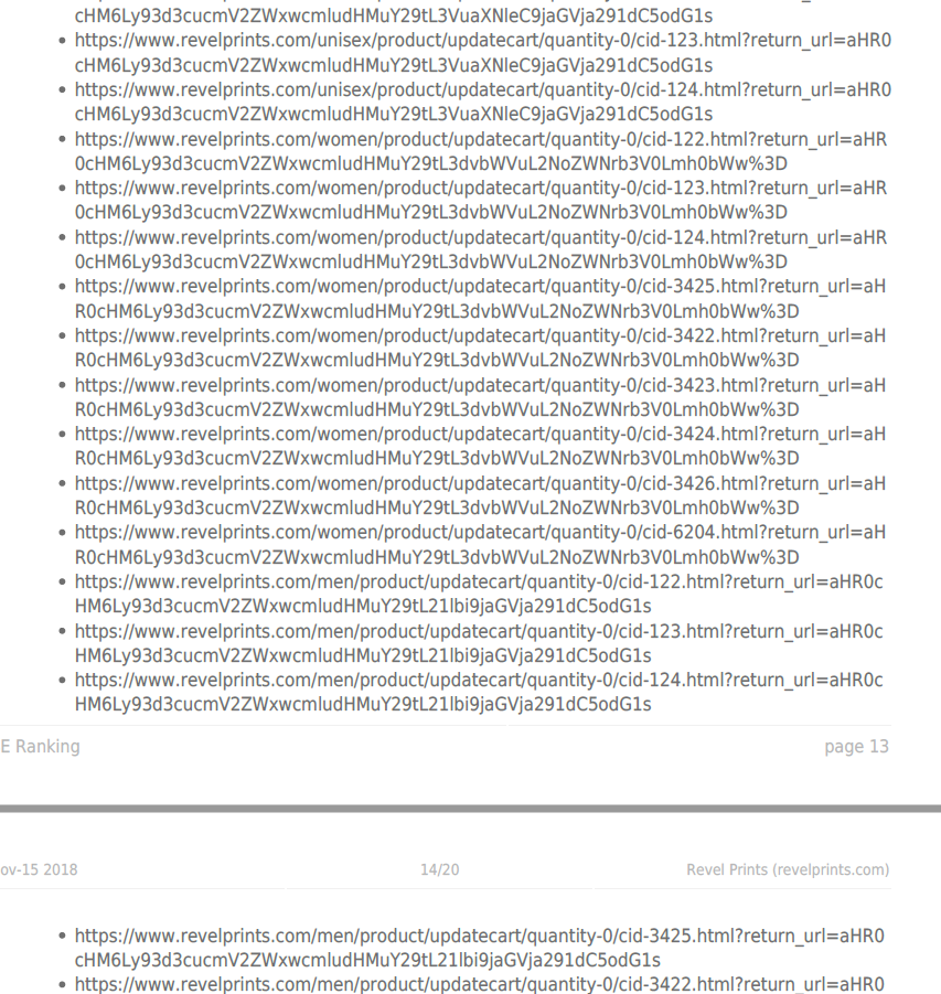

I have a site that is 100% up to date with Joomla, Hikashop & SH404Sef and I am noticing hundreds of the following sample url:
www.revelprints.com/men/product/updateca...bi9jaGVja291dC5odG1s

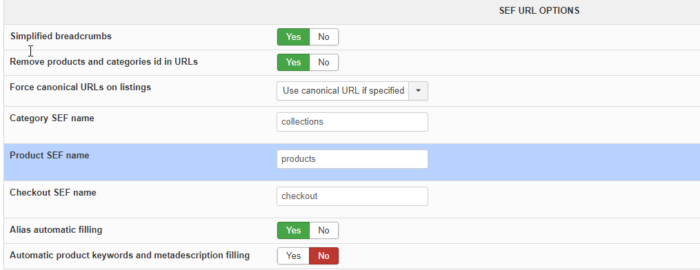

Just wondering if there is a setting somewhere or something I am doing wrong to make these urls appear on backend when doing SEO report scans. I do have the cart module listed on the homepage. I have attached SH404 Hikashop setting, Hikashop seo setting and the screenshot of urls.

Even if your website is up-to-date ; the "updatecart" URL is part of the legacy "add to cart" system.
www.hikashop.com/support/documentation/5...html#advanced_legacy
Legacy features are there to keep the retro-compatibility but in the same time, it does not allow you to use the latest features and improvements.

If I take a look at a product page source code, I cannot see any reference of the URL like the one you had.
The "add to cart" right have its right format
href="/men/product/updatecart/add-1/product_id-6322.html"
And regarding the cart module, the "return_url" parameter is right sent by POST data and not in the URL.
o.xRequest("/men/product/cart/module_id-759/module_type-cart/tmpl-component.html", {update: el, mode:'POST', data:'return_url=aHR0cHM6Ly93d3cucmV2ZWxwcmludHMuY29tL21lbi9wcm9kdWN0cy9sb3ZlLXlvdXJzLW1lbi13aGl0ZS10ZWUuaHRtbA%3D%3D'}
So, I don't know from where these URL are coming from. But it might be old/previous URL which are still referenced somewhere.

When Jerome was talking about old URLs being referenced somewhere, he wasn't talking about somewhere on your website but on search engines. The plugins installed on your website or how your website is configured don't matter in that case.
The best would be to add the main folders of these URLs:
women/product/updatecart
...etc...
and disallow their indexing in the robots.txt of your website so that search engines stop trying to index them.

Ok thanks a bunch. Can you confirm the setting i should have for sh404sef hikashop config. Should it be joomla router or default handler?? Thnx again
7 years 9 months ago #300645
The routing system has nothing to do with your current issue.
