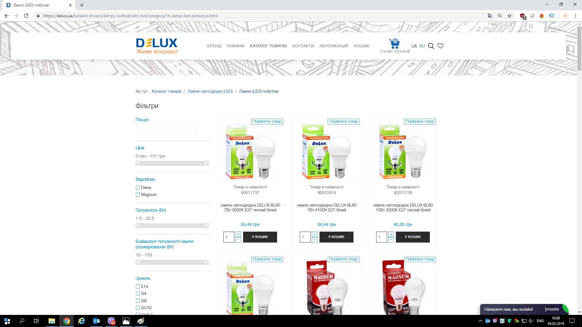

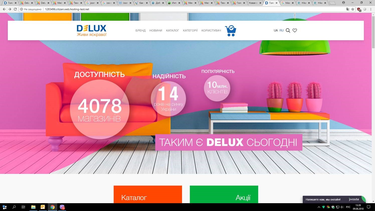

Hi.

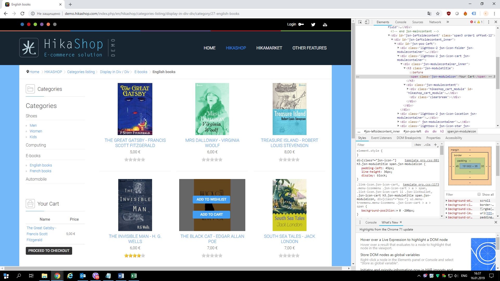

1. I read some of the older topics and documentation, but still haven't understood how to visualize Hika Shop Cart Module as an icon via CSS. Maybe it's because I'm not IT specialist, but i'd really like to do it, if possible. It should look somewhat like on the screenshot, I have the svg image availible.
If I understand right I should copy this <span> code from your demo website and insert it in the product cart php file. But yet I don't see where is the line in the CSS, where I should be able to paste the path to the cart icon.
2. I don't know, if you can help me with this, but I'd like to add this cart module into the menu and for that I would need to add a specific position in my template near the position "lang". If you could advise me also on that, I would be very greatful.

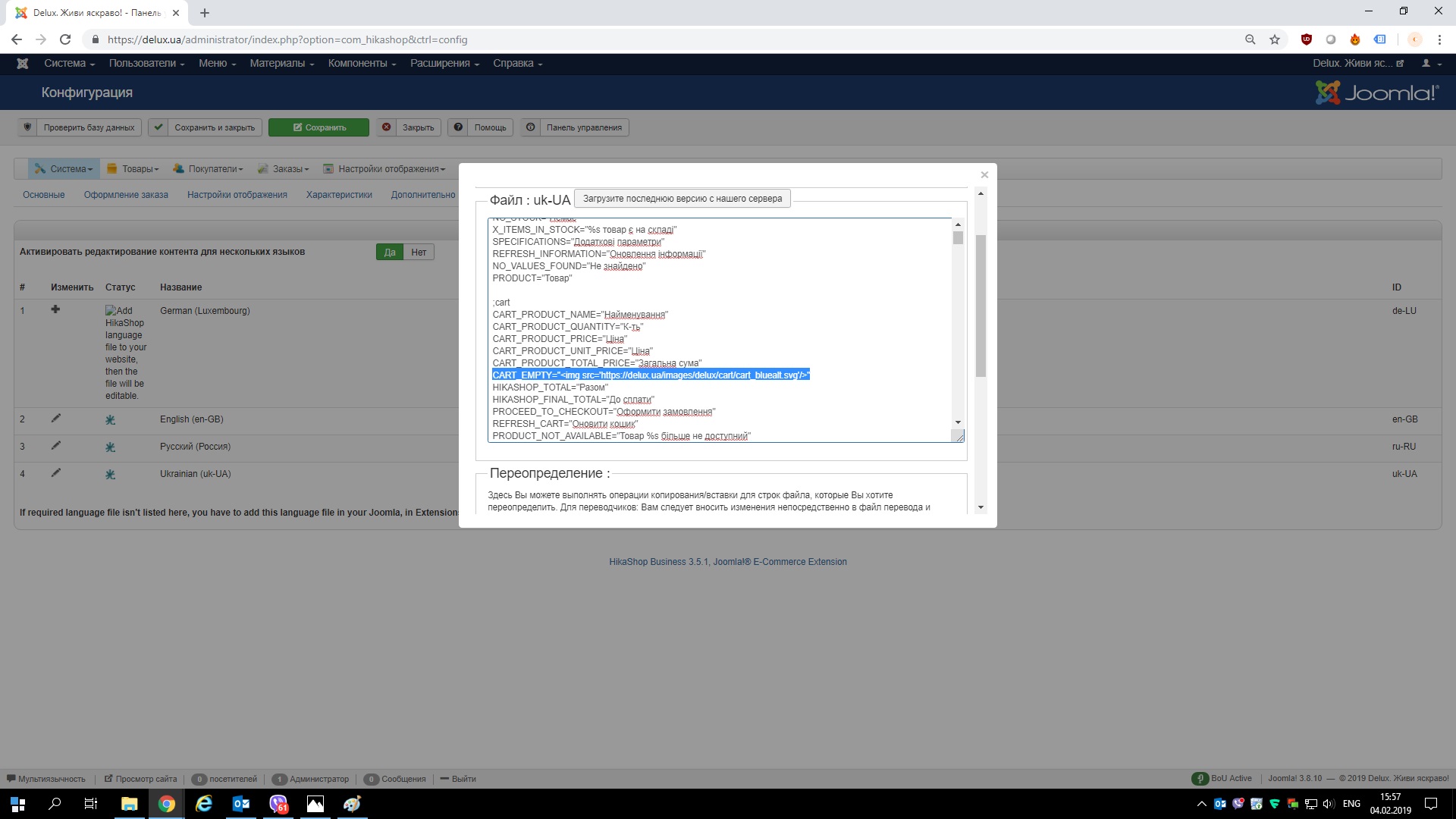

1. Supposing that you want the icon to display the details of the cart when someone click on it, you want to enable the HikaShop cart module in the position of your template where you want the cart icon to display.
Then, you want to set the "mini cart" setting of the module to "dropdown cart".
And finally, you want to do a translation override in order to change the different texts displayed by the cart module 'mini' mode to display instead an image:
So for example, for the "The cart is empty" message that you see when there is nothing in the cart.
You can add such translation override:
CART_EMPTY="<img src='http://mywebsite.com/link/to/empty/cart/image.png'/>"
That's it. There is no need for CSS or for PHP in view overrides.

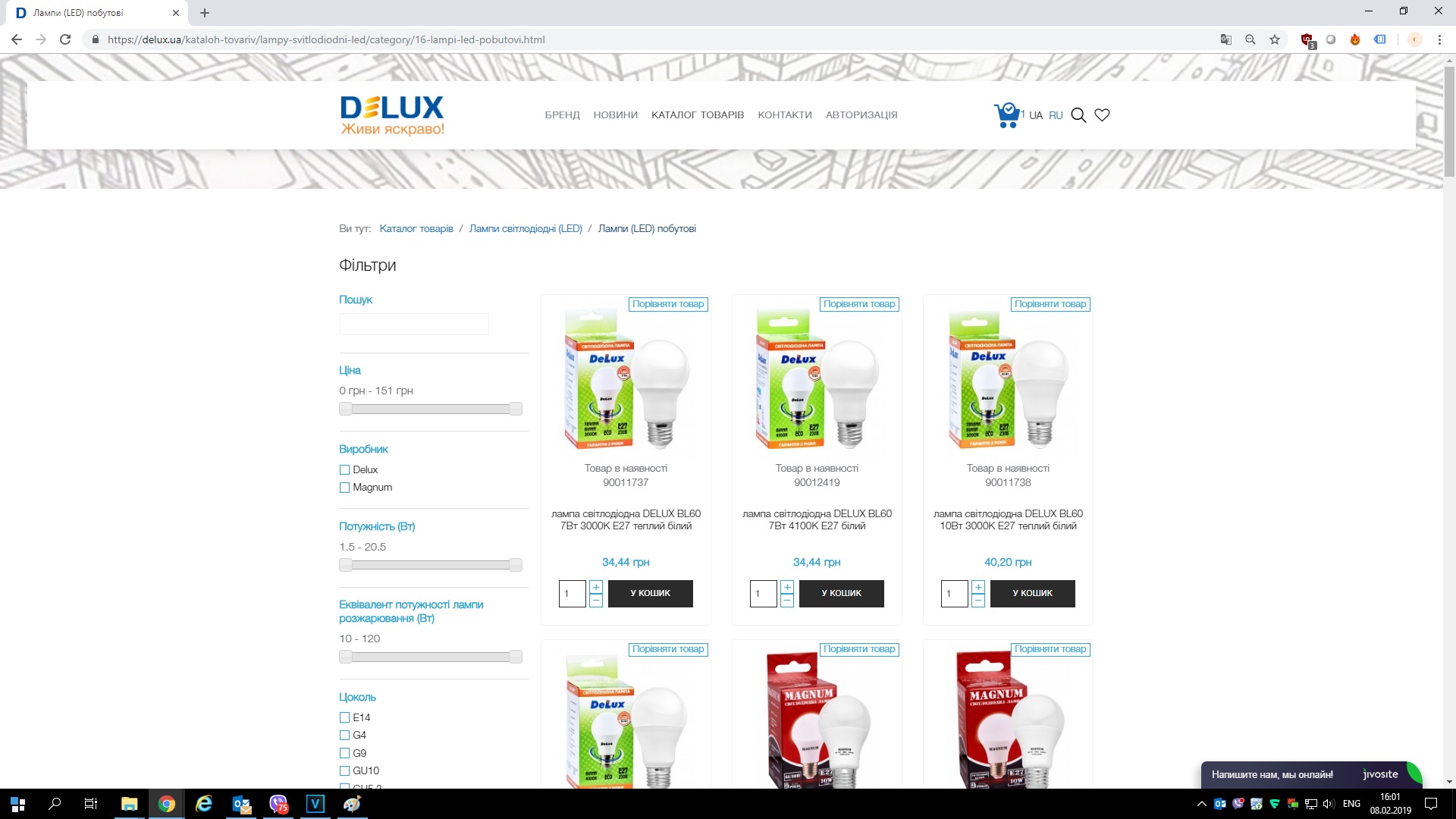

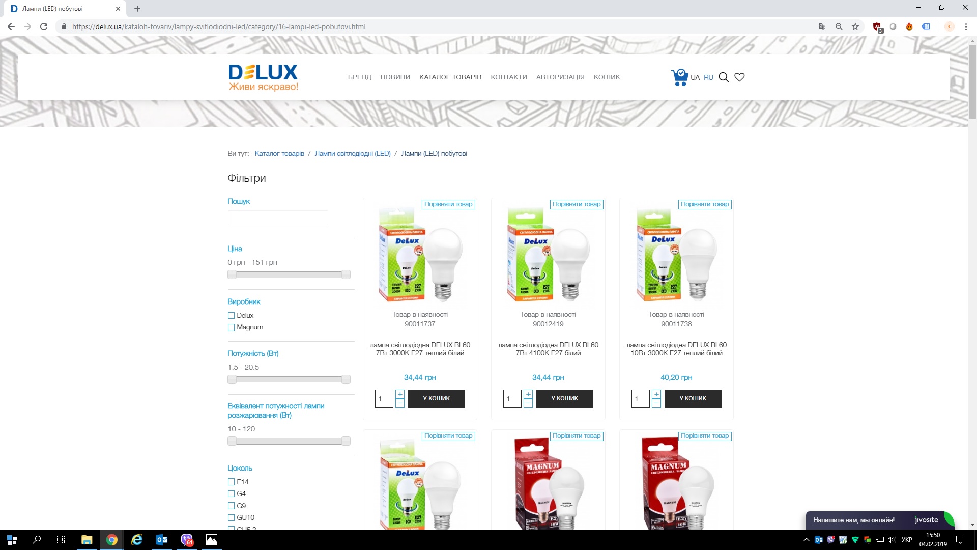

Thank you for your prompt answer. So I tried to do as you advised with "CART_EMPTY" state and it worked, it did display my image.
Now how can I make that when a customer adds an item to cart the image responsively shows, the quantity of items in the cart? What other translation lines should I override? I tried different overrides of the lines"X_ITEM", "X_ITEMS", as was noted in some previous topics, so that the text "X products for X UAH", when the cart is full, changes to image like with "CART_EMPTY" and shows the quantity of items.
However nothing seems to have worked.

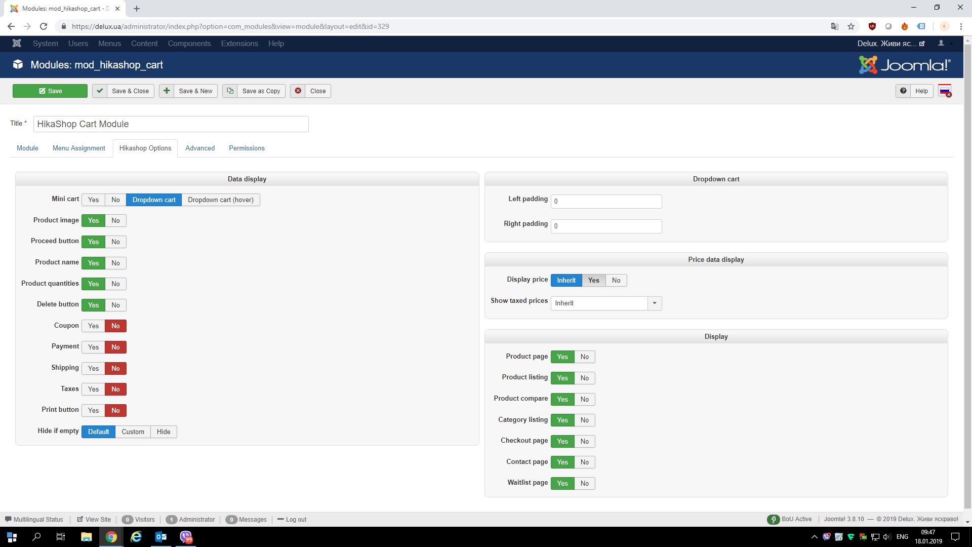

Ok I will try to do what you advise. The problem is I don't exactly know which line responds for what. As I mentioned earlier X_ITEM_FOR_X and X_ITEMS_FOR_X haven't worked out for me. Now, just in case here is a screenshot of the module settings. I like these settings a lot, they are convenient for user, the only thing that's incovinient is displaying this module as image.

  • Posts: 86095
  • Thank you received: 14199
7 years 7 months ago #302737
No, earlier, you talked about the translation keys "X_ITEM" and "X_ITEMS", and not the translation keys X_ITEM_FOR_X and X_ITEMS_FOR_X that I was talking about in my message.
So from what I understand you didn't change the correct translation keys and that's why it didn't work.
Please double check.

This kind of worked. I hope to proceed with adding the right position for my template. Unfortunately position menu doesn't work for this module, and I can't find the exact right position of languages module in my template php layout file in order to make a similar 1 for cart. I hope our IT department can help with that.

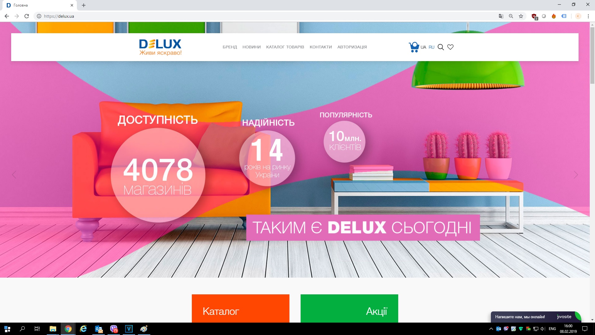

We decided to stop on using a slightly different image for empty cart for now/ It is more fitting and much more good looking than displaying the text. Thanks again for providing all the necessary hints that helped us to come up with the best suitable decision!
