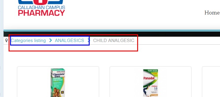

Here's a picture of the b/c when the menu works;

thanks for that. I had it set to 'div' but went to a different computer and it showed as 'list'. Strange. Fixed now! Much appreciated.
With that same menu path I don't want 'product listing' to show up in the breadcrumbs. It doesn't happen if I go to 'child analgesics' but does if I choose 'Adult analgesics'. Is there something I can do to only have 'categories listing' show up in the breadcrumbs?
Ian and Stu

7 years 3 months ago #306743
I think that it's because of the "canonical URL" that you have in your categories. The alias of the menu items in them are not the same. One point to the menu item "hikashop-menu-for-categories-listing" and one point to the menu item "hikashop-menu-for-products-listing" which is a child of the menu item "hikashop-menu-for-categories-listing".
So you need to modify the canonical URL of the category where you don't want the sub menu item to point to the main menu only.
Also, note that this "categories listing" is the name of the menu item. You can modify it if you edit the corresponding menu item via the Joomla menu manager.
