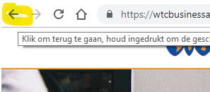

I know it is bad practice, but some users do use the back-button in the browser.

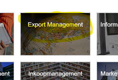

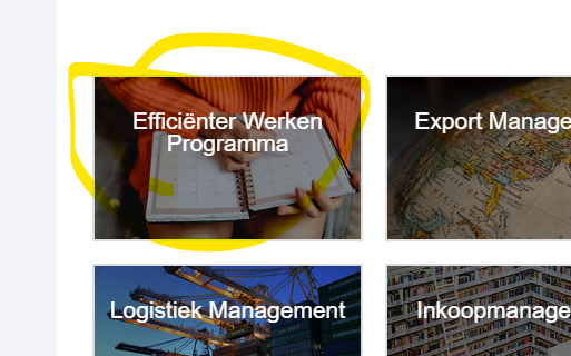

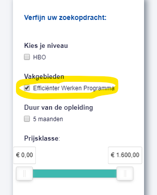

In Google Chrome there is a strange behaviour when using the back-button and filters. Google Chrome remembers the first filter when you use the back-button in the product list and then use another filter. In Firefox the behaviour is as expected: the first filter is deleted.
See the screen-shots.

Thank fot the effort, but still not the solution. Ik can see the 'filtered=1' parameter in the URL, but after hitting the back-button and clicking on another filter on the Hikashop Filter Module the previous filter is still checked.
