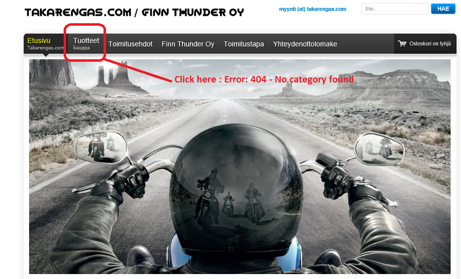

After update 4.1.0 products disappeared.
Is there an idea how to fix it ?
See attachments,

I'm able to see the products on your website: monosnap.com/file/RKDmWWCLzKIrcvu6JDDfYYTleLCw0q
The only place I see a problem is if I access the shop menu item at the top of your website:
monosnap.com/file/2t0ZOjnq4VOxphda8S7EF1JdcVEYkA
So I suppose you're talking about that. I'm not sure why you would have that problem. It looks like an issue with how that menu item is setup. Could you provide a screenshot of the settings of that menu item ? Could you try deleting it and recreating it ?

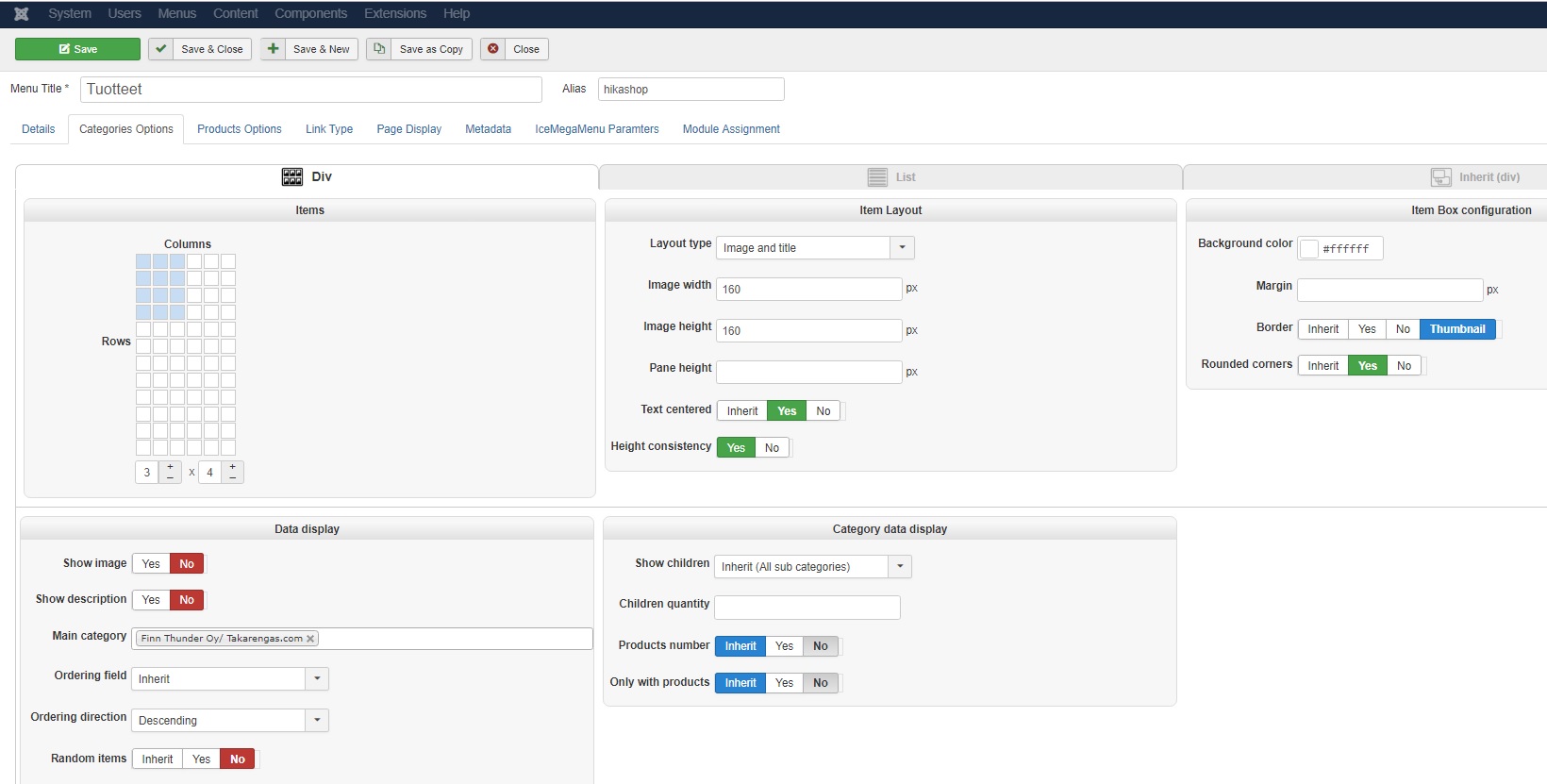

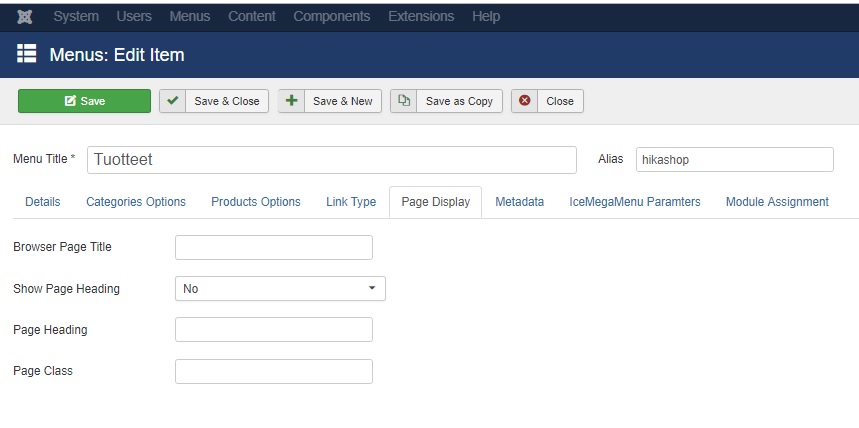

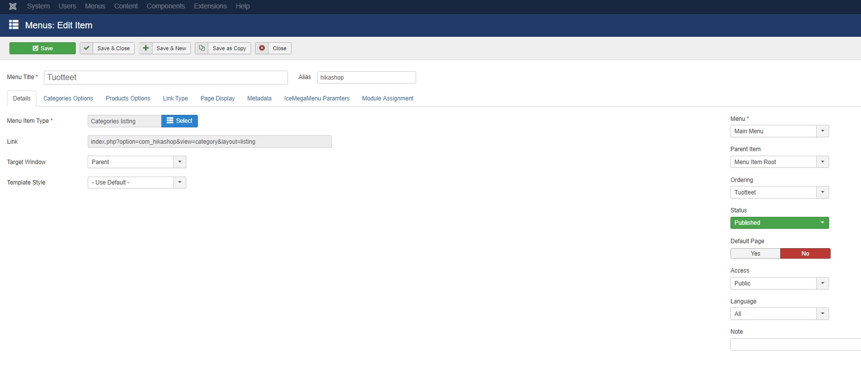

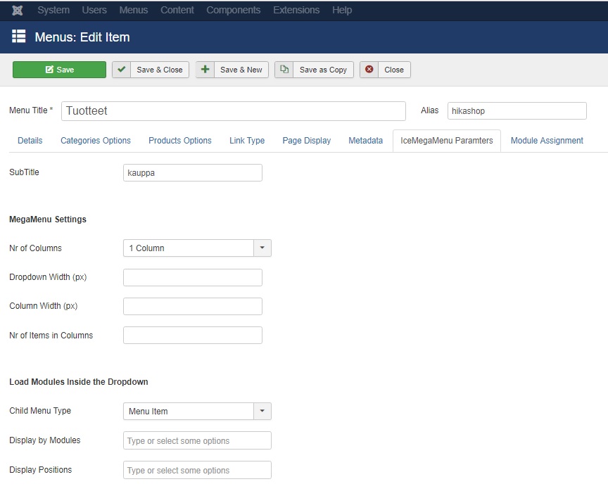

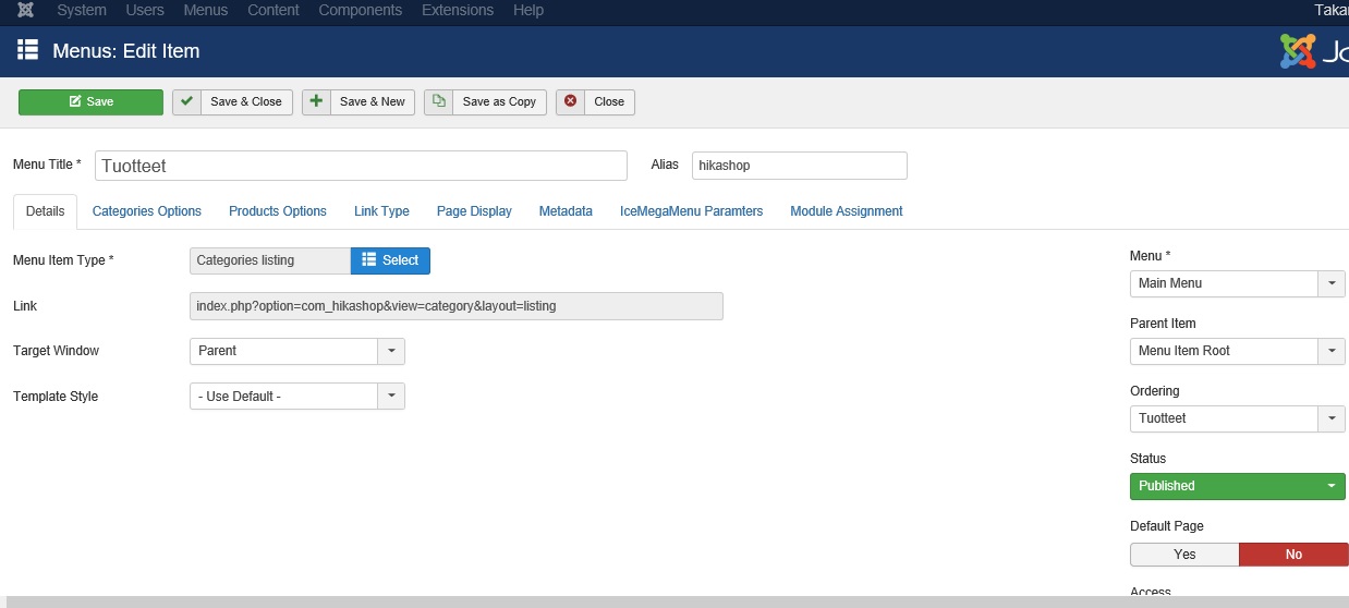

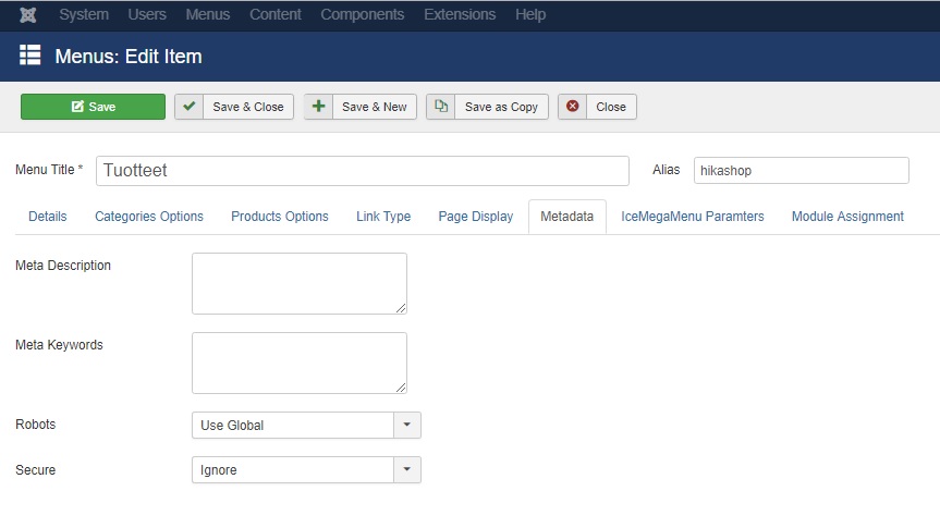

  • Posts: 68
7 years 2 months ago #307971

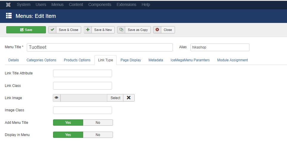

Yes many time I tried deleted it and recreating it. The problem came with the update, no changes have been made.
See attachments of the settings.
Best regards,
-Thunder-

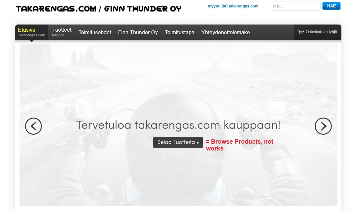

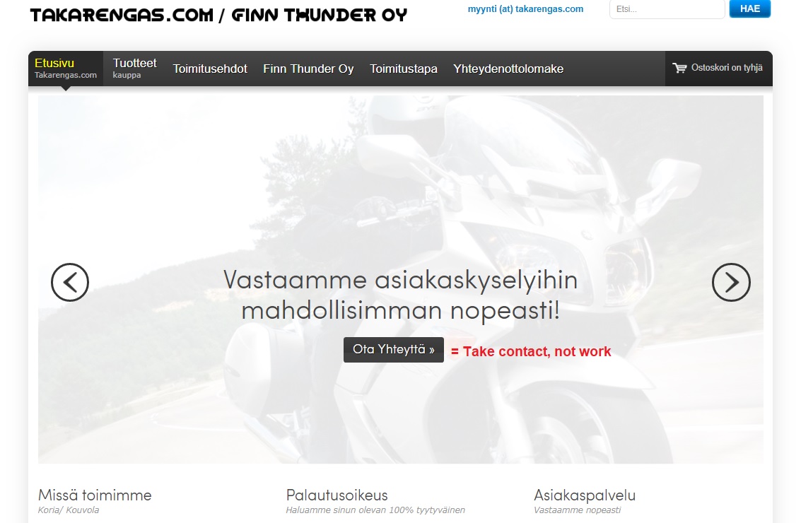

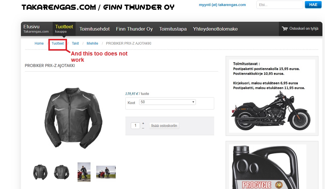

  • Posts: 68
7 years 2 months ago #307973
Everything is related to the products, except take contact button. Take contact button does not open a contact form.
See more attachments and test our side.
Best regards,
-Thunder-
  • Posts: 86095
  • Thank you received: 14199
7 years 2 months ago #307972
Can you check that this category "Finn Thunder Oy/ takarengas.com" is published via the Products>Categories menu of HikaShop ?
Also, since the release of the 4.1.0, we've added some hot fix so that you can still have menu items on categories that are unpublished. So I would recommend to download the HikaShop install package available in the menu My account>My susbcriptions on our website and install it on yours to get the hot fix. That should hopefully help.

  • Posts: 86095
7 years 2 months ago #308088
To me, this looks like a problem with the "tuotteet" menu item.
I'm not sure how that menu item is configured though.
You could try deleting it and recreating a menu item of the type HikaShop category/products listing configured to display your categories/products.
If that doesn't help, then yes, we would need a backend access in order to check your settings.
In that case, you can send the credentials along with a link to this thread via our contact form:

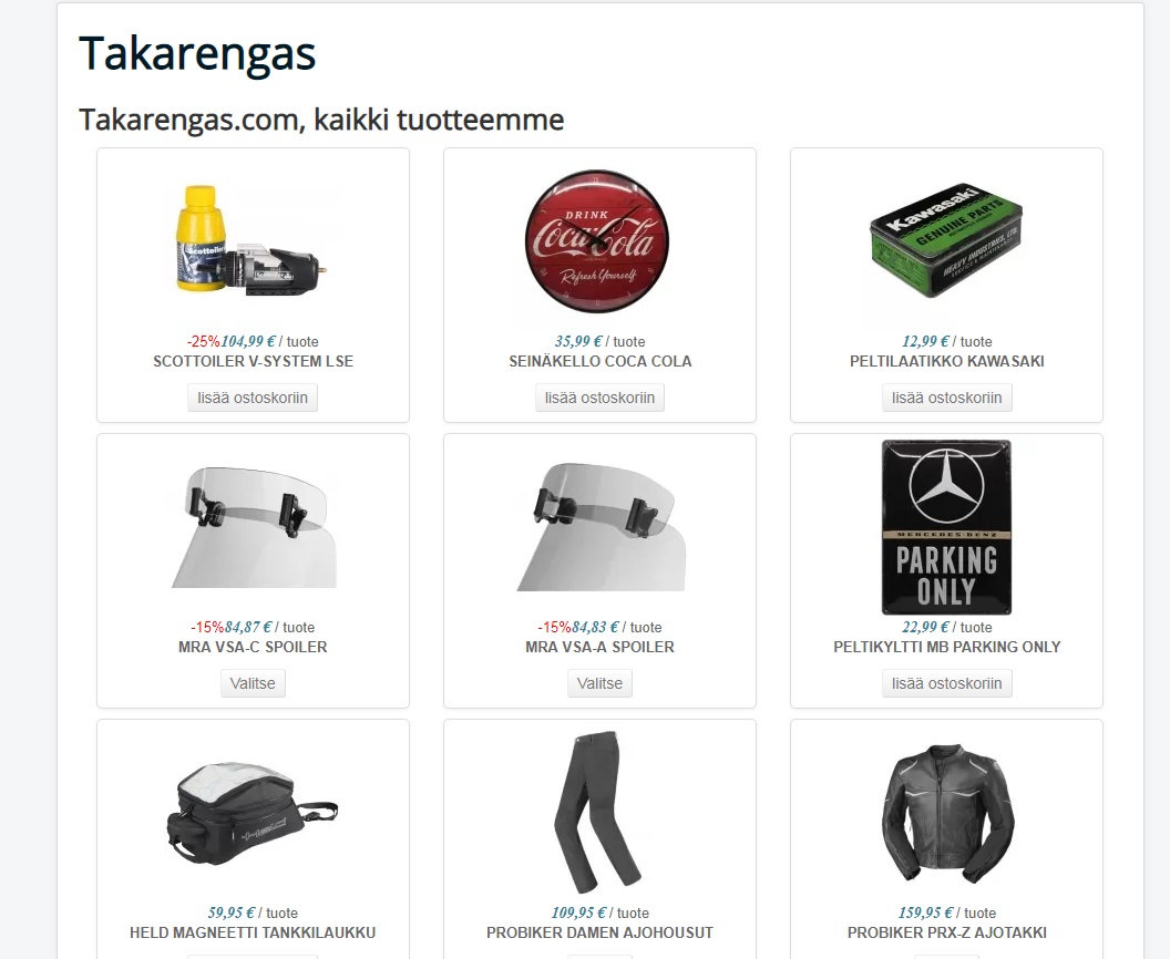

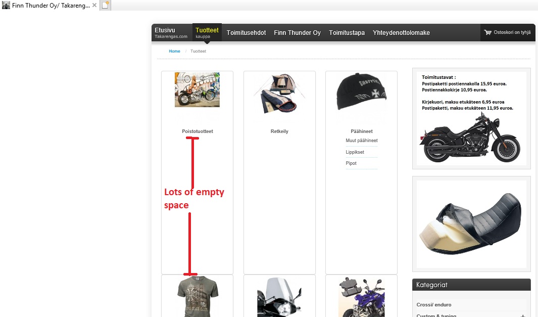

  • Posts: 68
7 years 2 months ago #308172
Thank you, now error went away, but everything is messed up and looks strange ( When click main menu Tuotteet/ Kauppa = Product/ Shop ).
Categories and products are at sixes and sevens (product, category, product, category etc). When you browse the pages you will notice that ( breadcrumb 1- 14 ).
Lower front page you can see all products and they are allright.
How to get the products off and would only see categories when click main menu Tuotteet/ Kauppa = Product/ Shop. No at sixes and sevens.
Or
See all the products when click main menu Tuotteet/ Kauppa = Product/ Shop. That was the way before the update.
Or
Something sensible.
Best regards,
-Thunder-
  • Posts: 86095
7 years 2 months ago #308174
I don't see why the update would change that.
This just means that you have the "sub element filter" setting under the "Products options" tab of your menu item set to "all sub elements" instead of "direct sub elements".
Change that and it should display like you want.
Or, you could also change the type of the menu item to a products listing instead of a categories listing. In that case, you would leave the "sub element filter" setting to "all sub elements" in order to get all the products.

  • Posts: 68
7 years 2 months ago #308224
Sorry, I wrote unclearly..
Lots of empty space. Check the attachment and test our web site.
Best regards,
-Thunder-

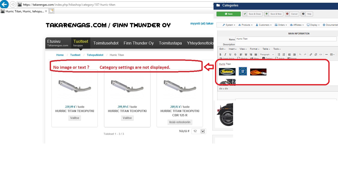

  • Posts: 68
7 years 2 months ago #308236

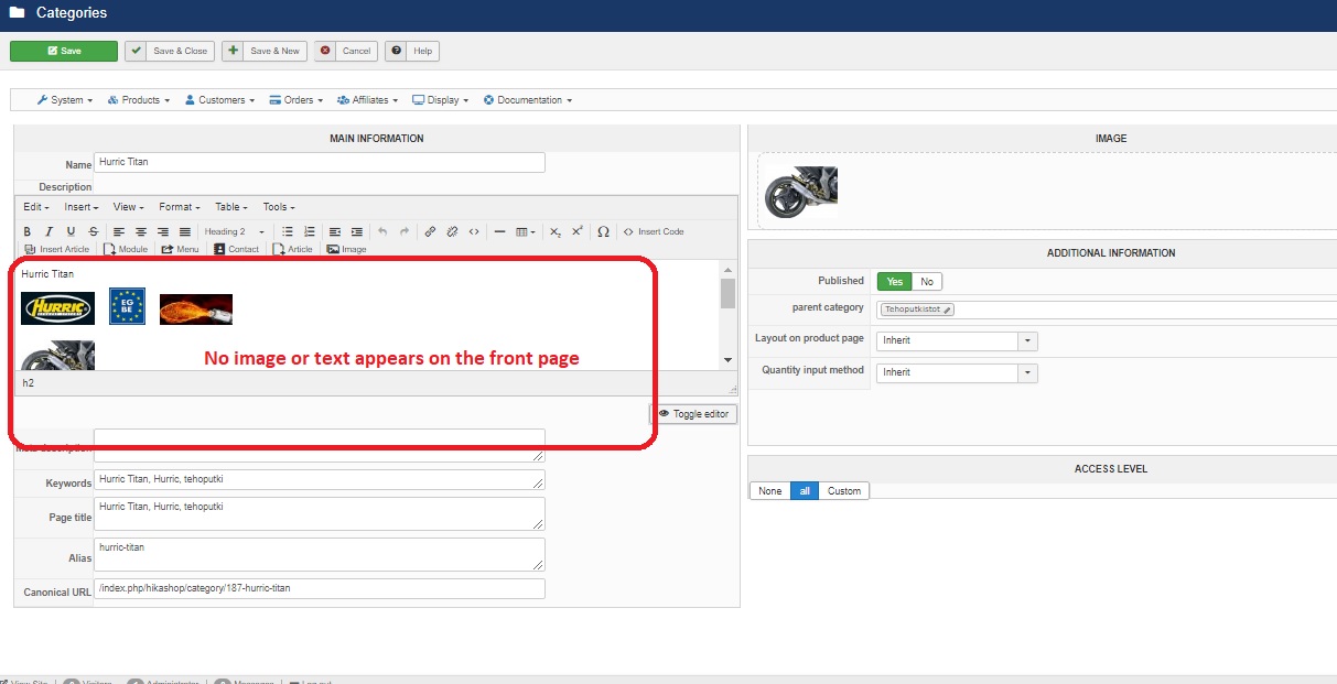

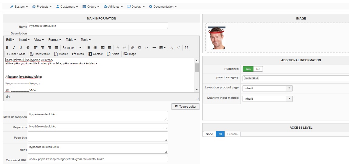

  • Posts: 68
7 years 2 months ago #308241
Probably the same problem.. Categories settings are not displayed on the front page. Texts and pictures.
See attachments.
Best regards,
-Thunder-
