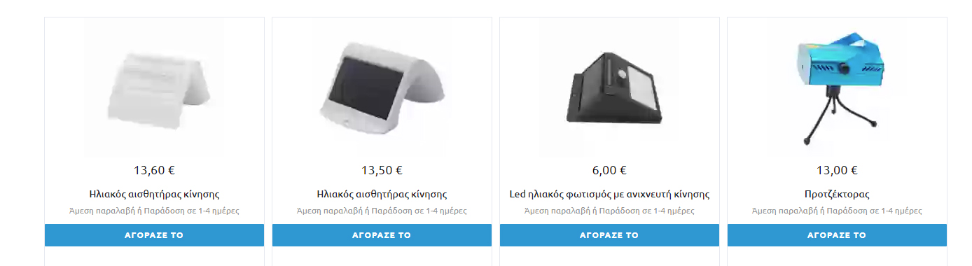

The product images are blurry except from the popup mode.
Why is this happening?
Thank you

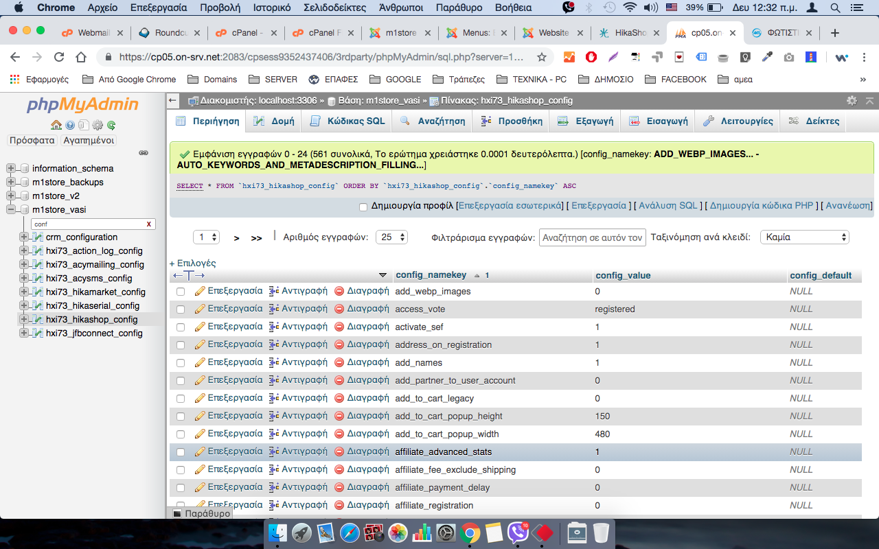

6 years 11 months ago #308561

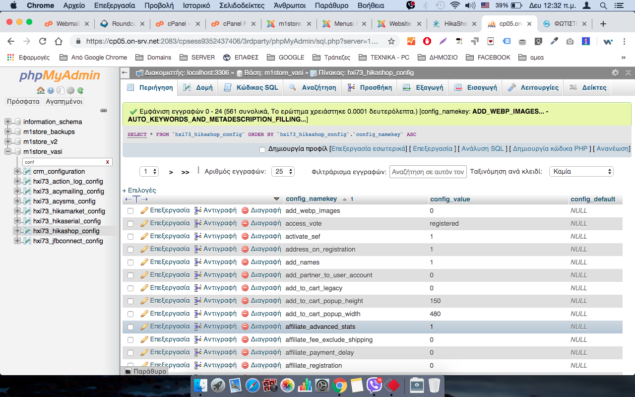

i added the entry but nothing changed nicolas!
  • Posts: 85830
  • Thank you received: 14092
6 years 11 months ago #308563
Then you must have made a mistake when added the entry to the hikashop_config. Please double check.
  • Posts: 1170
  • Thank you received: 13
6 years 11 months ago #308652
I checked it .. see
  • Posts: 85830
6 years 11 months ago #308662
Make sure you don't have any extra space after the namekey or the value. I don't see why it wouldn't work for you while it does for everyone else we gave the same solution.

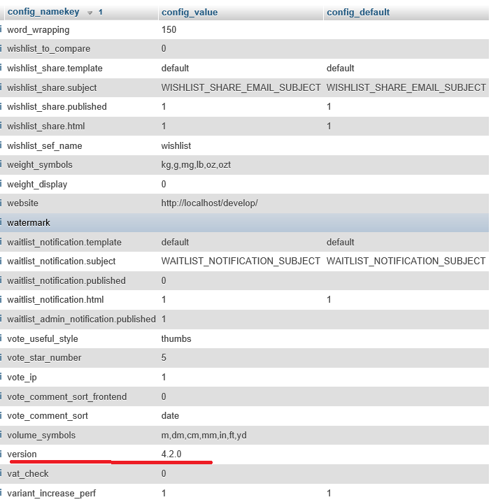

Note that HikaShop 4.2.0 has been released on Friday last week. So you can update and change the quality of the webp images with the namekey webp_image_quality and the value 100 in the hikashop_config table.
You'll have to delete the thumbnails folders after that so that the webp thumbnails can be regenerated with the quality you want.

Is there a reason i have no such namekey? I have looked like 5 times manually, did search and new namekey "no_js_header" i could find easy but not " webp_image_quality"
  • Posts: 85830
6 years 11 months ago #308832
It's normal you don't have it. That's why I said that you need to add it and not to change it.
With most new options we add to HikaShop, we don't add the corresponding entry in hikashop_config during the installation, especially for options without a proper setting in the interface.

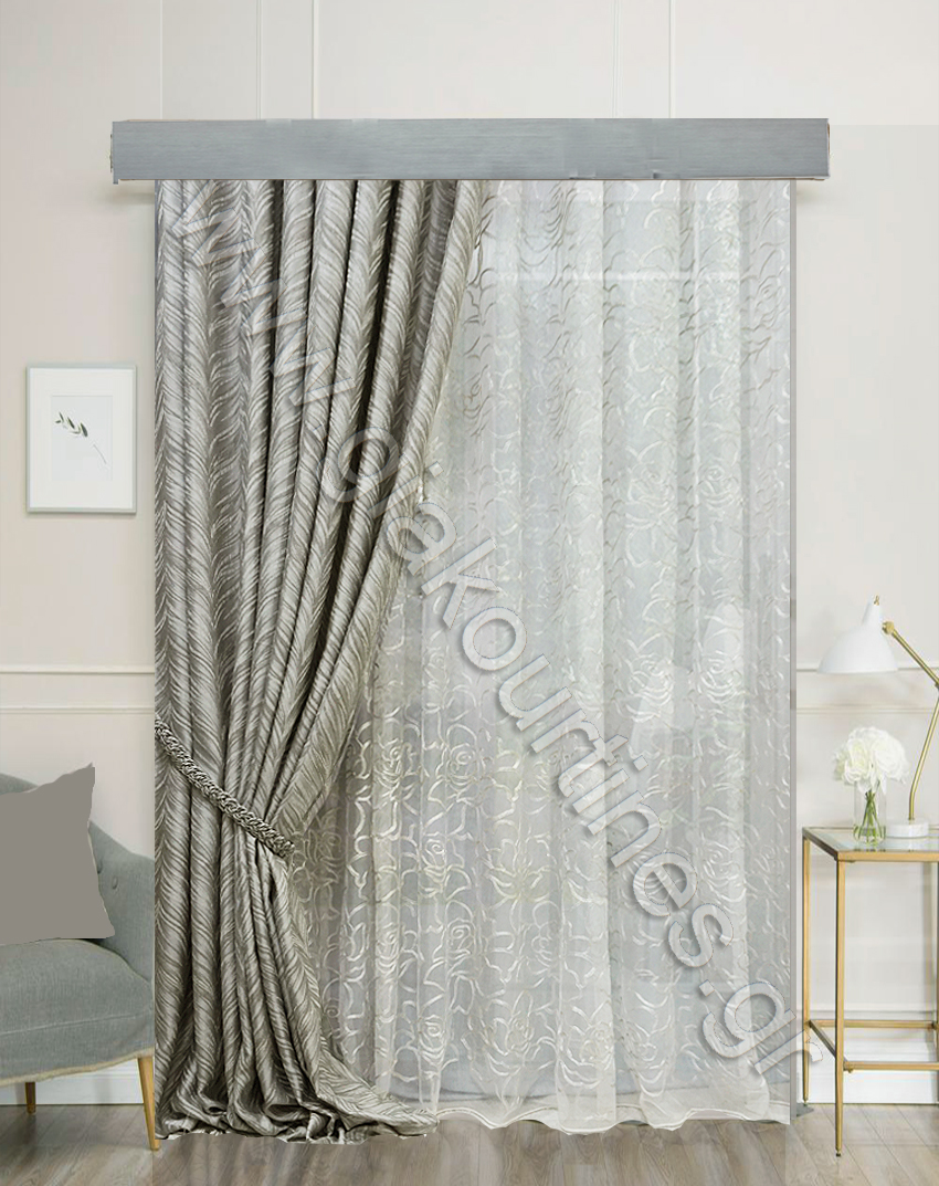

i have the same problem with my thumbnails. They are blur. I dont understand why. I have attached
the quality and the size of the images that i am using and also here you can see how blur they are -> https://www.giakourtines.gr/kourtines/kourtinesramenes
I hope that there is an easy solution....
Thank you in advance
  • Posts: 85830
6 years 10 months ago #310294
I personnally don't see that the thumbnail of that image is particularily blury on your link.
The thumbnail is smaller and a bit compressed, so of course there is a bit less details to it. But it looks quite reasonnable to me.
