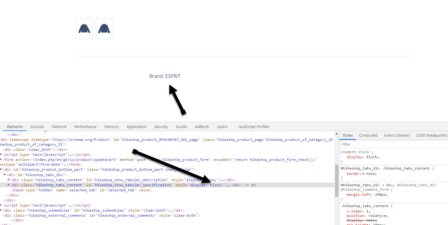

  • Posts: 161
  • Thank you received: 8
6 years 11 months ago #309420
Here is the image they sent me.
  • Posts: 85830
  • Thank you received: 14092
6 years 11 months ago #309428
Well, from what I can understand it should come from the file templates/YOUR_TEMPLATE/html/com_hikashop/product/show_tabular.php which modifies the tabs system incorrectly.
What you can do is to add such CSS on your website to prevent that:
#hikashop_show_tabular_specification{ display:block !important; }

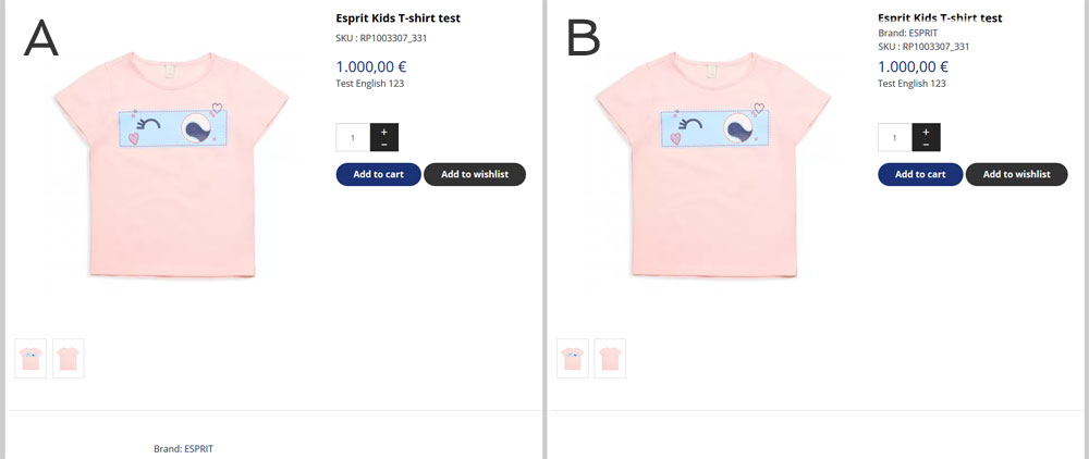

  • Posts: 161
6 years 11 months ago #309472
For info an example is HERE
I have attached a screenshot.
'A' is the current view with the Brand at the bottom of the page.
'B' is how I would like it to look with the brand just above the SKU.
Thanks.
Colin.
