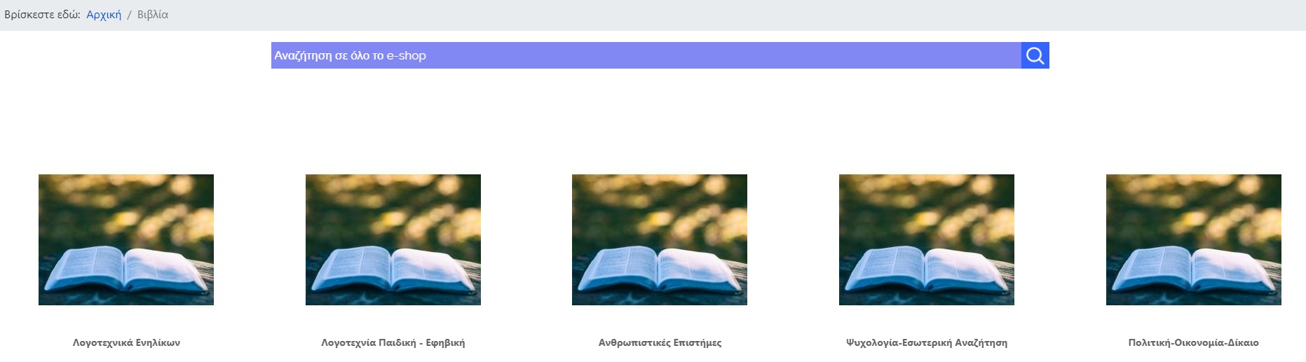

  • Posts: 150
  • Thank you received: 11
6 years 11 months ago #311559
I navigate via the hyper menu, clicked on the first item in the main menu, redirect on the categories listings.
What I did wrong ?
Thank you in advance.
