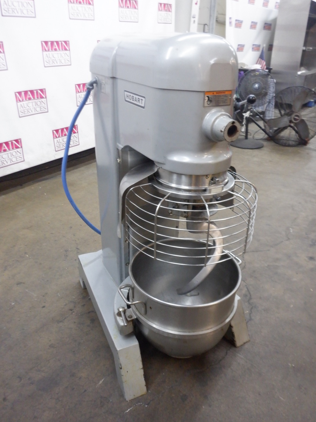

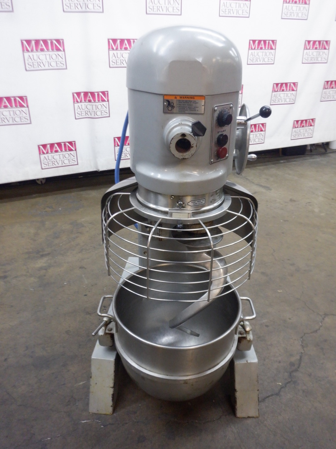

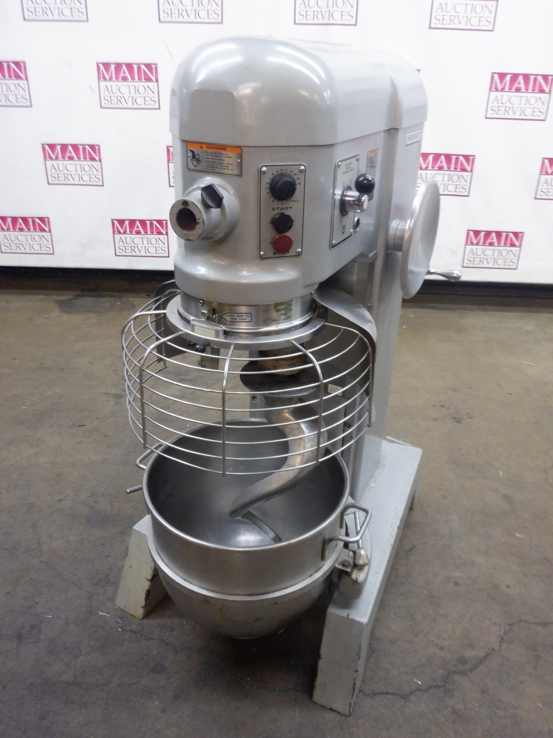

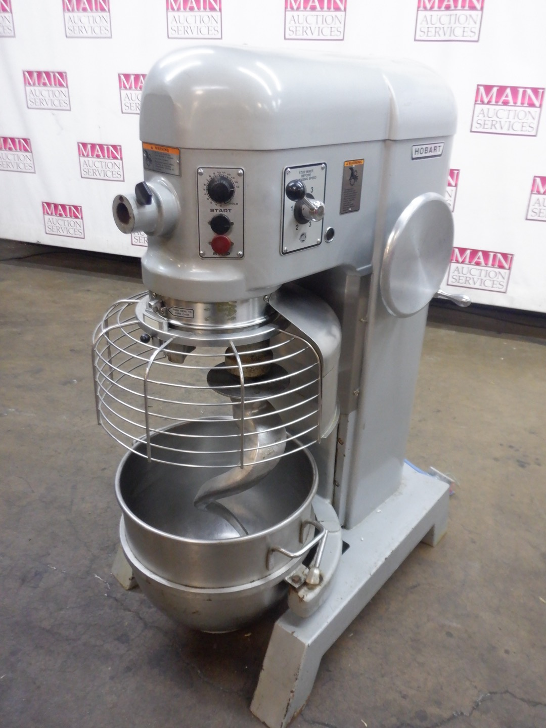

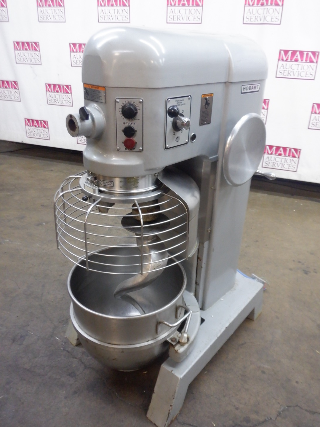

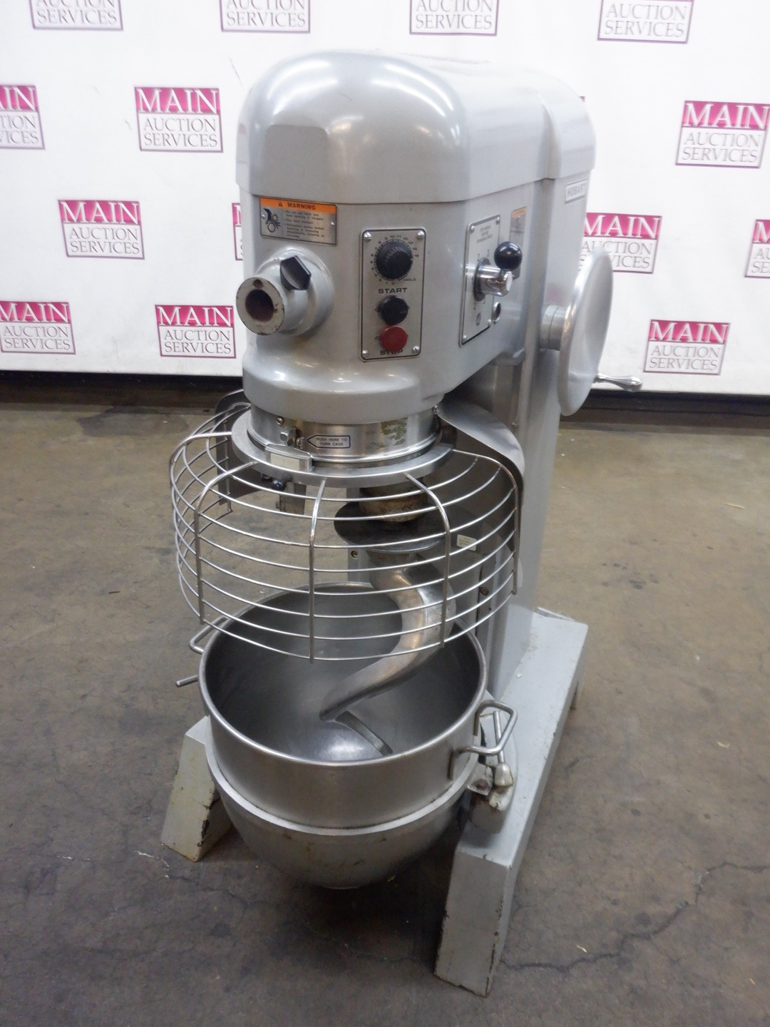

Our customer has started using her iPhone for product photography - however once she downloads the JPG files to Windows and then uploads them to Hikashop, the images are not rotated in accordance with the Orientation settings stored in the EXIF data.
Release notes for Hikashop 3.3.0 state "We now auto rotate the images during the upload when the EXIF data of the image specifies an orientation." Is this still working correctly?
I have also read that JCE occasionally has issues with this. Could JCE be interfering with a Hikashop image upload?
I work on a Mac, so it would be an easy matter for me to strip the Orientation setting, or even use preview to export a properly rotated image before uploading. But I have no idea of a simple way to do that on a Windows machine. without software they don't have or time they don't want to spend.

All I have is a few sample images she provide to me. I can see the exif settings within the files using Preview, and when I export the file from Preview, the new exported file has no Orientation setting and imports properly.

I downloaded all 4 images and uploaded them in a product on my end and they got the proper orientation in all the places I could check in HikaShop.
Could it be that you have an old version of HikaShop on that website and thus it doesn't have the patch for the auto rotation based on the exif data ?
Or could it be that the exif data is missing in these images ?
I checked the exif data in the files you provided and it seems to be missing :

I can't get the Exif data from the images I uploaded here either. But it's definitely in the files I received from the customer.
Here's what I've found out. First, there was a server issue. Our CPanel configuration for this server did not have the EXIF build extension active in PHP. Once we turned that on, images would rotate properly. I suspect we never saw this before because our background is in printing, so no photo goes through our internal workflow without being sized appropriately out of habit.
Now that PHP sees the Exif data, images are rotated, but these particular files now fail during upload. (We see the red progress bar when we attempt it) We think this is due to the file sizes. Our server is set up to accept large file uploads, but uploading these (which are about 3400px x 4600 px) seems to overwhelm Hikashop's resizing routine IF the file needs to be rotated as well as resized. The sample files they gave us that don't need to be rotated are uploaded and resized correctly. Smaller files upload properly as well.
