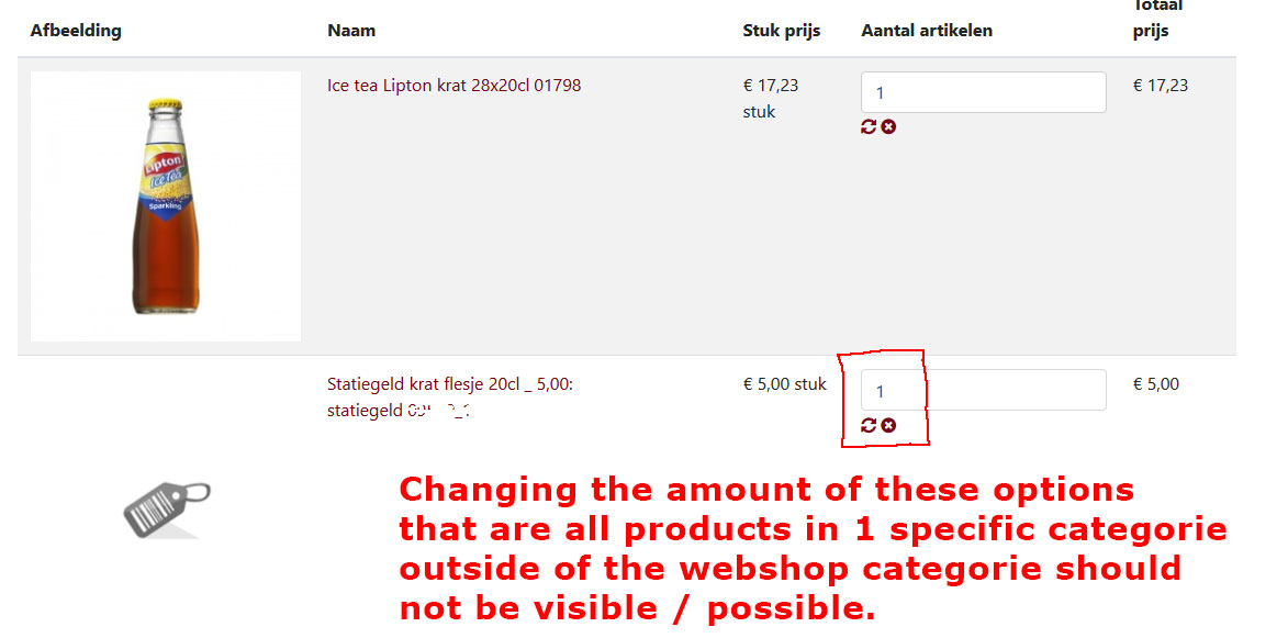

We have a situation where we use option products that are automatically loaded when a customer buys a product.
When the customer buys 2 products, the optional product is also increased to 2.
This is all working fine.
The issue arrises when the customer is changing the amount of the option product to a lower value then the product. This is not allowed.
I can understand it's difficult to enforce that so we are exploring the options to have a little work-around to make it more difficult for the customer to change this value.
Would it be possible to make changes to the cart and wishlist view so the fields to change the amount are hidden/disabled for all products from a certain parent categorie? This because all the option products are in 1 parent categorie.
Thanks for any tips on this !

5 years 10 months ago #312053
Hello Mohamed,
I hope this explains it well enough :

  • Posts: 305
  • Thank you received: 22
5 years 10 months ago #312088
Thanks for this Nicolas.
What I can see now is that on the checkout the field of the product is not editable, this should beon the option product.
And if we get this switched, is this also applicable to the cart view?
Thank you very much for helping with this creative solution :)
