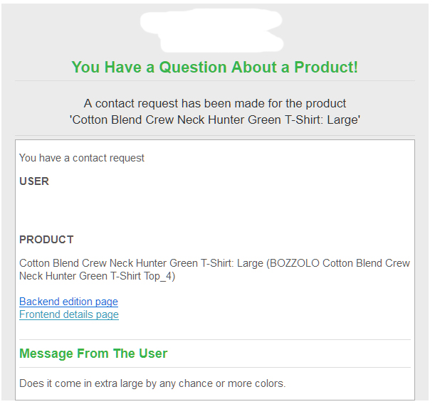

5 years 11 months ago #323939
So the issue is coming up when the following happens.
I got a contact request email and when I click to view the product on the Front End, it takes me to the product, if I try to use the search it does not work - it's doing the same thing that I indicated in my initial post.
Thanks!

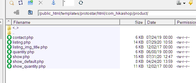

Can you check if you have the file templates/YOUR_TEMPLATE/html/com_hikashop/product/filter.php ?
If you do, try renaming it and it should help. If you don't, we would need a backend and a FTP access to check on the situation further.
  • Posts: 966
  • Thank you received: 11
5 years 11 months ago #323978
I don't have a filter.php. Will send the access info shortly.
