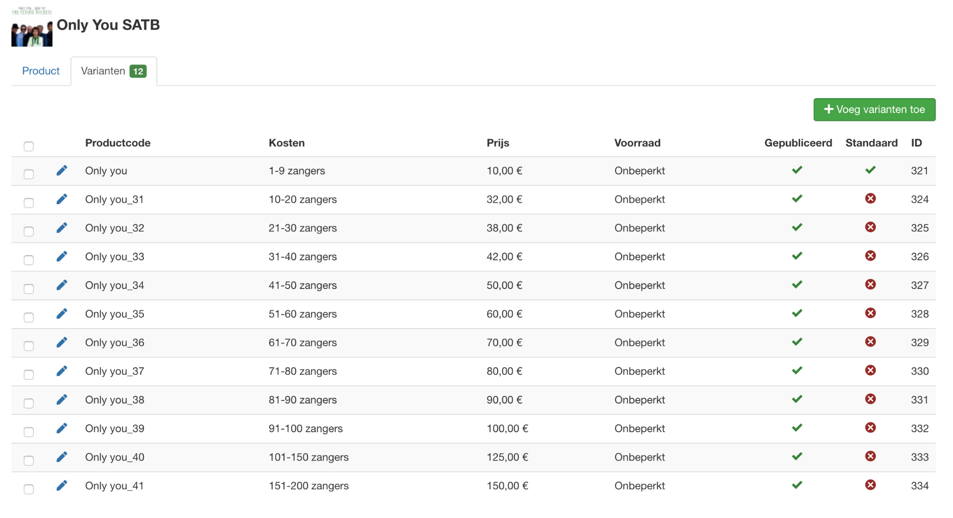

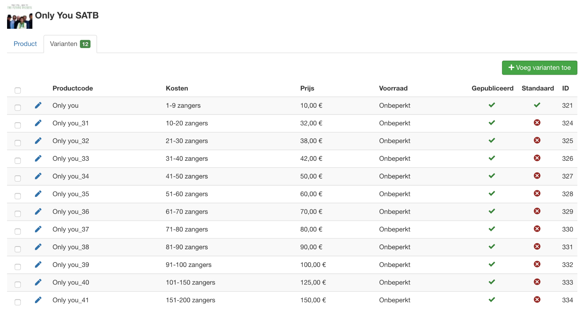

I have to correct myself The translations of the variations are made correct in Characteristics. All variations for all products are the same.
1 - 9 singers
10- 20 singers
21 -30 singers
etc etc total 12 variations.
He already made 350 products and now is seeing that in all other languages the variation is the title of the product and not the amount of singers. That would mean he has to change the name field in 12600 variations. ( 350 x 3 languages x 12 variations.)
It seems that something is going wrong but I can't see what. If I make a new product the variations are translated correctly.
****Edit. The name field of the variation causes the fault ***

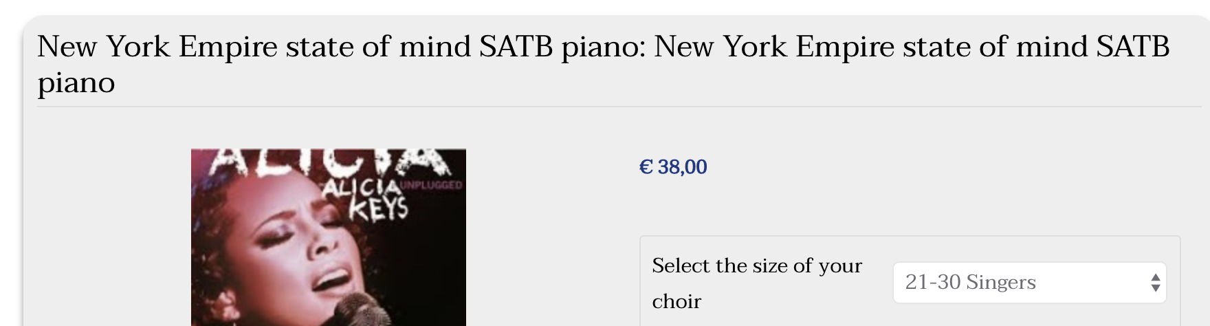

Yes it seems fixed now. We now also notice that if you search for example on "christmas song" in the ajax search you get the meta description instead of the title. This is a product made after the update. If you search on "christmas was" you get the title but then it is also in the characteristics. This product was made before the update.
We only want the title's in the search results.
Now the problem is fixed can you also fix the characteristics in the already made products? I can add you to Plesk.
Kind regards,
Raoul

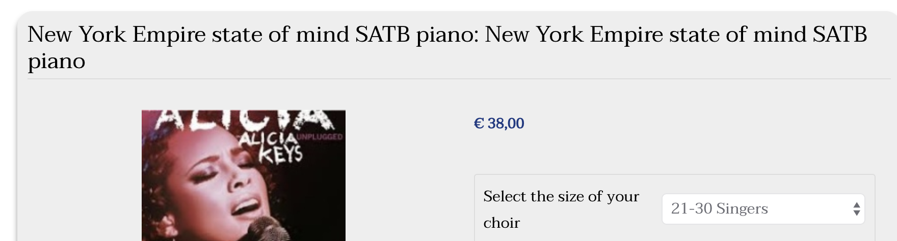

6 years 7 months ago #315281
Hello Mohammed,
For example this product that is made before the update. The Title is now in the Characteristics and can't be removed anymore.
nieuw.jetsebremer.nl/en/component/hikash...e-of-mind-ssaa-piano
This have to be removed in the database but I don't know how to do it.
Kind regards,
Raoul

  • Posts: 86178
  • Thank you received: 14213
6 years 7 months ago #315377
We run the MySQL query on your PHPMyadmin as explained here: www.hikashop.com/support/forum/product-c...nslation.html#314661
The name of the variant is now showing properly on the page nieuw.jetsebremer.nl/en/component/hikash...e-of-mind-ssaa-piano
So it seems to be working fine now.
