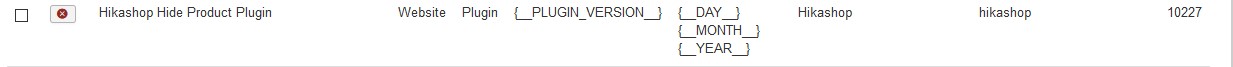

6 years 4 months ago #318356
Grabbed the plugin. will experiment with it tomorrow. Did notice something in extension manager. Looks like there's a problem with displaying the version & release date of it. But i'm a bit confused. When entering the plugin "settings" (yes i know there's nothing to configure)
This is the description, This plugin enables you to hide products which sales date is in the future or past
What do future or past sales have to do with hiding a product from view when it's temporarily not in stock?

6 years 4 months ago #318367
Ah you're right.
For the stock you actually don't need anything.
You just have to turn off the "out of stock" setting of your menu item via the Joomla menu manager and the products won't appear on the listings automatically.

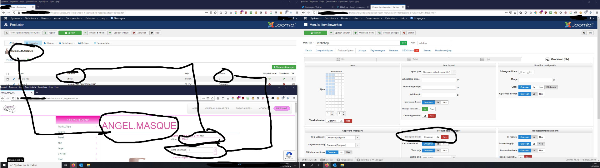

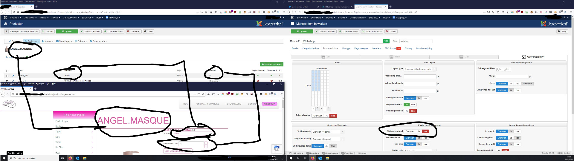

6 years 4 months ago #318461
Pretty sure i'm looking in the right place AND have the right setting set to "no", but maybe it has to do with the fact that they're variants (and that specific one is set to 0) but the main product info is set to "infinite"?
Made a quick image, if it's unclear. The product is "Angel Masque 200ml", your back-end access is still enabled.
Last edit: 6 years 4 months ago by Ch3vr0n.
  • Posts: 86095
  • Thank you received: 14199
6 years 4 months ago #318470
As I said, the stock of the product has to be 0. If it's set to unlimited then the product will display in the listing, regardless of the stock of each variant of the product.
Note that you can configure the stock of the product as the sum of the stock of each variant. That way, when a variant is purchased, both the stock of the variant and of the product will be updated.
