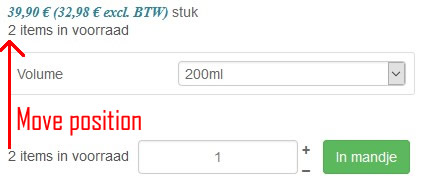

Move "x items in stock"
  • Posts: 259
  • Thank you received: 10
6 years 4 months ago #318412
-- Joomla version -- : 3.9.18
-- PHP version -- : 7.3.17
Can you tell me which view i'd need to edit and where / how to move the position of the X_ITEMS_IN_STOCK line?

That's not easy.
You'll have to remove it from the product / quantity.php view file (I think), and add it to the product / show_default.php (probably).
To know which view files exactly, it's better to activate the "Display view files" setting of the Hikashop configuration and then look at the page. It will tell you which view file displays which area.
The code will probably have to be adapted a bit.

i'll leave things as is then. Was just a question.
