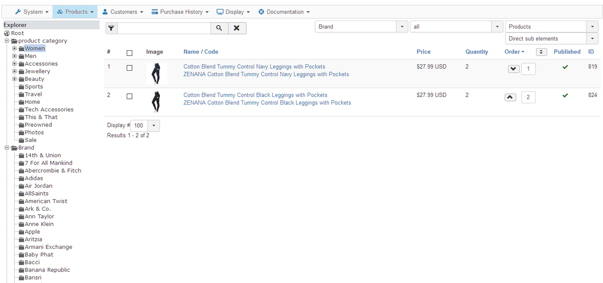

I'm trying to change the order of products in a main category, eg: Women. It says, in order to reorder elements change it to "Direct Sub Elements". When I change it to "Direct Sub Elements" it's only showing me 2 products - all the other products are no longer showing.

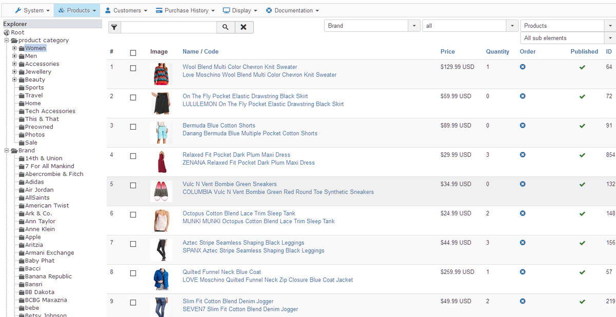

In the backend, under products, when I click on a category, for example: women, as per the screenshot (hikashop-category-women-1.jpg), you will see that there is a lot of products listed and no input field to enter a number to reorder the products.
The Hikashop instructions says that in order to reorder elements change it to "Direct Sub Elements". When I change it to "Direct Sub Elements", as per the 2nd screenshot (hikashop-category-women-2.jpg), the input field is showing but it is only showing 2 products - all the other products are no longer showing.

  • Posts: 85796
  • Thank you received: 14091
5 years 10 months ago #322985
It means that the other products are not directly linked to that category.
The ordering of the products is per category.
So if you have product A linked to category X, you can configure an ordering for that product A in that category X, and if you have that same product X in category Y too, you can also configured an ordering for that product A in that Y category.
So if you want to configure and ordering for each product in the main category of your shop, you should either:
- have all these products linked directly to that main category
- order your listing based on something else, like for example a custom product field, where you could enter the order you would want for your products for that particular listing.
