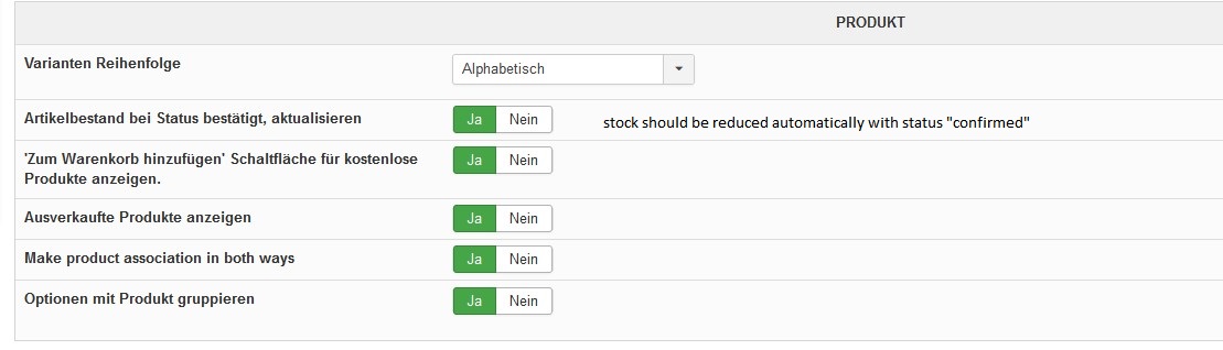

Yes – I am ? I used the 3.5.1 before and everything worked propper. We do sell ticktes for our events every year and they are limited. There haven’t been any problems before. I do have a mirror site which I used for some tests today. And it worked.
Are your orders' status changed to confirmed after the payment ?
All orders' status are „confirmed“ after closing the ordering process. We do not use the order status „open/unpaid“ because our paying procedere is direct debit.
How did you configure the "update stock when order is" setting of the HikaShop configuration ?
--> attachment

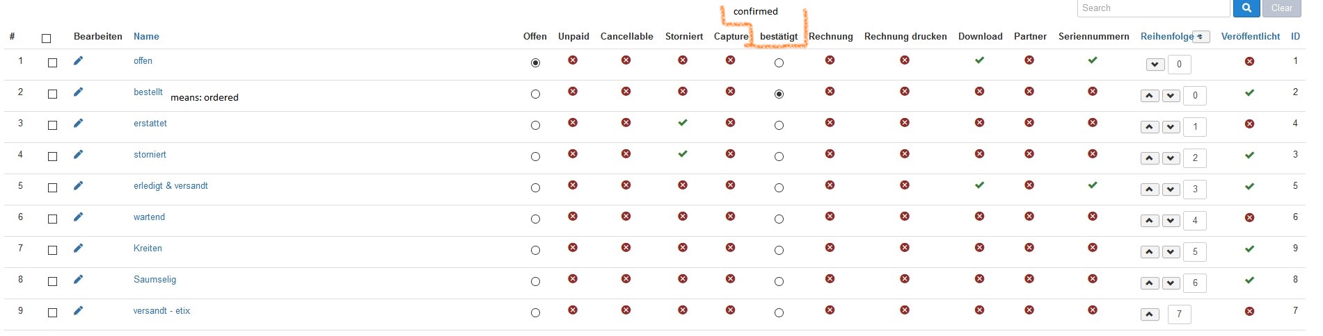

Could you also do a screenshot of the settings under the System>Order statuses menu ?
--> of course, see attached

I don't speak your language, but it seems that "confirmed" isn't enabled under the "invoice" column of the System>Order statuses listing.
If you hover on the title of the "invoice" column, it should tell that this column is used for stock management, and what that means is that when you have the setting "Update the product stock on confirmed status" activated, the stock will be decremented when the order changes status to one of the statuses enabled in that column.
I'm surprised you didn't get the same issue before the update as it's been like that for a long while now. But maybe you have an older version of HikaShop before the update and not the 4.3.0 ?
The following user(s) said Thank You: Frank.Oehlen

:woohoo: :woohoo: :woohoo: Thank you - thank you - thank you - thank you - thank you - thank you - thank you - thank you - thank you!!!!
Nicolas - you made my day!
The "invoice" column was the "problem" and now it works propper again!! THANK YOU!!
