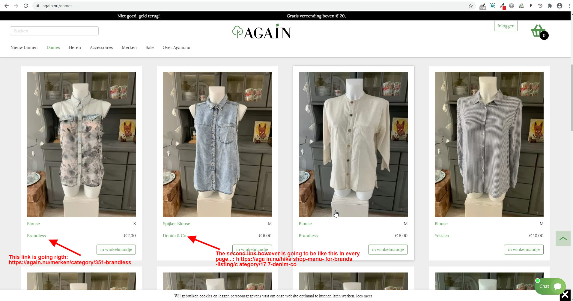

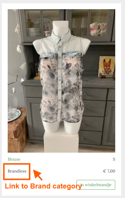

how can we link the brand name in the category veiw to its category page?
On the productpage the brand is already linked... see e.g.: again.nu/nieuw-binnen/product/4356-blouse to brand category again.nu/merken/category/351-brandless
End how to link this in the catergoy view e.g.: again.nu/dames (see attachement)?

Can you details what do expect to link to "brand page", I mean we see 2 possibilities :
1. You have in each product div your brand and so the brand link
OR
2. You have by example, on top of your product listing a little module (or carousel ?) with all your brand ?
From your needs, our answer will be very different, and so awaiting news from you to better answer you.

But in every page with the category view.. the second item is not showing the correct link.. we checked everything but can not figure this out..
See attachment..

You code is fine.
HEre is the way the URL is generated :
- if the "force canonical URLs on listing" setting is activated in your HikaShop configuration, then HikaShop will use the URL that you have configured in the "canonical URL" of the brand.
- If it's not activated, then the URL will be generated dynamically, using the first menu item of the type "category listing" configured to display a brands listing, and if not, another randomly selected menu item of one of the types of HikaShop.
So what you describe probably means that you have the "force canonical URLs on listing" setting activated and that you entered a URL you don't want in there for the second brand there.
An alternative could be to use:
hikashop_completeLink('category&task=listing&cid='.$manufacturer->category_id.'&name='.$manufacturer->alias.'&Itemid=XX')
instead of:
hikashop_contentLink('category&task=listing&cid='.$manufacturer->category_id.'&name='.$manufacturer->alias.'&Itemid='.$Itemid,$manufacturer)
where XX is the id of the menu item you want the link to use (supposing that you don't want a different one for each brand).
That way, you will force the system to generate a URL with the menu item of your choosing. However, if you have a wrong canonical URL in your brands, that wrong URL will still be the one indexed by search engines. So I would rather recommend fixing the canonical URL. It will be better for your SEO too.

We don't use canonical URLs on listing and none was activated, but after a bit of searching through the all fields we noticed that for every second item in a category listing, a canonical URL was generated automaticly while that option is not activated.
So we have used your alternative.. and entered the menu for brands on the XX and now it seems to work fine..
