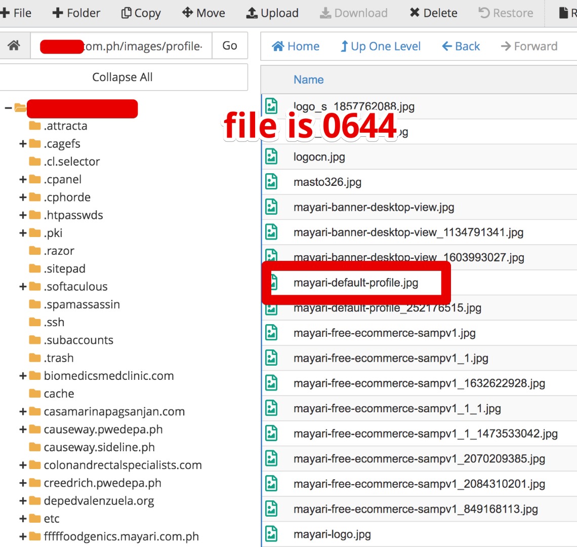

1. i have verified the file and it is in the correct folder with correct permission
2. url is https://.../investor-buyer-dashboard. please register to view this. registration need NO approval
3. i tried to change it with image field type but it is still the same

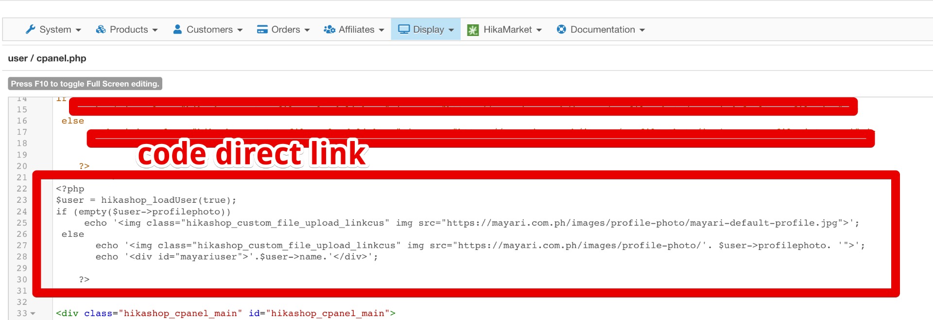

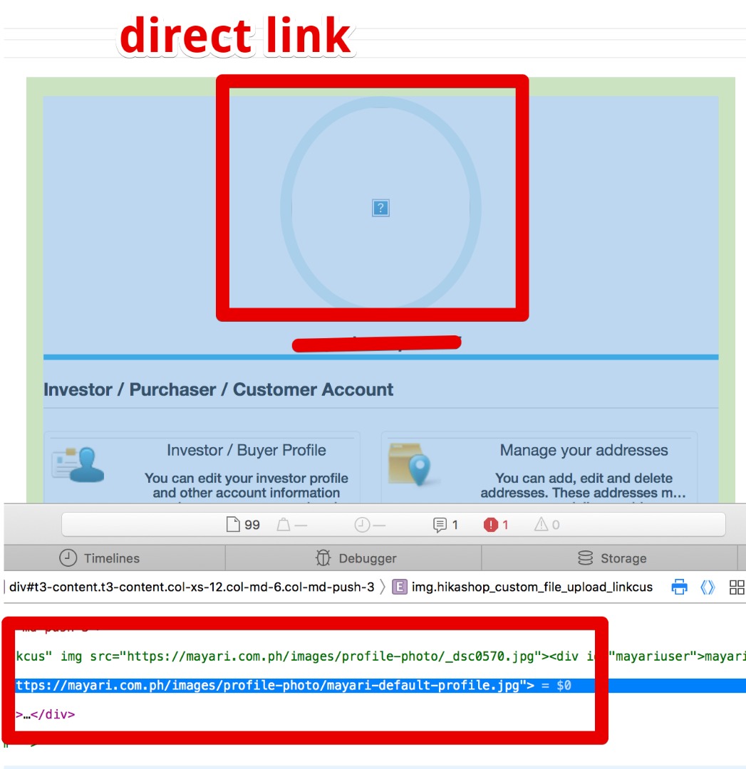

to be sure i have attached another view, user / cpanel.php, that i have customized where in the image is not appearing. in my example i used a direct link but it is still being blocked

If the file mayari-default-profile.jpg is in the folder images/profile-photo/ of your website but when you access it, you get a joomla 404 error ( monosnap.com/file/QHI1cJkO9Wa3kVJqk5ABzr5Whp2bF4 ), this means that the problem is not in HikaShop. Joomla should not be involved when an image is accessed directly by the browser.
The web server should directly reply back with the image.
And if the image is not found, it should display the 404 error of your web server, and not a 404 error of com_content with the message "category not found".
So that indicates a problem with either the configuration of the web server, or with the htaccess you have on your website.
