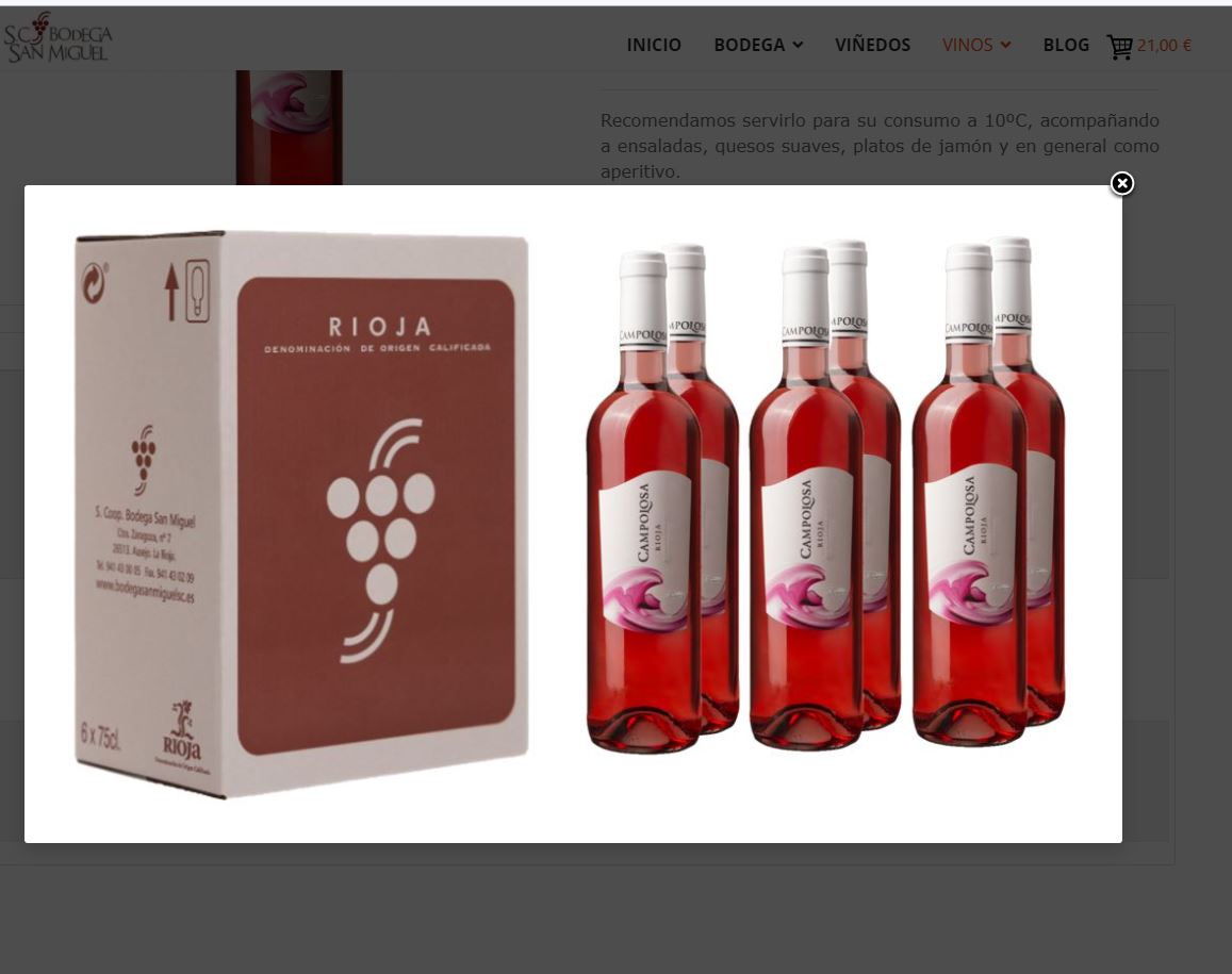

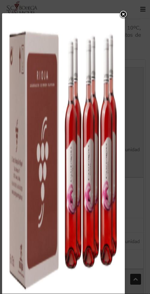

Hi:
I have products with variants and when I click on variants thumbnail in desktop view it show me the correct image wiew (see image 1), but if i use mobile resolution, images do not resize to width screen , they seem to resize to height screen (see image 2). How can I solve it?

5 years 2 months ago #333585
Hi Philip:
I have upload web from my localhost to online (it is still in development), url: bodegasanmiguel.es/index.php/es/tienda-d...polosa-rosado-joven#
When you are in desktop resolution everuthing is ok, but when you change screen to mobile, then if you click in variants product thumnails they loose ratio and fit to heigh screen instead of fitting to width screen.
For mobile, if you click in product image decsription, then this thumnail fits correct to width screeen.
Ricardo
5 years 2 months ago #333587
So far, it seems that the Shadowbox for a reason or another fail to define dynamically your popup size, see my screenshot :
Can you try to use the Swipebox image popup (instead of shadow box) to see if that won't solve your issue ?
Hope this will help you to solve your current issue.
Last edit: 5 years 2 months ago by Philip.

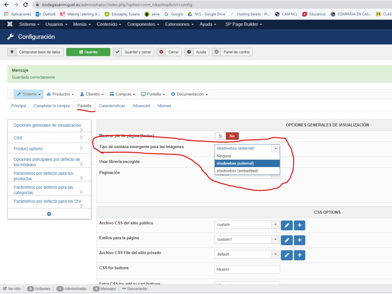

Hi Philip:
Where can I select Swipebox popup type? I don´t see it in my Display configuration (please, see image attached).

5 years 2 months ago #333594
You will find this option, in Main HikaShop configuration page :
- Go to Display tab
- In General display options part

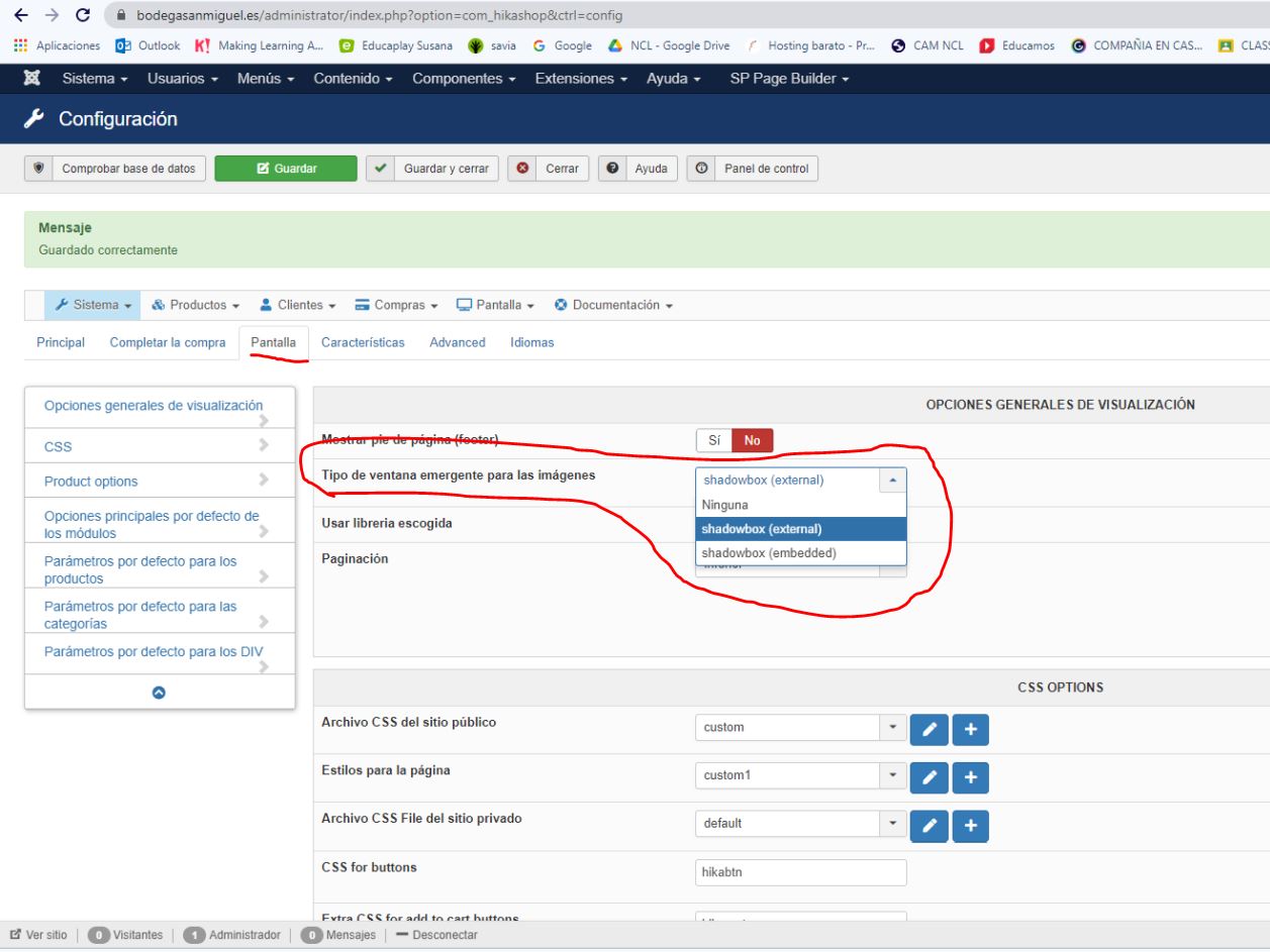

  • Posts: 22
5 years 2 months ago #333620
Hi Philip:
There is no option swipebox or mootools in that menu (see image attached) in my Hikashop version Starter 4.4.2 and this is the latest Hikashop version available.

  • Posts: 86094
  • Thank you received: 14197
5 years 2 months ago #333649
I've read the whole thread, and I can see Philippe had missed that you were talking about the variant thumbnails in "list" display mode in your first message.
I thought it was about the normal thumbnails display system on the product page.
So I checked the situation there and there is indeed a problem there.
Edit the file show_block_characteristic via the menu Display>Views and change the line:
echo $this->image->display($image->file_path, true, $image->file_name, 'style="margin-top:10px;margin-bottom:10px;display:inline-block;vertical-align:middle"', '', $width, $height);
by the code:
if($this->image->override) {
						echo $this->image->display(@$image->file_path, true, @$image->file_name, 'style="margin-top:10px;margin-bottom:10px;display:inline-block;vertical-align:middle"','', $width, $height);
					} else {
						if(empty($this->popup))
							$this->popup = hikashop_get('helper.popup');
						$image_options = array('default' => true,'forcesize'=>$this->config->get('image_force_size',true),'scale'=>$this->config->get('image_scale_mode','inside'));
						$img = $this->image->getThumbnail(@$image->file_path, array('width' => $width, 'height' => $height), $image_options);
						if(@$img->success) {
							$attributes = 'style="margin-top:10px;margin-bottom:10px;display:inline-block;vertical-align:middle"';
							if($img->external && $img->req_width && $img->req_height)
								$attributes .= ' width="'.$img->req_width.'" height="'.$img->req_height.'"';
							$html = '<img '.$attributes.' title="'.$this->escape(@$image->file_description).'" alt="'.$this->escape(@$image->file_name).'" src="'.$img->url.'"/>';
							if($this->config->get('add_webp_images', 1) && function_exists('imagewebp') && !empty($img->webpurl)) {
								$html = '
								<picture>
									<source srcset="'.$img->webpurl.'" type="image/webp">
									<source srcset="'.$img->url.'" type="image/'.$img->ext.'">
									'.$html.'
								</picture>
							echo $this->popup->image($html, $img->origin_url, null, 'title="'.$this->escape(@$image->file_description).'"');
Then, it will work. We'll add that change on our end for the next version of HikaShop.

5 years 2 months ago #333688
You say that the line does not exist there but I can see it in the file you attached in your message:
i.imgur.com/qLUktQZ.png
  • Posts: 22
5 years 2 months ago #333703
Hi Nicolas:
Oh my God !!! I must be asleep!!!
Changed the code and it works !!
Thanks Nicolas.
