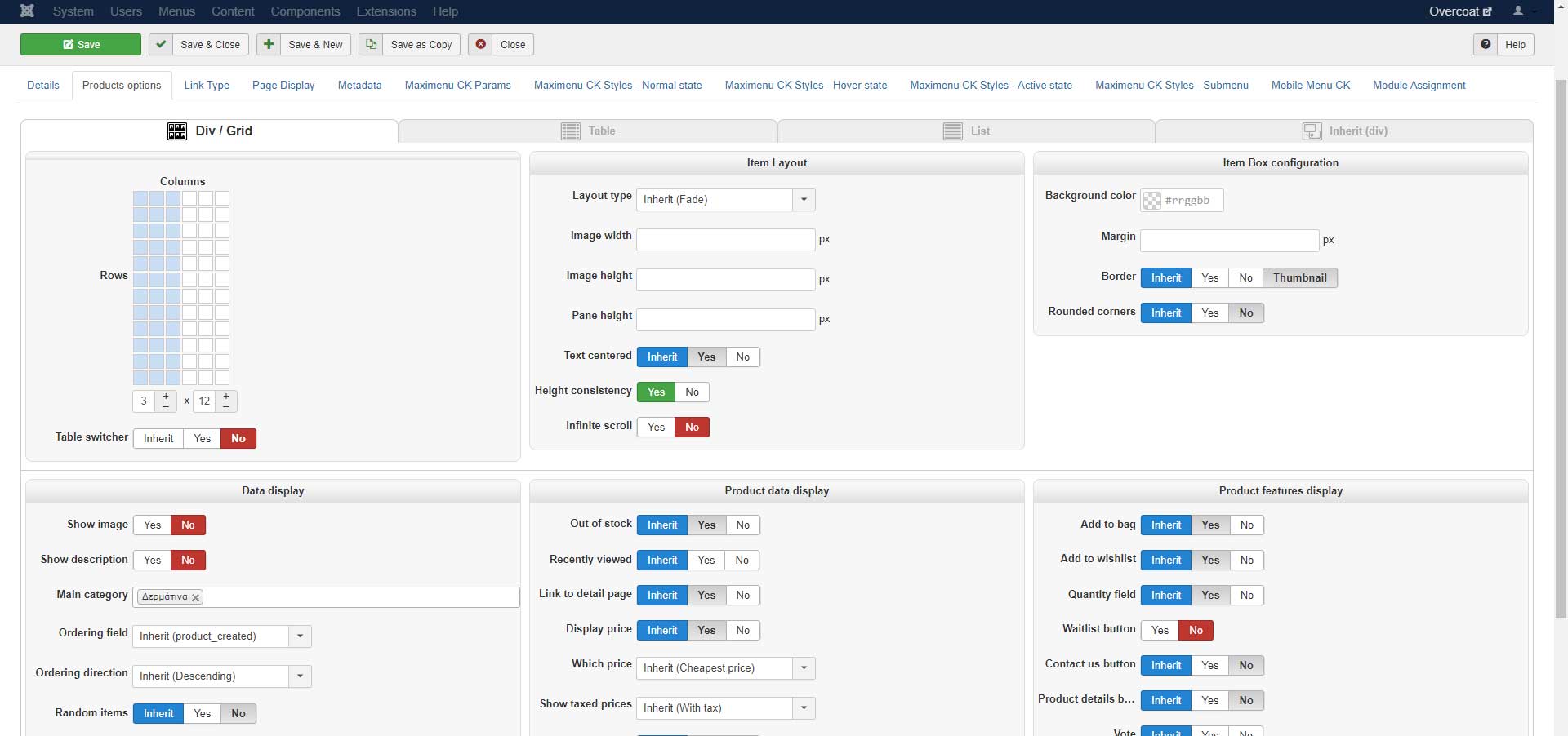

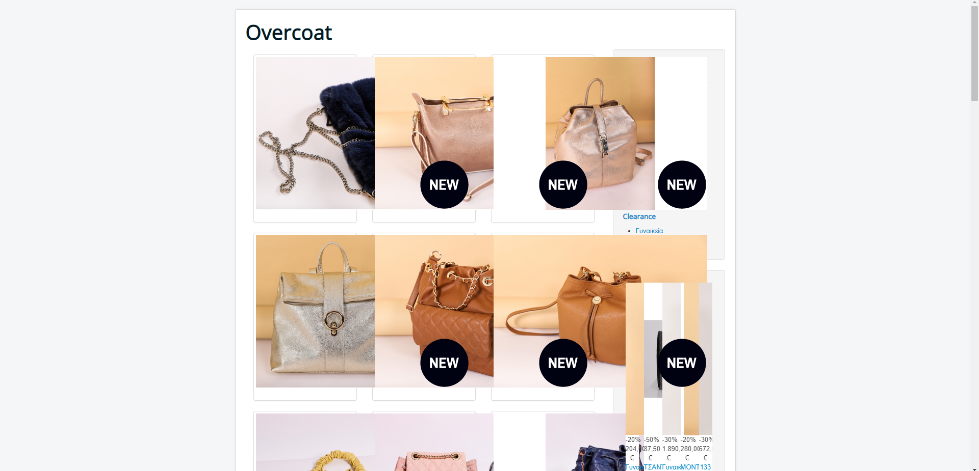

The layout in a Products listing page that has the same options with every other Product listing page is a mess and i cannot figure out the reason!
Thank you
  • Posts: 86094
  • Thank you received: 14197
5 years 2 months ago #333633
The issue comes from the width of the thumbnails you've configured under the "products options" tab of your menu item.
You've set a width of 419px instead of 214px on a page like /shop/gynaikeia/derma
However, 419px of width is bigger than the width available for each product based on the width of you template's main area, the sidebar, and the number of columns of your products listing. This leads to the thumbnails going over their product box into the product box on their right side.

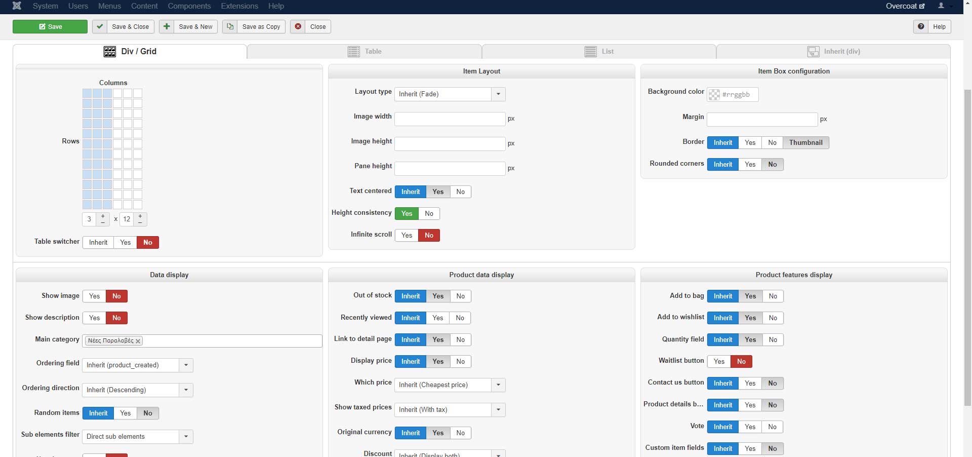

Hi!
I have not set width in either menu item, they all have the same options that's what i don't understand.

Well, I don't know. What I can say though is that if you don't set any size for the thumbnails, then it uses the default one from the HikaShop configuration.
So if you have an issue with the size of the thumbnails on a menu item, make sure you fill in the thumbnail size setting of the menu item so that you're sure it's using the size you want there and it should help.

I cannot figure out the problem. If i disable the first 9 products of the category (their images are square), the layout is fixed.
But it doesn't make any sense to me. The options are the same everywhere there is nothing different in that category.

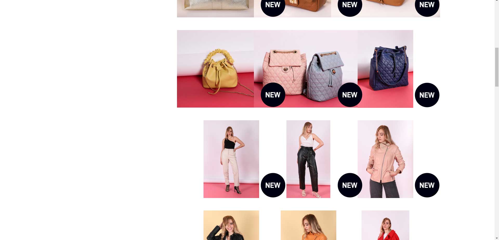

5 years 2 months ago #334019
Sorry for this return but I did not manage to make really significant progress because I was unable to switch off your current template, for a default one, like ProtoStar, but I don't think that this come from your Template.
The other thing I try to process, is remove in your Main HikaShop Configuration, from Main tab and in Image part, I try to remove the "Thumbnail (width x height)", it's slightly better, see my screenshot :
As you can see the only issue that remains is for image that are higher than they are wide, for this the best solution will be to use the same height and width for each images, it's the best and quick solution in your case.
And as your first 9 images have different proportions, that may explain your current issue, and why these picture "break" the structure.
Hope this will help you to solve your current issue.
regards

5 years 2 months ago #334116
I have maybe your solution, see my screenshot :
I have set a width for your image directly in the relative Item Menu, but as previously said, your image have different proportions, from this that can't be magic, and of course stretch the image isn't a solution.
The best way is to have all your image with the same proportions in order to have a consistent display.
Hope this will fit your needs.
