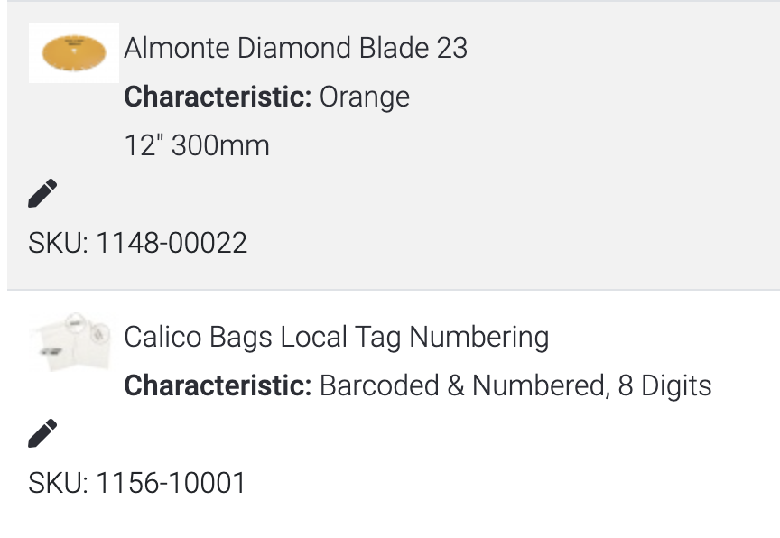

  • Posts: 58
4 years 11 months ago #335644
Hello Nicolas
Yes, I can see what you mean!!! I changed it for one product (we have over 3000) to check it out and it solved the problem. This is how it looks like in the cart.
Is there a possibility to (I am lighting it for reference as bold Characteristics) to show the label of the value as well which could be f.e. Color, Cover, Size etc. so it would look like:
Colour: Orange
Also when the products in the cart are listed on the checkout the SKU (order code) is displayed nicely with the rest, see example

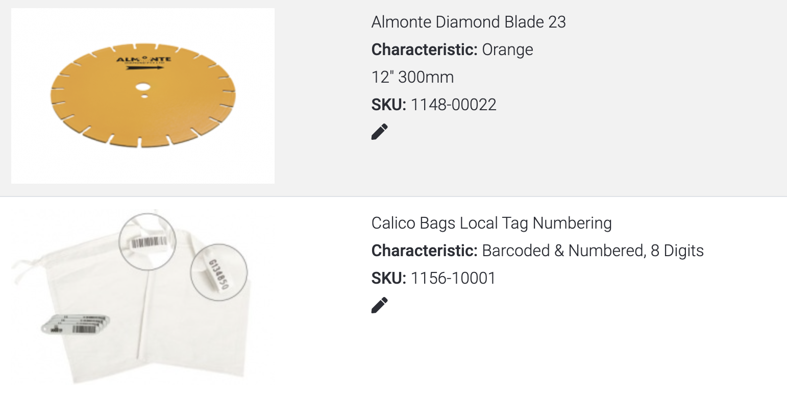

  • Posts: 86094
  • Thank you received: 14197
4 years 11 months ago #335655
There is no easy option to add the label. We figured that it would make it too much there, especially since that text is also used for the email notifications where the width is less important, and also when passing the name of the products to payment gateways, they often restrict the number of characters so you want the name to be as small as possible. And since it's the same code generating the name with the selected characteristics appended to it, we figured it would be better to not include the label.
Changing the order of the code to have the SKU before the edit button should be possible without too much difficulty.
You need to edit the view file checkout / show_block_cart.php via the menu Display>Views and move a bit the code displaying the "product_code".
Normally, by default the product_code is directly after the product name:
i.imgur.com/OM7aits.png
And thus it's already by default before the edit icon.
So I suppose that your template already has a customization of checkout / show_block_cart.php and thus I'm not sure what exact modification should be done.

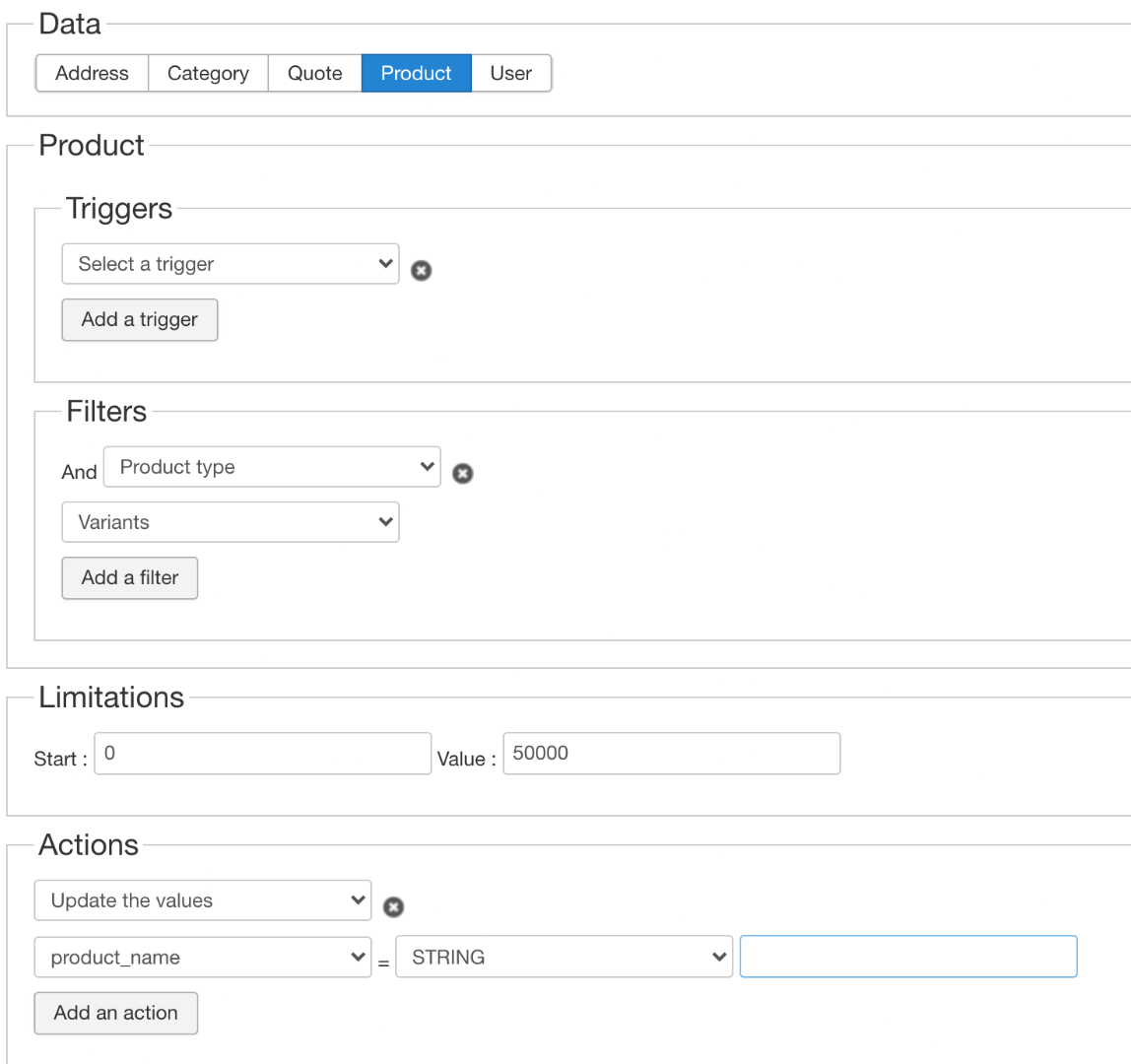

  • Posts: 86094
4 years 11 months ago #336038
You can create, via the menu System>Mass action, a mass action with a filter on the "product type" being "variant" and an action "update the values" on the "product_name" column with the type "string" and the input field being empty. When you run the mass action, it will clear the product name of all the variants at once. And when the product name is empty, for a variant, the system will dynamically generate it based on the values of the characteristics of the variant.
  • Posts: 58
4 years 10 months ago #336080
Thank you very much. I set it up and run it but it does not seem to clear the names in the variants:
  • Posts: 86094
4 years 10 months ago #336082
This looks ok. Note that this mass action will only clear the name of the first 50 000 variants it finds. So if you have several hundred of thousands or millions of them, you would have to run the mass action several times, each time changing the "start" value and increasing by 50 000.
Also, what happen when you run the mass action ? Do you get an error ? Or a successful message ?
