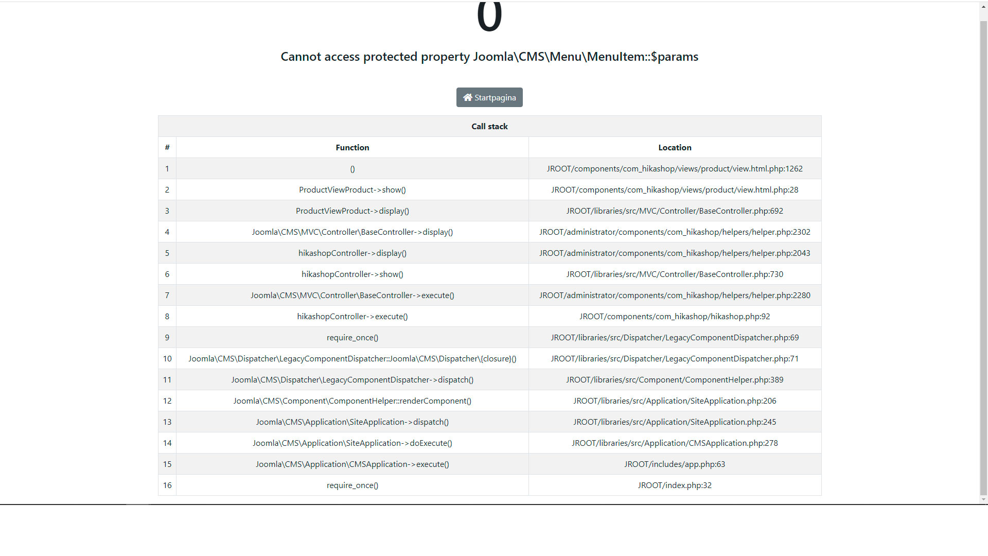

I'm testing with Joomla 4 to be ready to upgrade as soon as everything's stable. Hikashop is doing well but I encountered an error when using canonical url's for products/categories. The error code is: Cannot access protected property Joomla\CMS\Menu\MenuItem::$params

4 years 11 months ago #334316
No problem, here's the screenshot

Thanks.
It looks to be something linked to the fact your using Joomla 4 and PHP7.4.
Change the code:
jimport('joomla.html.parameter');
			$category_params = new HikaParameter($menu->params);
to:
if(HIKASHOP_J30) {
				$category_params = $menu->getParams();
			} else {
in the file components/com_hikashop/views/product/view.html.php
That should hopefully fix the problem.
Let us know how it goes so that we can include the modification on our end.
