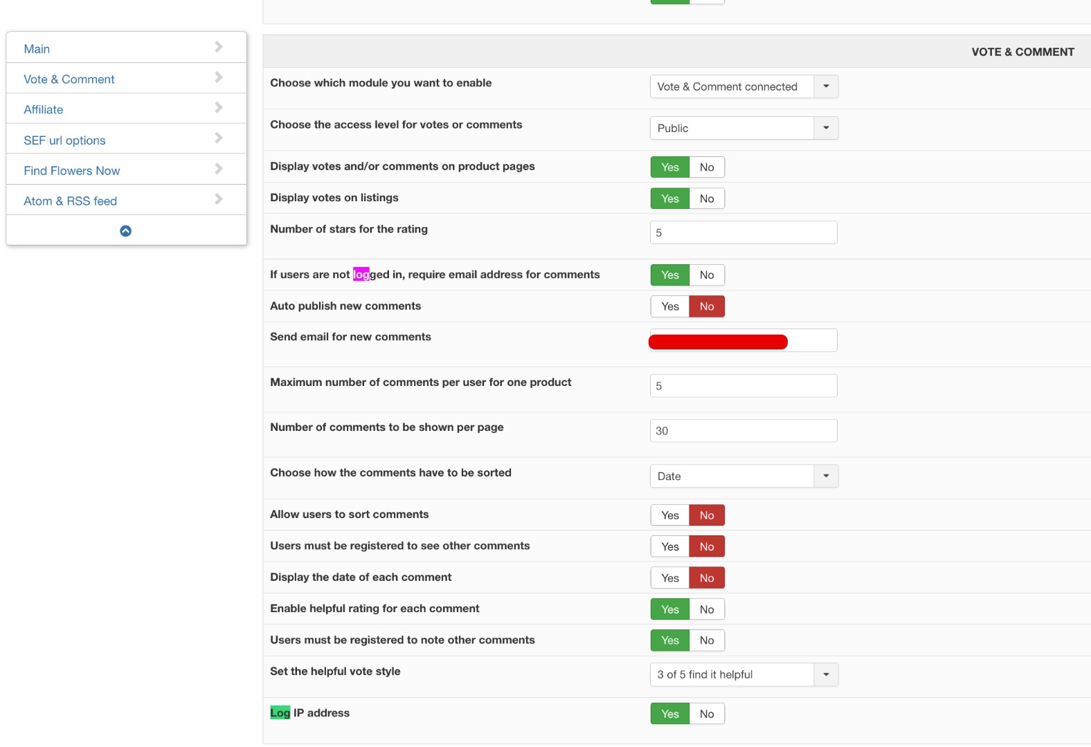

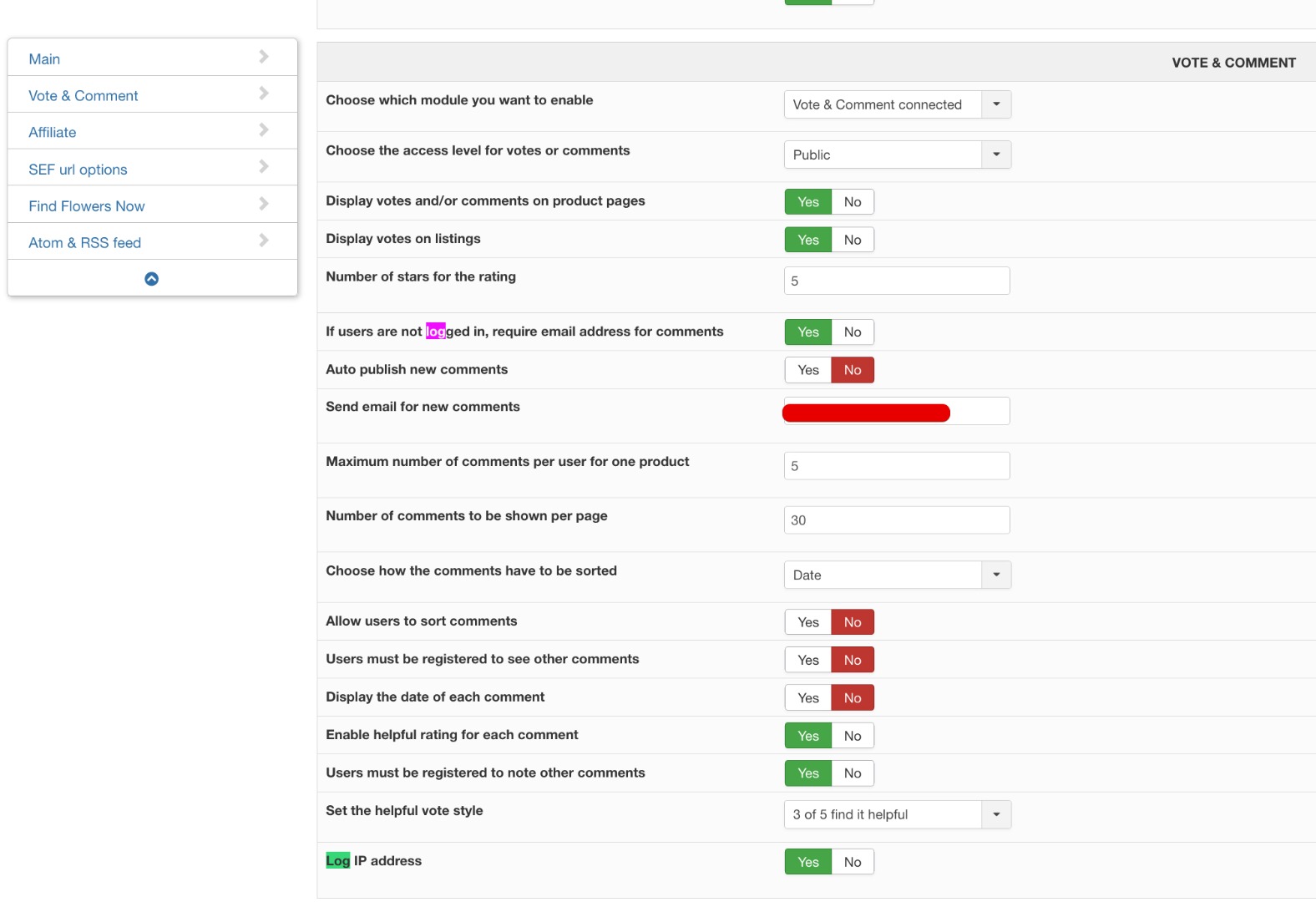

Can you provide a screenshot (like mine) of your configuration Vote & Comment part :
We guess that here there are several points to check and your configuration is maybe the key.
Awaiting your elements to progress
Last edit: 4 years 10 months ago by Philip.
  • Posts: 490
4 years 10 months ago #335343
hi
here you go
  • Posts: 85796
